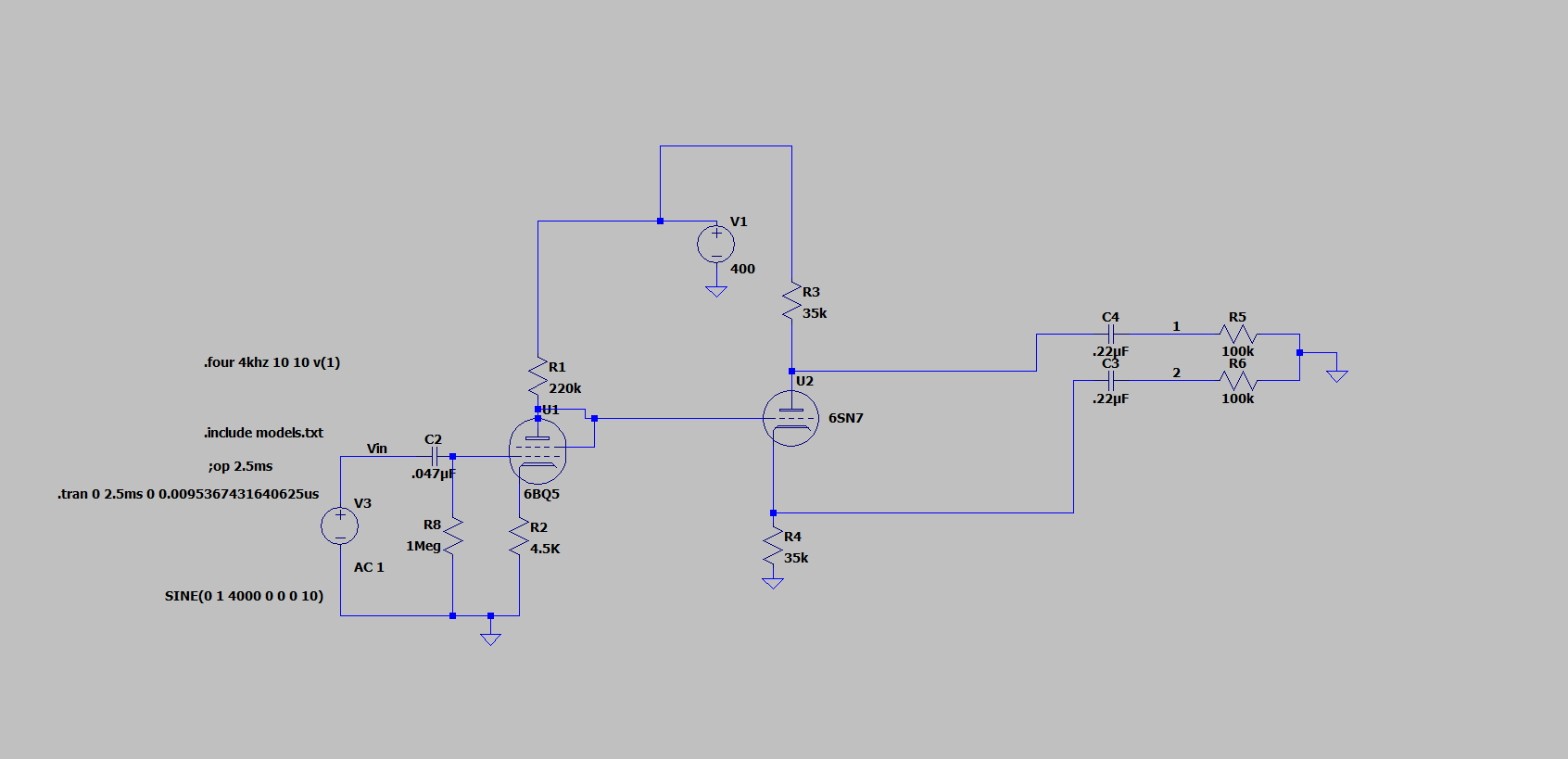

So I was playing around in LTspice (still a newbie with this program), mostly just experimenting, and this design does seem to measure quite well. Around .14% distortion at 100V P-P output (Around 35V RMS). At 60V P-P, it has .05% distortion.
The catch is, the 6BQ5 is operating at about 1.3 mA. The 6SN7 is operating at 3.5 mA. 1.3mA is tiny for a 6BQ5, and it has a much higher plate resistor than I could have possibly expected to perform well.
Just out of curiosity, does this seem like an ill-advised design? I believe that it can swing enough voltage to drive a 6L6 to full power, and it doesn't have a huge amount of gain, only about 11. IMO, this is a good thing.
I'm very interested to hear about how realistic the simulated performance is, in this case, and if it would just be too vulnerable to noise issues. After all, the 6BQ5 wasn't exactly designed as a preamp tube.
Thanks for the feedback on this kind of thing, I'm trying to continue learning what I can about this stuff even though I won't be able to actually build much until winter break when I come home. At the time being, LTspice is where this is at. Attached is an image of the design, the LTspice schematic and the necessary models file.

I would not trust the SPICE model at current SO far below normal operating zone.
It will work, but probably not the same as SPICE thinks.
You could, as said, run the 6BQ5 at much higher current. When driving a *load*, this is often better. But the cathodyne is nearly no load at all.
You can buy MUCH cheaper triodes than 6BQ5; why use that?
The challenge here may be my requirement. I would like this to have a gain of around 10 or 15, and still be able to swing somewhere around 40 volts RMS, enough to drive a 6L6 properly.

Of course it will.
I've used 6BQ5 (6P14P, actually) and 6P15P as triode-connected drivers before, and found that it wasn't worth the extra heater power, but the 6P15P made a better driver tube, lower THD at 100 volt signal output. The same can be done easily with a 6SN7 with comparable or lower distortion, given adequate supply voltage.
Are you going to have 4v of input signal to it?
This amp will be paired with a poorly-planned preamp project from this spring. I was a moron who did not listen to opinions from numerous prominent members here, and it has a bit too much gain for most amps. It can happily swing 4 volts.

Yes, _IF_ the next stage load is 0.10Meg. However you are driving a cathodyne? The input is typically much higher, Meg or more. On this chart you drop to lines with high "Rs". p=0.24M Rs=0.51M offers 54Vrms output.
(The zero-bias lines, Rg1=10Meg, offer even more. This suggests the Rk values are not fully optimized FOR output, and a smaller Rk may gain more output.)
Also look across 90V 180V 300V. Max output rises with supply, nearly linearly. You can scale-up above 500V, more output, or lower THD for the same output.
...5% distortion, which is a lot more than I'd like. I'd really like to be down below 1% if possible....
40Vrms to swing a 6L6 does not sound right, unless you are setting G2 near 1000V. For 300V G2, bias should be near -18V, so peak swing is 18V, or 13V RMS.
You can't always get all you want.
Consider: a perfect device, resistor feed, no load, 300V, can swing 300V/2.828 or 106V RMS. 6SN7 has significant internal resistance and can not swing so far.
To get that 106V swing the device current must go from some maximum down to ZERO. But device transconductance always varies with current (to zero at zero current). BJT Gm varies directly as current, and just below clipping (an ill-defined thing in such a hard-driven stage) the THD gets to 26%. Tubes in their "normal" zone have Gm about as square-root of current, so make about 5% THD, though at a lesser (relative to supply) clipping point.
With typical loading, a tube will make a Peak swing about 20% of supply. (Check: 6SN7 will make 40V-51V RMS or 56V-71V peak from 300V: peak near 19%-24% of supply.) And will be around 5% at this point.
THD will drop roughly linear with output. If 5%THD @ 51Vpeak, under 2% at 18V peak.
All of this is not new news.
Topology is one answer. While I think your gain-cathodyne is the best plan for your needs, you could do a long-tail for about the same parts. The single-ended stages (well biased) make 2nd-order distortion. A push-pull driver first-order *cancels* all this.
Back in the 1930s several guys developed Negative Feedback to cause an amplifier to self-correct its own output. Excess gain is much easier to find than massive clean output. Build a not-too-dirty amplifier, with excess gain, and let it clean itself up. In this case I would turn to 12AX7, gain of 50, 15X more than needed. That would cut 2% in driver down to 0.2%, or 5% total down to under a half %. It also damps your speaker-- the 6L6 was a hard-sell at first because it didn't damp loudspeakers like the triodes did.
