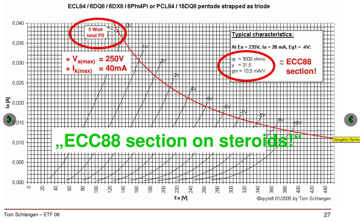

Triode connected pentode close to ECC88?

Another option for NOS equivalents is to look for PCC88, and work with the slight heater voltage difference. They are appreciating in value but still can be had reasonably.
Yes, the pentode section of
ECL84 / PCL84 / 6DQ8 /6DX8 / 15DQ8 / 6F4P / 6Ф4П

I didn't propose the EF 184 because its mu g2g1 is 60 which too different from the ECC 88 mu (33). The EF 183 mug2g1 (40) is much closer and apart from that its gm (12,5 ma/v) is identical to that of the 88. I purposely didn't suggest any other triodes because that's not what the op asked for.
