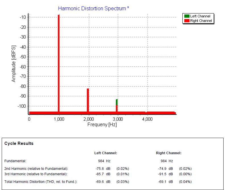

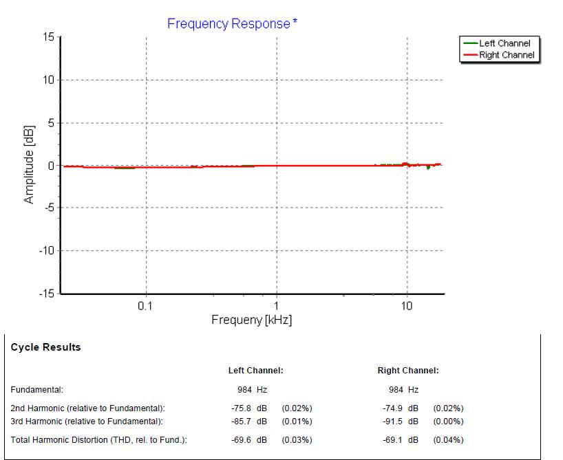

Results so far for the DAC + Tubes Channels build with "free assembly" not noise-free or matched parts yet:
What test equipment did you use to make those measurements?Results so far for the DAC + Tubes Channels build with "free assembly" not noise-free or matched parts yet:
Cheers
ian
Fancy, isn't it? 😀
Well, the actual measurements were done with regular equipment as a scope and a HP THD meter. The software you see I usually use for Azimuth alignment of my cartridge and I figured that if it had THD measurement and F-sweep...I could also use it for measuring the tube-stage+DAC...software is called Adjust+ by Dr. Chris Feickert...highly recommended!
