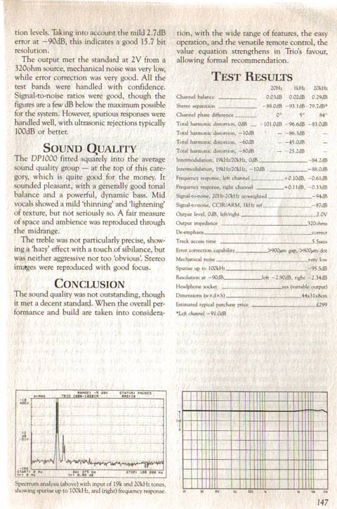

Remote Control
Thanks for the nice article. However the review made me more hungry for a remote control

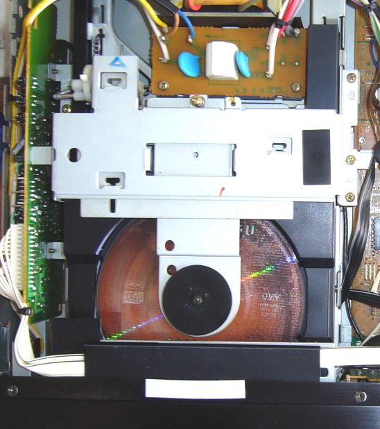

Could You write more about fixing this problem? I have DP 1000 and similar problem.the only fault is a sticking loading draw.
A quick look-see inside reveals what appears to be a stretched belt and a need for lube on the loading mech.
f.
What happens is that the tray loading motor belt stretches and then the magnetic clamp is not pulled off the spindle that the disc sits on.
If a disc is left in the player then this problem is only noticed when the tray is closed with no disc in at which point the draw refuses to open.
Just fitting a new belt completely fixed mine and that was nearly 3 years ago.
I still use this player occasionally now!
Still plays everything including cdr's and has never mistracked anything, not bad for 27 years of age, I love it!
