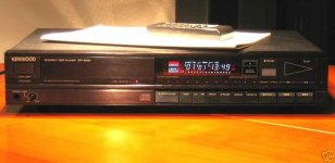

I've just bought one of these and it's in really great condition and the only fault is a sticking loading draw.
A quick look-see inside reveals what appears to be a stretched belt and a need for lube on the loading mech.
Plays fine, including cdr's and seems to be composed of Sony d/a conversion and that's about as much as I can tell.
So, does anybody have any info on this player?

Seems there's no experience of this player on here and nothing on the net at all about it anywhere I can find, so it's going to be hard work finding out anything more about it other than what I find inside!
The sticking draw was any easy fix, clean the belt and pulleys, refit the belt and added an elastic band just the right size and Bob' s your uncle!
From what I can tell D/A conversion is in the hands of a single Sony chip that is multi-plexed between the channels with a sample and hold circuit to bring the channels back into phase.
