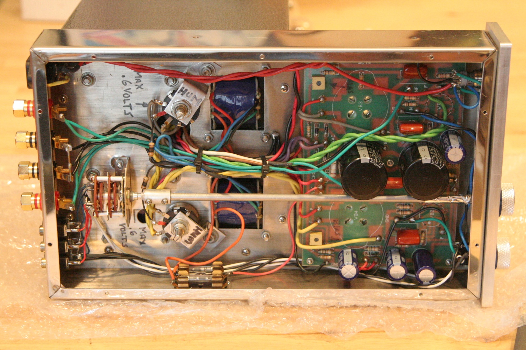

Can someone confirm if TRI CORP of Japan ever made this model 300b?
I can't find any info on this amp, this particular model have 12ax7 as drivers.
I am not sure if this is a knockoff version or an earlier model.

OTOH the build quality looks quite decent for a budget unit. I have seen much, much, much worse. I do however see two very scorched resistors connected to the hum pots that would be replaced. I think you may be able to make out the values still. I would replace with at least 2W rated resistor.

My conclusion after seeing the gut I don't think it's from Tri corp
I'm not aware of any company in Japan or elsewhere that uses the name "TRI" there is a Triode Corp of Japan which is an entirely different company.
This is just one of many products made in China that has an English name on it that might or might not have significance to the namer. The Chinese at times have managed to come up with some fairly hilarious names for products that often were inspired by others.
This amplifier strikes me as nothing more than a reasonably well made boutique product from a small Chinese manufacturer. It does not appear to me to be a clone or misrepresentation in any sense. And it looks competently put together. Things are a bit close together than I would like and obviously transformer quality is a mystery - some Chinese transformers it should be noted are VERY good, others not.

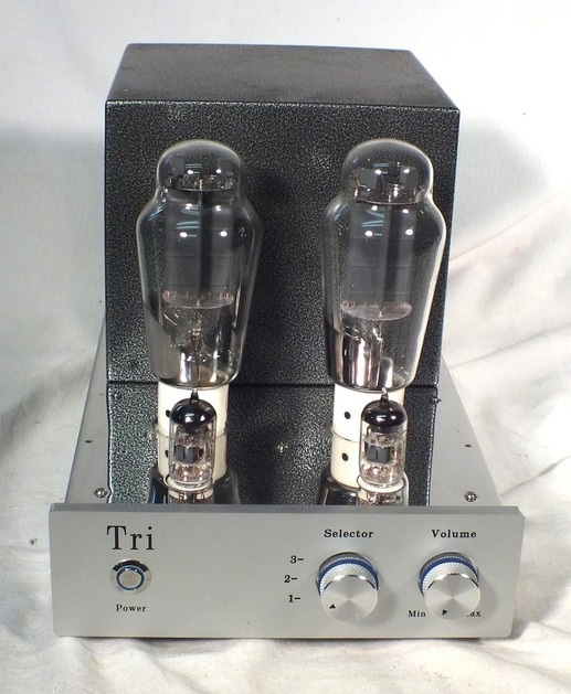

I don't mean to drag anything through mud, just wanted to see if this was a "Trio corp" made amp like the seller was advertising.
I am familiar with Trio corp of Japan as you can see the Tri on the front facia are the same except the stripe.

This is a from a few years ago and is an early model right before the current TRV-A300SE. Similar three input integrated with brand new JJ 300b tubes.
Sounds great, can't think of anything this price that will give you so much beautiful SET sound and flexibility. Looks great, too. Chrome is very nice and shiny. No real marks that I can see, just slight signs of use.
