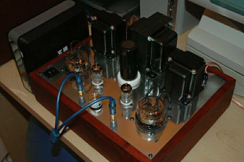

Heres some photos to get you started.
Not exactly a scratch build, but an Asymetrical approach to a nice looking stereo SE amp that was made with what I had to work with from an old Magnavox.
Here is my own chassis design for a Dynaco ST35 clone.
I used a hammond 12x10x2 aluminum chassis and polished it using metal polish available at Lowes hardware. I used cheap 1x2 oak craft strips from Lowes for the casing at a total cost of $3.50. The control knobs for both are $1.75 at radio shack, and look quite professional and "hifi" IMHO. I like to do things on a budjet, so thats my take on things. Hope you're inspired!

That's aluminum?!! Got the name of that polish? Got no Lowes near me but maybe I can get polish at a similar store. Very nice work, SpeakerDude. Boutique looks on a budget - I love it.

Beautiful work! I notice that you didn't show the guts though.😉

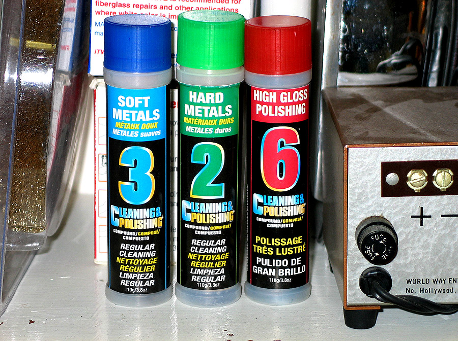

http://www.charlestonarea.com/octane/2-9-2006/polishing_compound.jpg
there is the stuff I used, I don't know if theres a name brand but it is made in the USA. You can find it in the tool section of Lowes. I only used the high gloss stuff so it took a while to polish it up. Its basically a claybar that removes aluminum and smooths it out while polishing at the same time. Messy and you must use a buffer or drill with a small buffing wheel.
Thanks dubdub, that was the magnavox shield off of the radio that the amp came out of. Thought it gave it that "botique-im some-high-falutin'-fancy-brand-transformer" type of look 😉
FWIW, the transformers are made by Stancor as indicated by the 138 IEA code on them.
