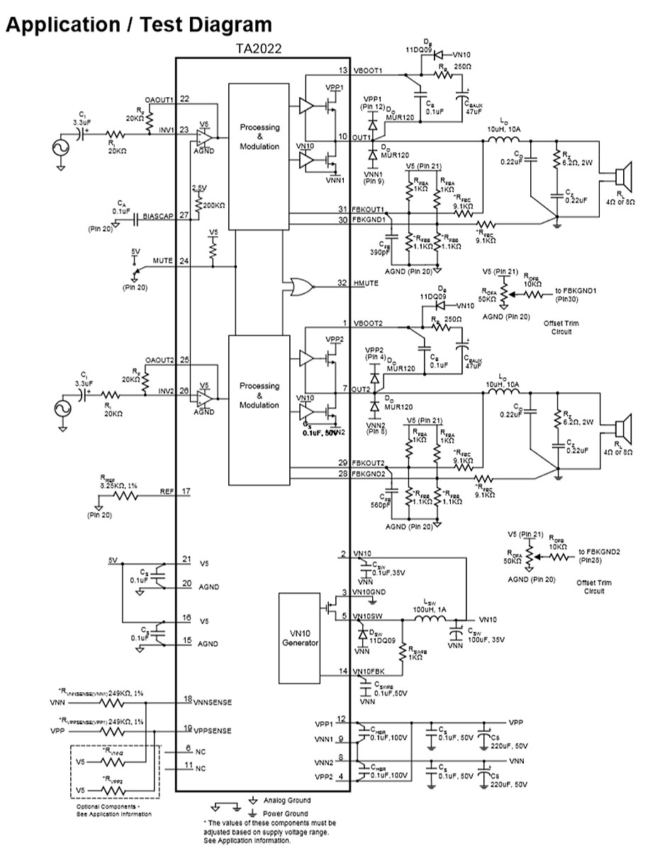

Anyway, I figured it might be better to use a DC-servo for "offset trimming" then to try to get it as close to zero as possible with the trimpots.
The TA2022 evaluationboard used DC-servo IIRC.
I have a design of an OPA2134 DC-servo that works very well in simulations.
Granted I have not done simulations with the TA2022 as I don't have the LTspice model. Simulations was made on other circuits I am working on.
Now, at long last, to my question:
How to "convert" LJM TA2022 boards to use DC-servos instead of the two 50K trimpots?
What to remove/add, where to hook up in/out of the DC-servo etc.
I don't have a schematic of this particular board unfortunately.

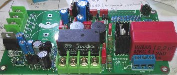

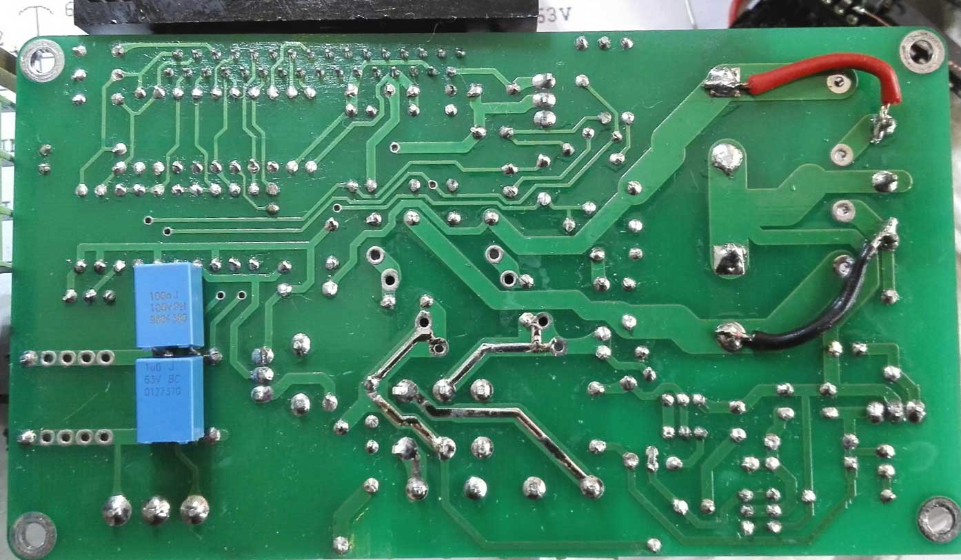

The attached pics are from when I populated the board. Please excuse quality of the pics and that the flux was not cleaned off.

The resistor between viper and FBKGND's seem to be 5K7 (from the colorcode).
The datasheet suggests a 10K resistor in that spot.
The trimpots connects to V5, FBKGND and AGND according to the datasheet suggested schematic(attached).
I've ordered the parts I didn't have at home to make DC-servo's as per the EV board schematic.
Should be able to figure where and how to hook that circuit to the TA2022 board from reading the schematic and measuring the boards.
