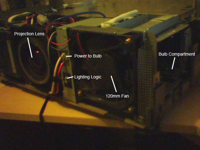

any have a clue as to what to look for and how to trick a commercial projector in to thinking its got a bulb in it??..i want to make my own lighting system for it...
Be very careful when playing around with the lighting system, there's some very high voltages floating around that you really don't want to be shocking yourself with!
I've attached a picture to help describe what I did on a Panasonic PT-L592EG. (apologies for the low quality, I just took it quickly with my phone).
First off disconnect the bulbs power and logic wires, taking the PJ to bits further than this (I removed the bulb compartment and fan to get at it) revealed that they were the wires I wanted.
The lighting logic connector had 3 pins, top was ground, middle was +5v and bottom was the bulb detection feedback. Shorting the detection pin to ground tricked the rest of the PJ into thinking it had a bulb.
Clearly another make / model of projector may be completely different to this but that should be the sort of thing you're looking for. Also the logic may be different, for example yours may need 5V instead of ground...

ya its kinda hard to see in that pic..but its ok i think i understand..i took mine apart and found 2 power systems..one for the mainboard,lcd..etc and another on top that i can remove completeley is the ballast for the bulb...the only two cords going to the ballast are a set of thick wires from what seems to be the main psu..and a set of 4 thinner ones that run to the main board....i think i have to short one of these 4....here is a pic...what do you think?
http://img418.imageshack.us/my.php?image=wire22tv.jpg
in that pic is a switch on the left..i shorted that wire...doing so made the projector turn on fully (before it would have power but no fans would work or anything) now the fans work but it still is looking for a bulb..
It's hard to tell from that picture but it looks like you're in the right area. Are there any markings on the PCB at both ends of the cable?

elstcb said:It's hard to tell from that picture but it looks like you're in the right area. Are there any markings on the PCB at both ends of the cable?
only thing i can see is JP2 at the ballast end...cant see anything on the mainboard end..
I'll try and take a close up of my board with a better camera when I get home tonight to see if that helps you.
As long as you're only dealing with logic wires then you shouldn't do any damage if you get the wrong wires - you can test the voltages with a multimeter if you need to in order to check you have 5v. If you're in any doubt at all then use a resistor to join them as that will limit the current (you should probably do this in the long run anyway but for testing over short periods it's not essential).
