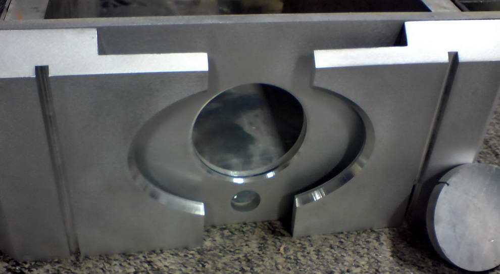

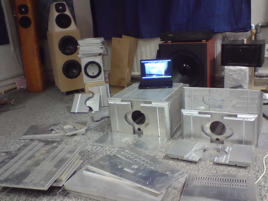

so since then i decided to build 90% or so clone of thees ams, as speakers tooked most of my time, only now I was able to start this. today I bringed to studio aluminium parts for speakers and papas amps, it weighted 740kg only excruded aluminium. 😀
they seems dusty and not well done on photos but everythuing is cuted at 0.2mm , there was not posible cut on cnc or laser because some parts was 40 mm ,there was used cut with watter,sand and high pressure computer programable big industrial equipment.
I asked one person for drawings(he done something similar) but did not get answers so everything started from zero. it took a tons of time and lot of photos of variuos angles to draw in archicad exact proportion of pass xa 160 and xa100 , the only diference is on heatsinks and front panel exterior parts(I did from 25mm, while original was made from 20mm I believe) it looks even more hefty
heastinks base is hefty 40mm each monoblock,

i have noit realized how expensive is to make theese beasts.
I spended nearly 5000usd on aluminium, and more than 2000usd for cuting servises and it still half job done- parts need be brushed , cuted edges anozided white and black . I still have big head pain to design an make original look like ampermetres, I wish papa could sell some I think I will cost less than to manufacture by small qty'ies

here is some photos.
actualy aluminium is not very heavy comparing to cooper, brass or lead but still its heavy. as for aplifiers its not very heavy- I believe one empty not stufed monoblock is somewhere arround 35- 45kg what is heavy is speakers enclosures (not here in photo,only one small midrange module could be seen) )
for my opnion aluminium speakers eclosure 15-20mm thickness with some extra damping are almost free of any box coloration in basicaly any spl level. at least comparing with the same thickness mdf they are 30-40db quiter in 100-700hz range.

I weighted xa160 empty weights 42kg and xa100 weights even more 4kg 😀 (i quess its because on xa100 i decided to use 40mm heatsink base) I quess i am litle bit overdone with front panel pads- front panel is from 15mm and panel pads machined from 26mm. orginals I quess use 14-16mm for front panel and 18-20mm for panel pads.
i believe xa100 will handle the same or even more heat than xa160.
ataching picture of todays work.
