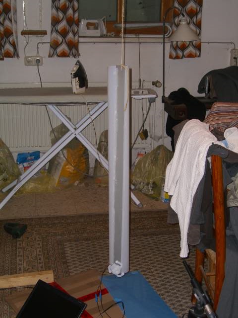

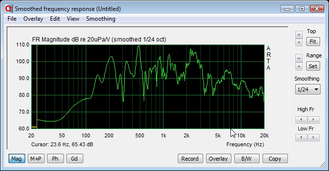

My personal interpretation of a planot:
A tube made of a 5 cm stripe of fiber glass and a 25 cm stripe of acrylate, both 0.5 mm, excited frrom the bottom (exciter at the fiber glass part).
Treble performance is very bad. lower midrange / upper bass is there and performing quite OK. No one-note tube sound as one might expect. For someone who knows how to deal with modal behaviour like Oliver Mertineit or the guys from NXT it might be possible to design a working product.

Great to see measurements, but I fail to see the resemblance to Planot. Yours looks more like a Linaeum/ Rubanoide meets half-wave resonator.
Why should the planot be different? The wave front "forgets" very soon how exactly the excitation looked like.
