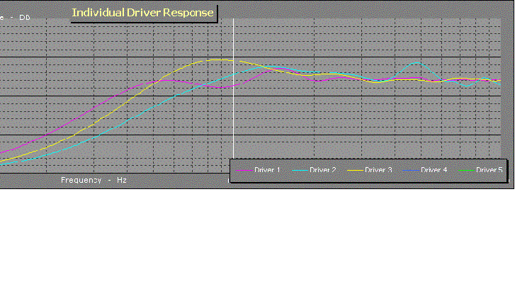

There's a nice piece of software from FRD Consortium which will allow you to predict the effect of the triangular baffle on frequency response.
Oh, and Skinny's physics teacher made that comment about bass; I'd recommend that the school board fire that teacher for being as incompetent as my physics teachers were. It pains me to see how bad science education is in this country, and the number one reason is that teachers spend too much time learning pedagogy and feel-good subjects and not enough time studying the subject that they'll be teaching.
OK. That's a super program. As far as I can tell, this shape of a baffle, a 21" equilateral triangle, produces a fairly flat response with the 6 1/2" driver (or vice versa), depending on where I place it.
The only thing I don't understand about the inputs is the "Edge Size" variable. It's never explained in the companion Word document. I don't know what it means and I don't know what unit the number represents.
At any rate, I'm having too much fun with an Excel spreadsheet.
Or, I could be reading the thing completely wrong.
Oh well.
Dave
I managed to model a design, then graph the response.
purple=6 1/2"
yellow=5"
blue=1" dome
any comments?
Dave

A question and a couple of thoughts:
What type of music do you like, (or how much bass do you desire)?
If you like full bass, you will probably not be satisfied with a 0.3 ft*3 box regardless of its shape and driver chosen.
On the other hand, if you built a 16"(w) by 16" (d) by whatever height you need bass (sub) cabinet to go under this, your bass problems would be solved, and the upper cabinet would be closer to ear level for better imaging. Small children and pets would also be less likely to impale themselves. Beer and candles still could not be placed on top. A bass cabinet is a good first diy project. Perhaps the easiest way to power/integrate this would be to get something like this: http://www.partsexpress.com/pe/pshowdetl.cfm?&DID=7&Partnumber=300-792.
The project cost would at least double (sorry) from $200.
For the upper cabinet, I would look around the net for free diy kit designs appropriate for your cabinet size, published by the amazing people who know how to design and measure crossovers (this is not at all easy, and requires lots of time and knowledge), and share this knowledge with the masses.
