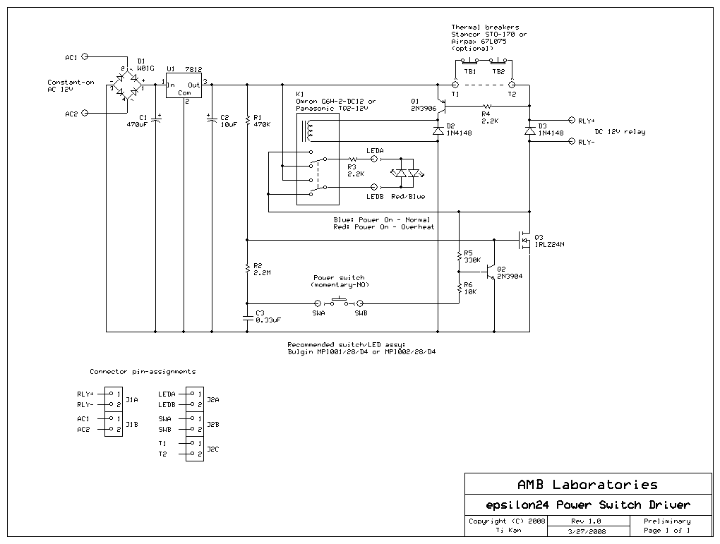

I wanted to make a Triac switch control for a power amp build and would like to know if my thinking is correct and whether it's a sensible idea. I understand some high end manufacturers are using Triac power control.

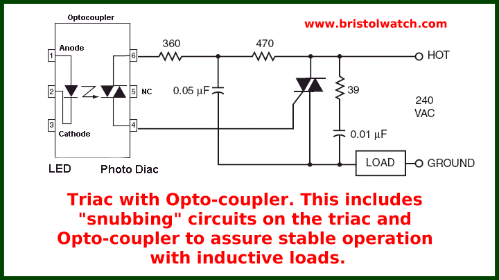

The Triac.gif schematic attached below was found online and it looked suitable for an amplifier inductive load. It shows an optocoupler triggering the triac via a DC switch.
I planned to use an AMB Power switch board (schem below) and trigger the optocoupler via the AMB board relay control circuit (All thermal cutout components will be omitted) The switch board is handy as it has PS supply and switched regulated output all in one.
- could someone help me choose the correct spec optocoupler and triac please. Will these do for a 250VA power supply 240V AC:
Optocoupler (250V, 50mA, No zero crossing): Vishay K3010P
Triac (400V, 15A 50-50-50mA): Littlefuse Q4015L5
- Can the optocoupler DC input be 5 - 12V range?
- Should there be a fuse or diode protection on the AC ground line to protect the Triac?
- The load can be on either the hot or ground lines?
- Will zero crossing optocouple provide a 'soft start' for this type of load, or not suitable?
Hope that's clear. Thanks

Your first circuit is not bad but place the load on the Hot feed and you MUST use a zero crossing triac if you want to switch an inductive load. A BTA08-600 is gate sensitive, (5mA) and tab is isolated for safety and ease of mounting.
Excellent, thank you Jon. I had presumed zero crossing was more for resistive loads that are sensitive to start surges.
BTA08-600 looks good thanks.

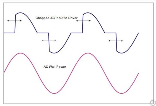

Mooly - I see that phase angle control looks very interesting, is something like this usable?
Is the initial impedance of the load a critical factor in whether to zero cross or not? A lot of reading is leaning me towards non zero crossing. I might experiment with both on a 120VA tranny.
The impedance of the load is 'fixed' when in normal use but becomes modified by the remnant magnetism in the core that is produced when you switch off. When you switch on again, that magnetism effects the initial surge current but after a few cycles its all back to normal again. Until the next time.
If you think of an ordinary mechanical switch, its pot luck where in the cycle switching occurs and the same applies for switching off. This means that on some occasions the switch on surge is massive and at other times its very small. Its random because you have no control over the switch on and switch off points.
Phase angle control as related to controlling the voltage wouldn't be suitable for a transformer because the shape of the waveform is horrific. Imagine applying that to large transformer.
This shows how it works and what the applied voltage would look like.

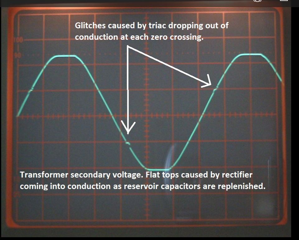

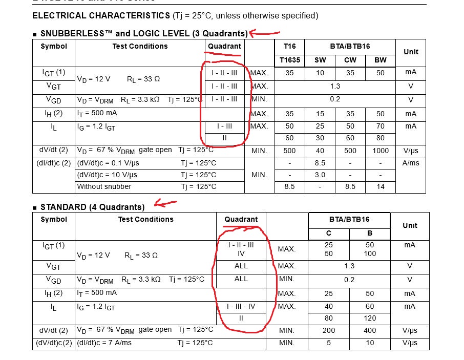

This shows a real glitch caused by using a triac that wasn't rated to fire in all four quadrants (something else to be aware of in choosing a triac) but I'm showing you this because that tiny glitch was enough to make the transformer (a 650 va toroid) very noisy. Not using a suitable triac was my mistake but it was instructive.
Ultimately all you are doing here is replacing a mechanical switch with electronic. The same surge issues still apply and any fuse has to be rated to deal with the worst case surge unless you include a soft start device such as a thermistor.

...............................This shows a real glitch caused by using a triac that wasn't rated to fire in all four quadrants (something else to be aware of in choosing a triac) but I'm showing you this because that tiny glitch was enough to make the transformer (a 650 va toroid) very noisy. Not using a suitable triac was my mistake but it was instructive.
View attachment 524918.................
How do we avoid this glitch?
