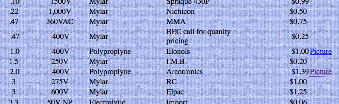

But if you wanted to get a tiny taste of DIY (and take advantage of the perfectly matched ~90dB/W sensitivities of mid-woofer and tweeter and the mid-woofer's nice top end roll-off), we could put a capacitor in front of that tweeter and make a simple first order (6dB/oct) xo.
Network Circuits
So with your 8 Ohm tweeter and aiming for about a 5-6kHz high pass, I would start with a 2uF film cap and experiment with values around 1.6-2.2uF....
Network Circuits

Look for the maximum AC voltage allowed in the datasheet.
It is usually quite different from the maximum (rated) DC voltage specified on the component.
2uF is a non preferred value (E24). Use more readily available E6 or E12 values.
If you choose carefully from the current selection of cheap film caps from Apex Jr, with f.ex. 0.22uF, 1.5uF, and 2.0uF, you can make 1.5uF, 1.72uF, 2.0uF, and 2.22uF. Give those combos a listen, and adjust to taste.
If you're in the US, I will even send you some Mylar 0.22uF, 0.42, 1.0, and 2.2 for nothing...
AndrewT's paranoia knows no bounds, bless his tiny heart! He'll be relieved to know the tweeter is wound with fuse wire that will protect the cap...Look for the maximum AC voltage allowed in the datasheet.

I'm disappointed in the error checking on this thread: Good thing I confirmed with a book and recalculated, as the cap value should be about 4.1uF for a ~5500Hz 6dB/oct xo for an 8 Ohm tweeter. Caps on their way!
