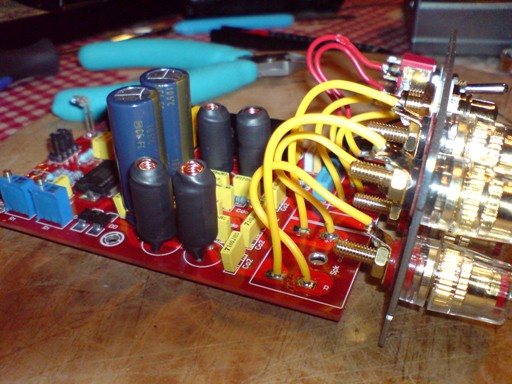

Rewiring and Cleaning Up TA-10
I finally got a chance to redo the wiring and clean-up the top and bottom side of the PCB. I was fortunate enough to find some 18 AWG tin copper Teflon wires at a local electronic surplus store and it even came in yellow like the original wires. They had no idea what they were selling to me cause Teflon wire is usually big$$$ !
Here is how my TA-10 amp looked like once it was opened. Notice the hideous soldering workmanship of the wiring. The jacket material is melted into the solder cups and terminals and there is no gap between the wire jacket and the soldering joints. Another thing I noticed was that there was barely any wire in the soldering cup and only 2-3mm that was tacked onto the cup. Another thing I noticed was that two different type of wires gauge was use, 20 AWG(orange) for the RCA jacks and 18 AWG(yellow) for the speaker jacks. The reason I found later on was the drill holes on the PCB can only accomandate 20AWG for the RCA jacks, a little too small for my liking as an input signal. I was able to insert 18 AWG wire very snuggly into the RCA drill holes once I cleaned out the solder with solder wick and compressed air . Yay, I can now used 18 gaguge for the input signal !
Top view after redoing the wiring, I also added a custom fitted heatsink on top of the Tripath chip, don't know if it get warm, but anyways I had one lying around.
Front end view of the rewiring
Notice the required gap(Diameter of the core wire) of the jacket material and the solder joint on the PCB and the solder terminals and cups. You will also noticed that there is no fraying of the jacket material due to melting, but then again using Teflon eliminates that problem that is common on PVC insulations.
The wire must be strip to a length that it touches the bottom of the cup once it is inserted plus enough for the required gap between the solder joint and the wire insulation. The original solder joint only had about 2-3mm of wire inserted and worse the cup was not properly filled with solder leaving air pocket in the solder cup with only the lip of the cup having any contact with the wire. Notice the proper way to fill a solder cup, you will see a concave wetting fillet of solder and the strands of the wire is still discernable. This is the proper way to fill a solder cup, it is Mil spec and NASA standards used in mission critical applications !
Another shot of the soldering cup for the right RCA jack
After soldering clean off all flux residue with achool and a cotton swab and the solder joints should look all shiny like jewellery !

I also notice now that there is now a white component on the power jack that was not on earlier TA-10 builds. Anyone know what it does ?
It's a filter cap on the incoming DC.
It's always been there, it’s just not in my photos.
