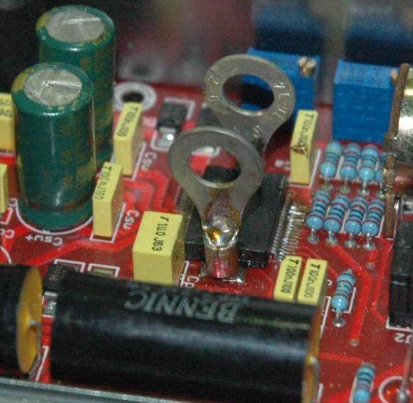

heatsinks
I did it this way because the copper base of the heatsink will be far more effective at transferring heat than the plastic cover.
I used blue utilux crimps, red ones are a smaller diameter and should fit into the recesses in the side of the chip a little bit better.
pull the plastic sleeve off, file the end of the ferrule flat for better contact with the chip's heatsink and solder it on, easy. You need a 60 watt iron and good quality solder.

The sound is richer and fuller and it is more forward sounding than with the volume pot . Like you are just a little closer to the music. It is also more dynamic, the sonics are better, and I can hear a little more of the detail in the music! It sounds great.
I will have to change it back at some point in a few weeks to double check the difference in the sound. It sounded good before, this sounds better now however.
