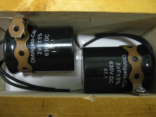

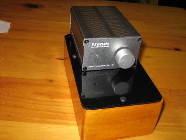

I have finally completed my add-on box (obbligato nest) and got the thing running. I attached the Trends to the new box and ran shielded teflon wires through the pcb and drilled holes in the bottom of the case to connect the caps. I found that with the shields grounded at the pcb, the amp sounded terrible with huge amount of high frequency noise and static. I disconnected the shields and the sound quality is very good.
Haven't gotten around to adding shields to the inductors and installing the FM's that were left over from my Sonic impact mods.
I plan to try swapping different caps in and out of the box and maybe install a switch so I can flip from one set of caps to another for comparison purposes.
Here's a pic of the completed box below.
Job well done!
Keep us updated how it sounds once its run in a bit🙂 The Obbligato's do look big buggers
