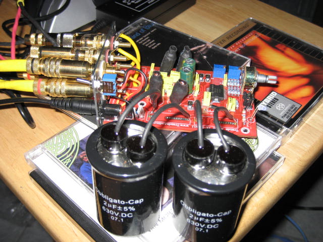

Jumpin John said:I think that I need a bigger case!
Hey, is it a good upgrade?
Robert
You do!
Throwing the big boys at it, are you? I love those Obb PIOs.
For anyone else wanting to try this, you can go to your local electrical supply and get "motor run" caps. They come in metal cans - they are very big, but cheap. Be sure that you get "Motor RUN" not Motor Start.
2uF should be the minimum if you run full range. I think that 5uF is a standard value. They make great crossover caps too.
If you like them, then get some of the Obbligato caps.
http://www.diyhifisupply.com/diyhs_ob_caps.htm
I think they are a good upgrade Robert, the sound stage is massive, with huge bass. The TA-10 is running my back-up Paradigm Reference studio 40's (92db) while one of my Energy Veritas2.2's is in the shop for a new woofer. The Energy's are more detailed and much better at imaging but are a bit of a load (dual voice coil woofer, 89db).They sounded great with the stock unit which came with unknown input caps. I'll have to reserve final judgement until the Energy's are up and running, but am impressed with the sound on the Paradigms. I'm planning to mount a wooden enclosure under the TA-10 to house the OBB's,and connect the caps to input with some teflon coated, shielded wire from a surplus store.

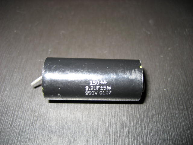

I've attached an image of the input caps that came with the unit, they look like Bennics, (black and yellow colour) but don't have a name printed on the case.
Pano, what do you think of the copper- case Obb's? I have a pair of 2.2uf but haven't tried them yet. How do they compare to the PIO's?
Yes, those are the caps that now come in the TA-10s.
I suppose they are unmarked Bennic, but don't know.
The copper tube Obbligatos are very nice, too. And almost as big. Sound is very similar to the PIO, but the PIO have a such beautiful midrange. Just wonderful. I think the PIO may be a little "soft" for some tastes. But I love them.
I listen mostly to jazz and classical, as well as lounge music and crooners, so these PIO seem to bring out all the richness of the mids. Rock and roll might be better with a bit more edge and distortion - isn't that what rock is all about?
I agree, the PIO's create a lovely midrange that goes well with the Tripath sound. To my ear, the sound stage is wider as well.
I'll have to try the copper tube version when I have the time, but I'm enjoying the PIO's right now and am in no hurry to change.
