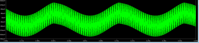

Should the waveform of a tremolo look like a modulated AM signal, with the low frequency oscillator behaving as the carrier?
The waveform I get in spice looks like this (see attached) when I attempt a bias adjustment configuration. It looks like more of a summation rather than multiplication.

Waveform of what? Tremelo is a low frequency oscillator modulating the amplitude of the signal. So the waveform of the LFO is one thing, the waveform of the modulated signal is another.
Your image appears to be as you describe, but the amplitude is steady.
Perhaps if you shared the schematic you were running in Spice...
No, tremolo is not just mixing a low frequency signal to the audio wave form, as Enzo said, it's amplitude modulation of the original signal. Typically a cadmium sulfide type opto-coupler driven by a LFO is used to accomplish that. If you Google "tremolo circuits" I'm sure you'll find many exampls to check out.
