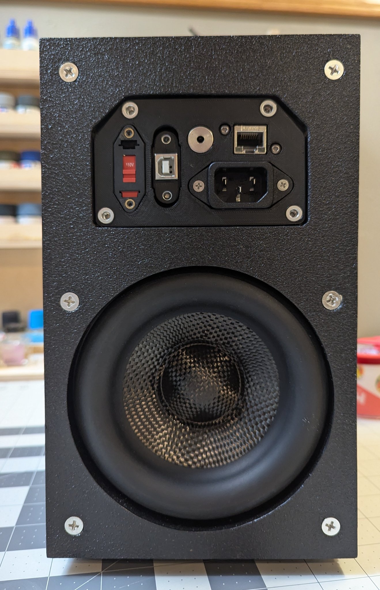

The completed package.

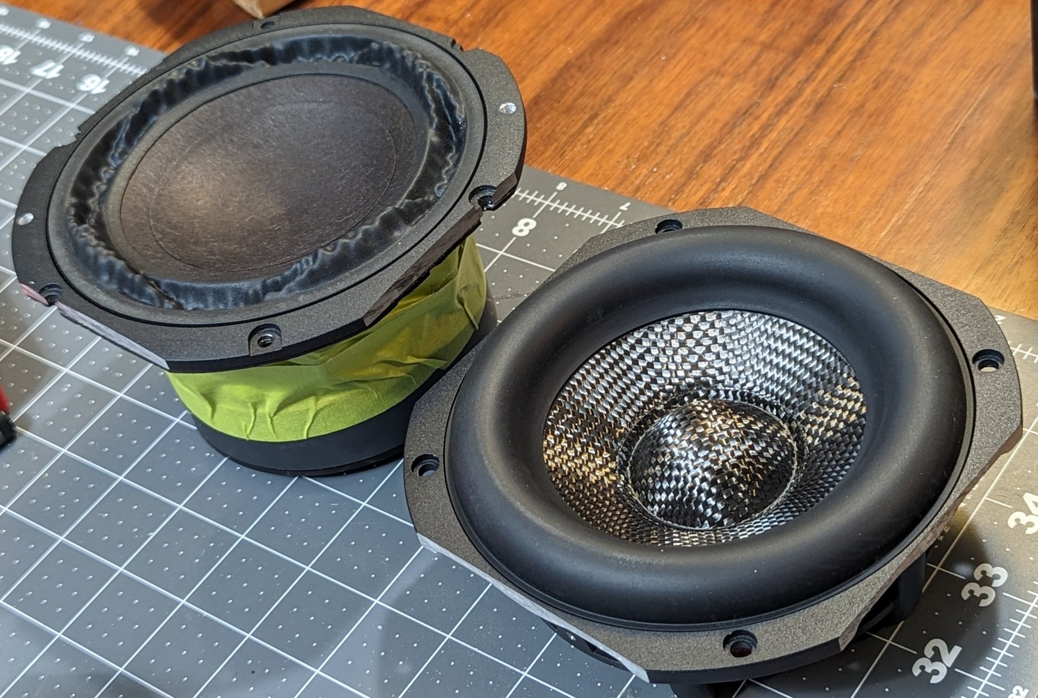

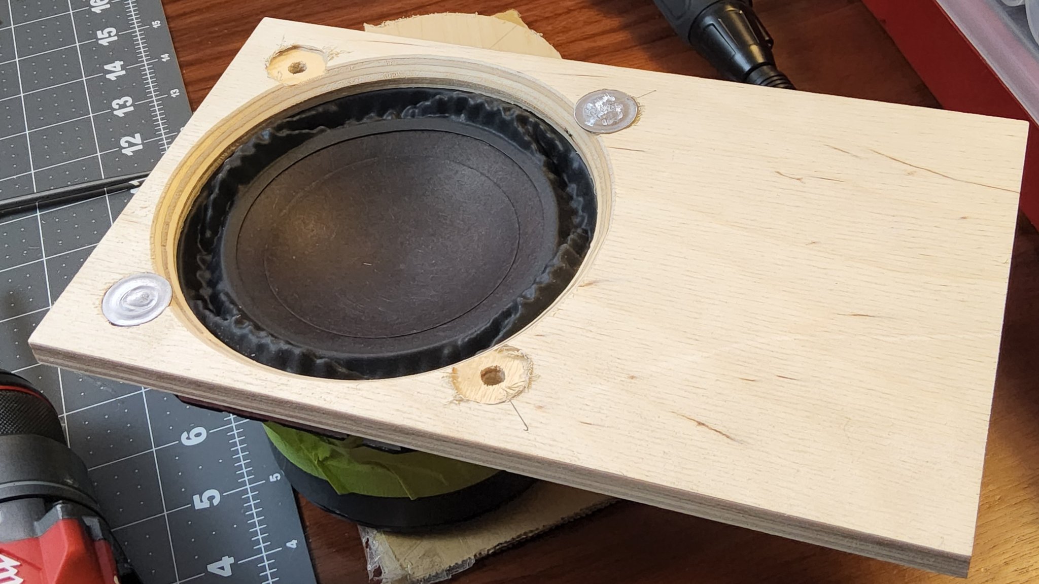

I made a jig to lop off the corners of the drivers and also punch two extra holes in the woofer frame to make it a normal 4 hole setup. Be sure to tape off the woofer perfectly to avoid metal crumbs from getting in the motor!

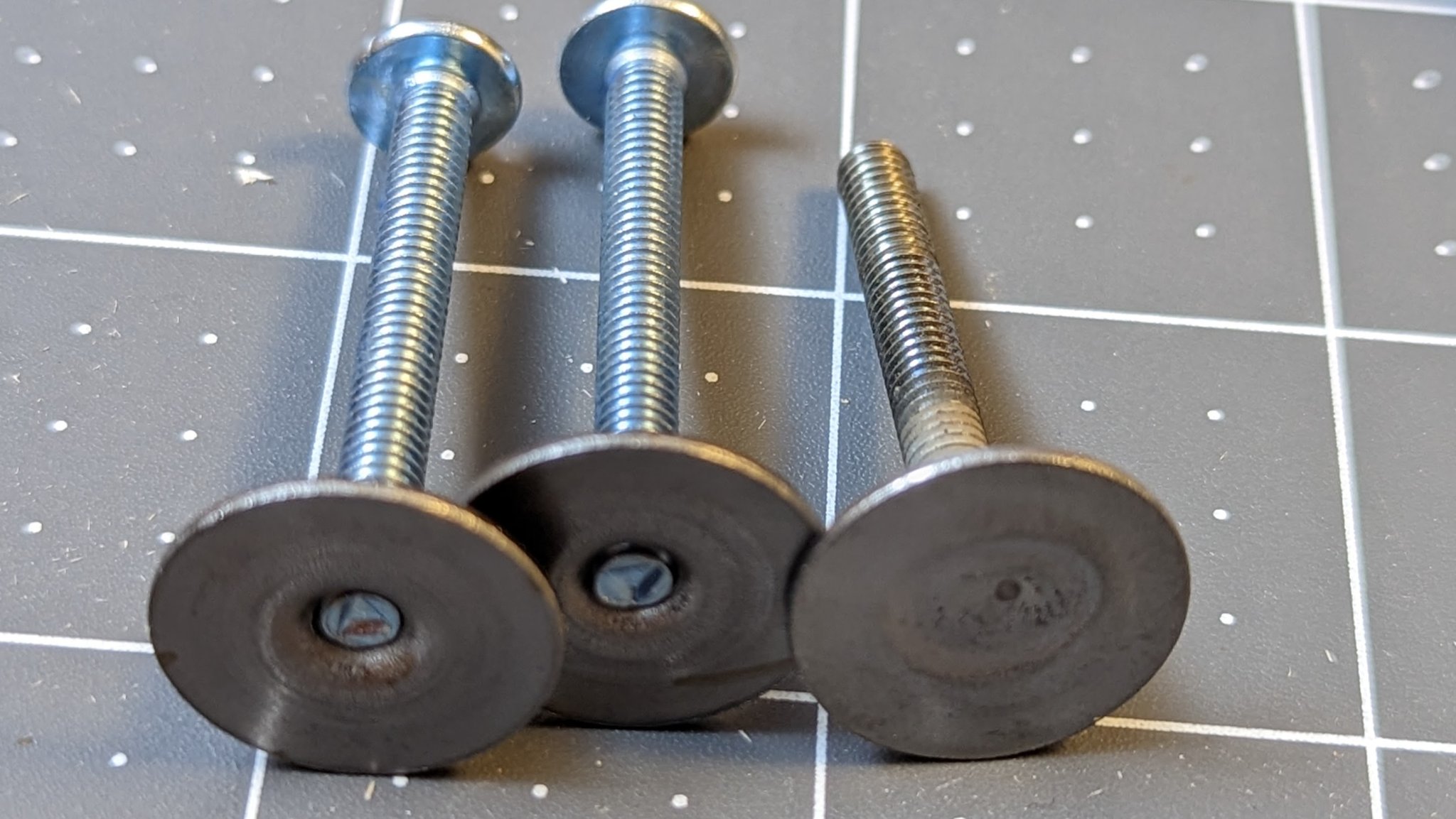

Woofer mountings where achieved with PE hurricane nuts with tig welded studs.
3/8" front baffle was barely counter sunk for the hurricane studs.
Box 90% structurally finished: rear baffle is 1/2" thick...top, bottom & front baffle are 3/8" thick and side are 1/4"

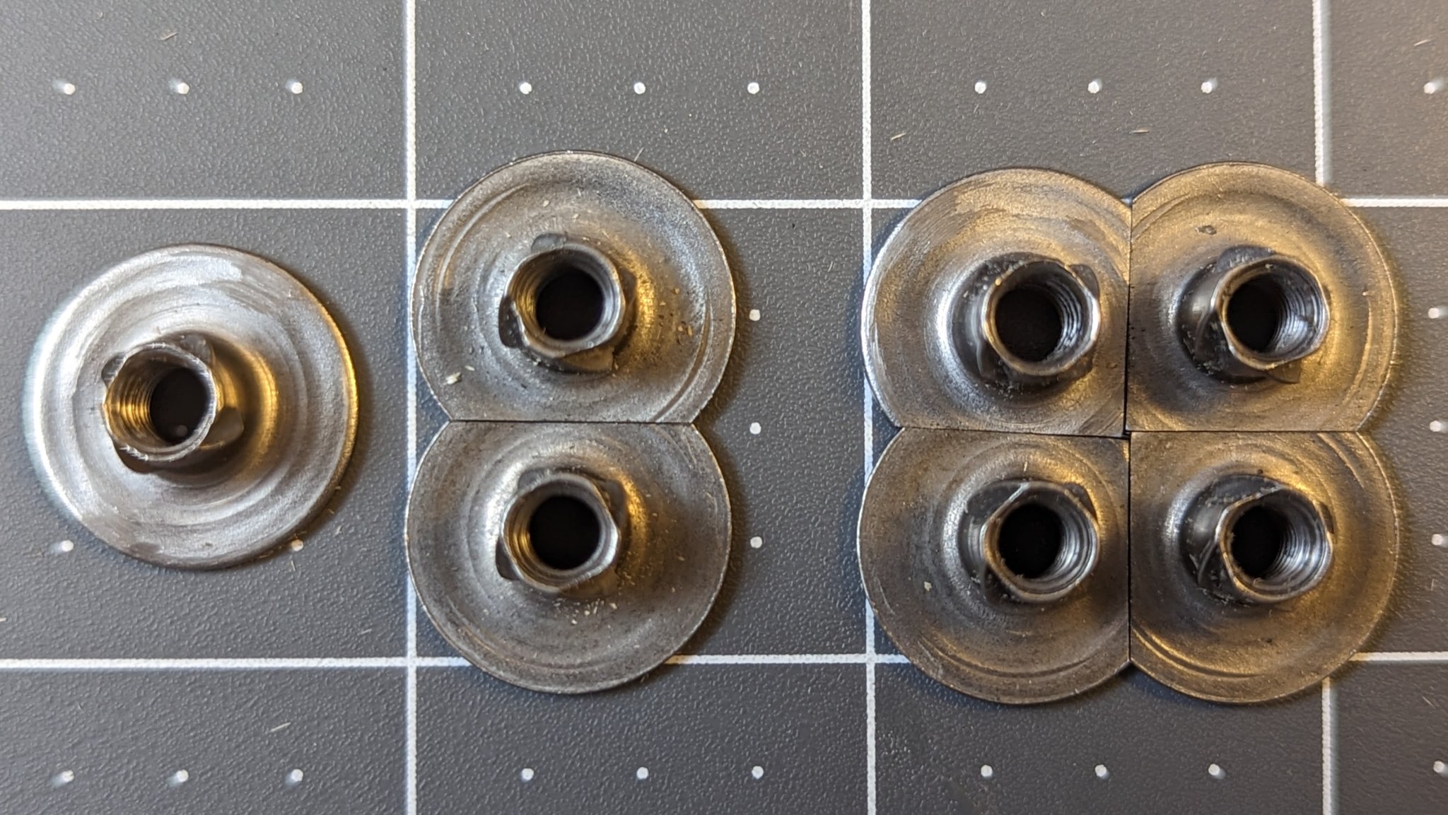

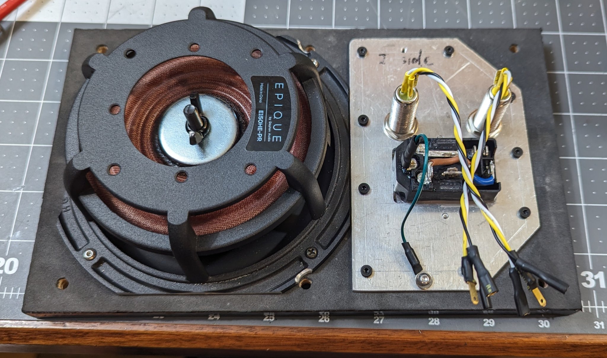

Slightly larger hurricane nuts for the rear baffle trimmed to get them as close to the outside edges of the box as possible to reduce bending stresses.

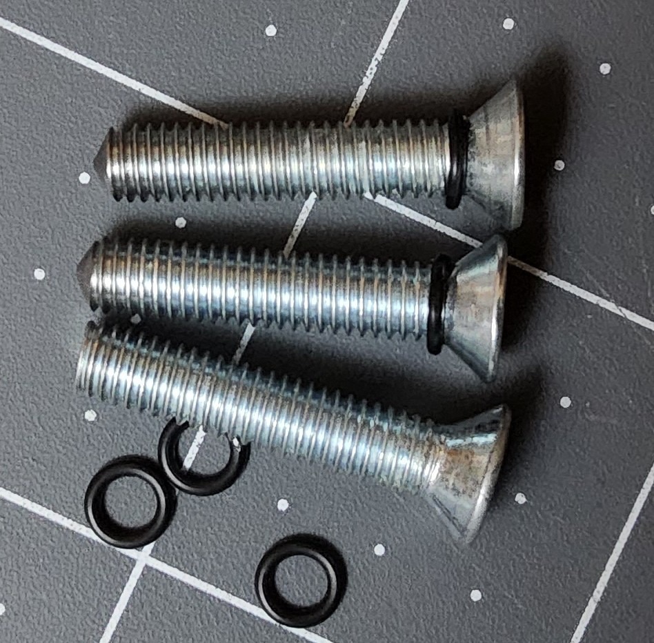

Small box and a powerful woofer will find air leaks very quickly. These O-rings saved the day.

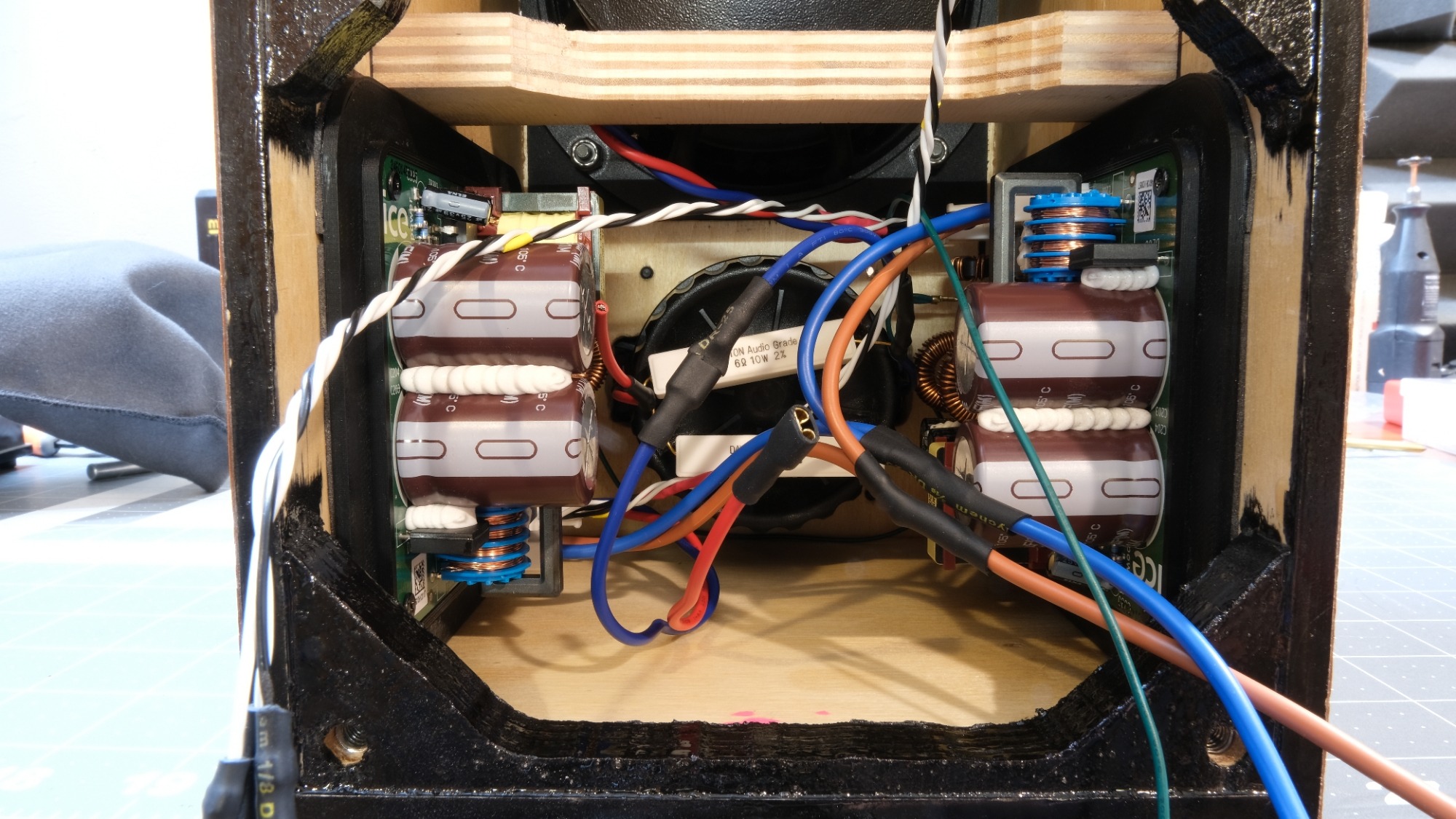

The rear baffle has a single sheet of 1/16" PSA closed cell foam gasket to seal everything. Also note wires can be easily disconnected for service or mods.
Here you can see the clearancing to make way for the PR (PR needs to be turner 90 degrees clockwise...oops) Also there is a horizontal brace now that is removable for service.

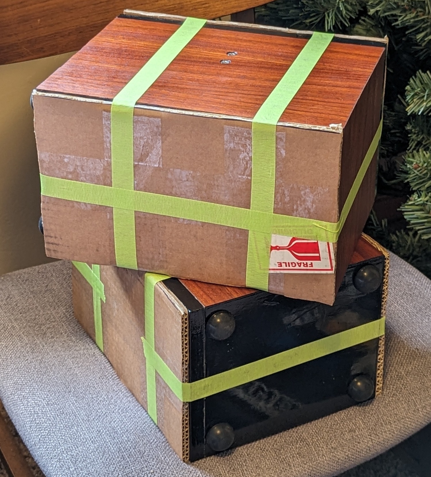

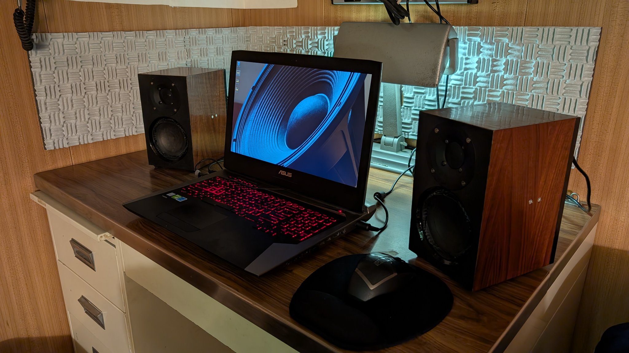

Super easy to pack!

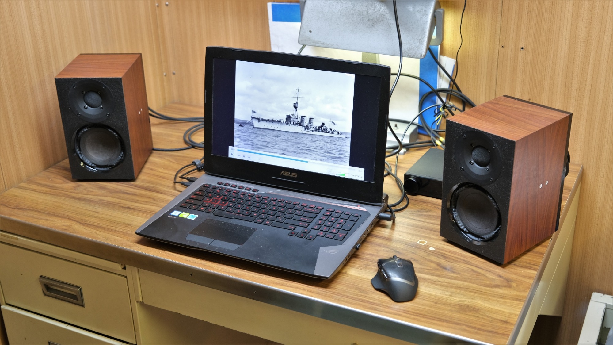

I'm actually aboard my ship now and have been for nearly two months (I'm in port, so I have internet).
Fun facts:
1. Active crossovers are soo easy it feels like cheating.
2. Crossover is set to 1200hz with 48db/Oct because why not.
3. weight is around 9lbs per speaker.
4. Front baffle and top & bottom are 3/8" thick, sides are 1/4" and rear is 1/2" to keep the PR surround flush. (Repeating myself :p)
5. H=9-3/4" D=7-3/8" W=6"
6. Lost the measurements but no matter, ill have to redo them because I think more tuning is in order.
Final thoughts: these are very intelligible, clean and have amazing vertical off axis sound. Bass output also exceeds expectations for a desktop speaker. Im pretty sure they have more potential.
Thank you for reading and don't be shy about questions.

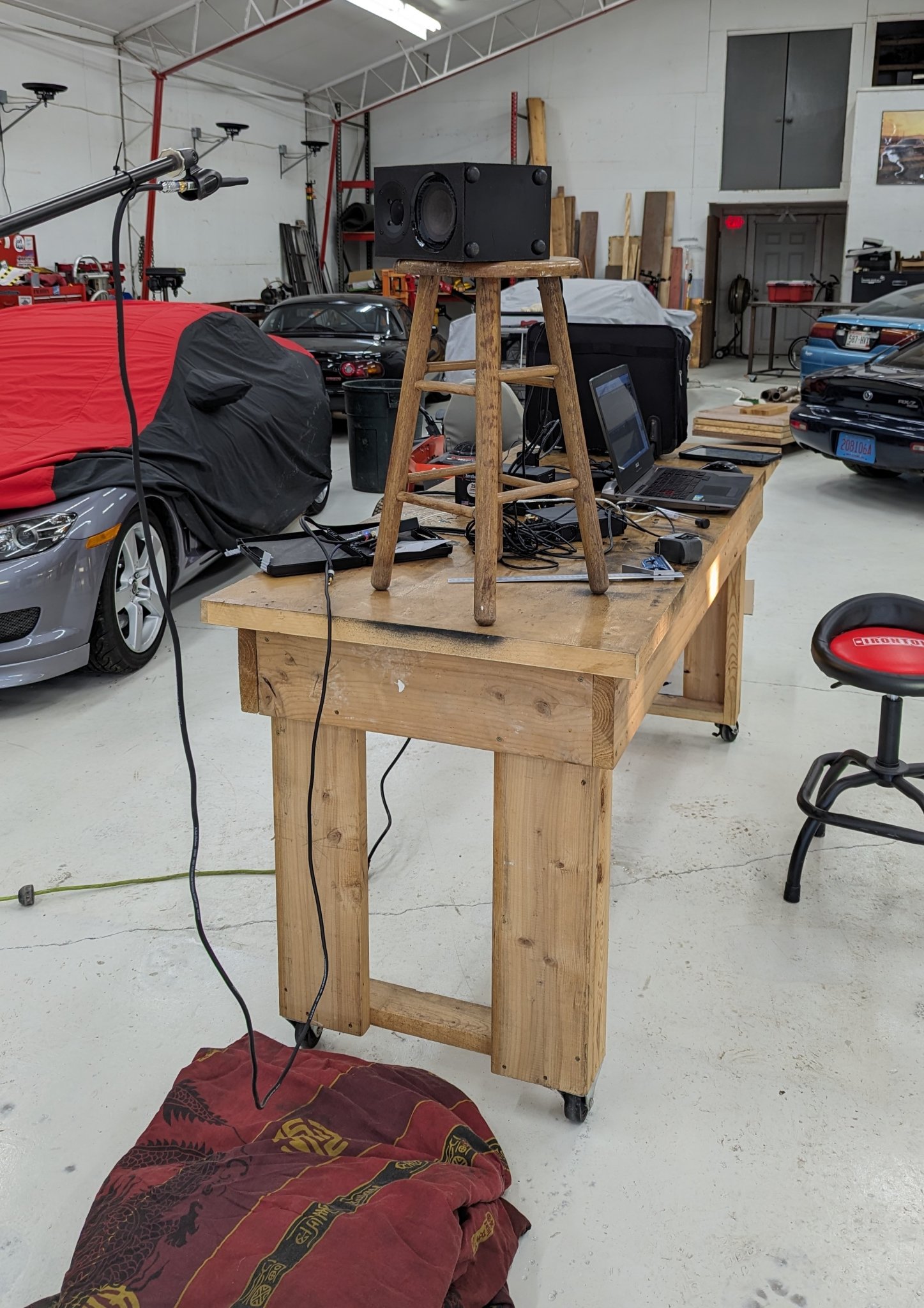

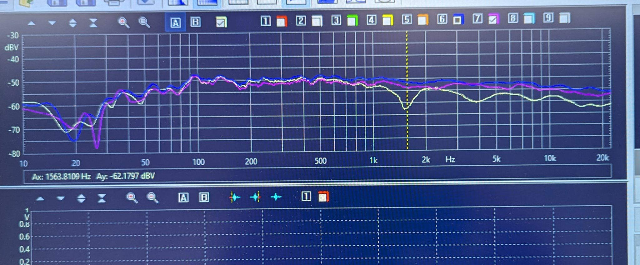

Measurements are in!
The above is horizontal measurements taken at 0, 22.5, 45, and 77.5 degrees.
Vertical measurements taken at 0, 22.5, and -22.5 degrees. The large dips are occurring on the below axis measure, so perhaps not too terrible.
And here is the rig. I'm using Clio Pocket.
