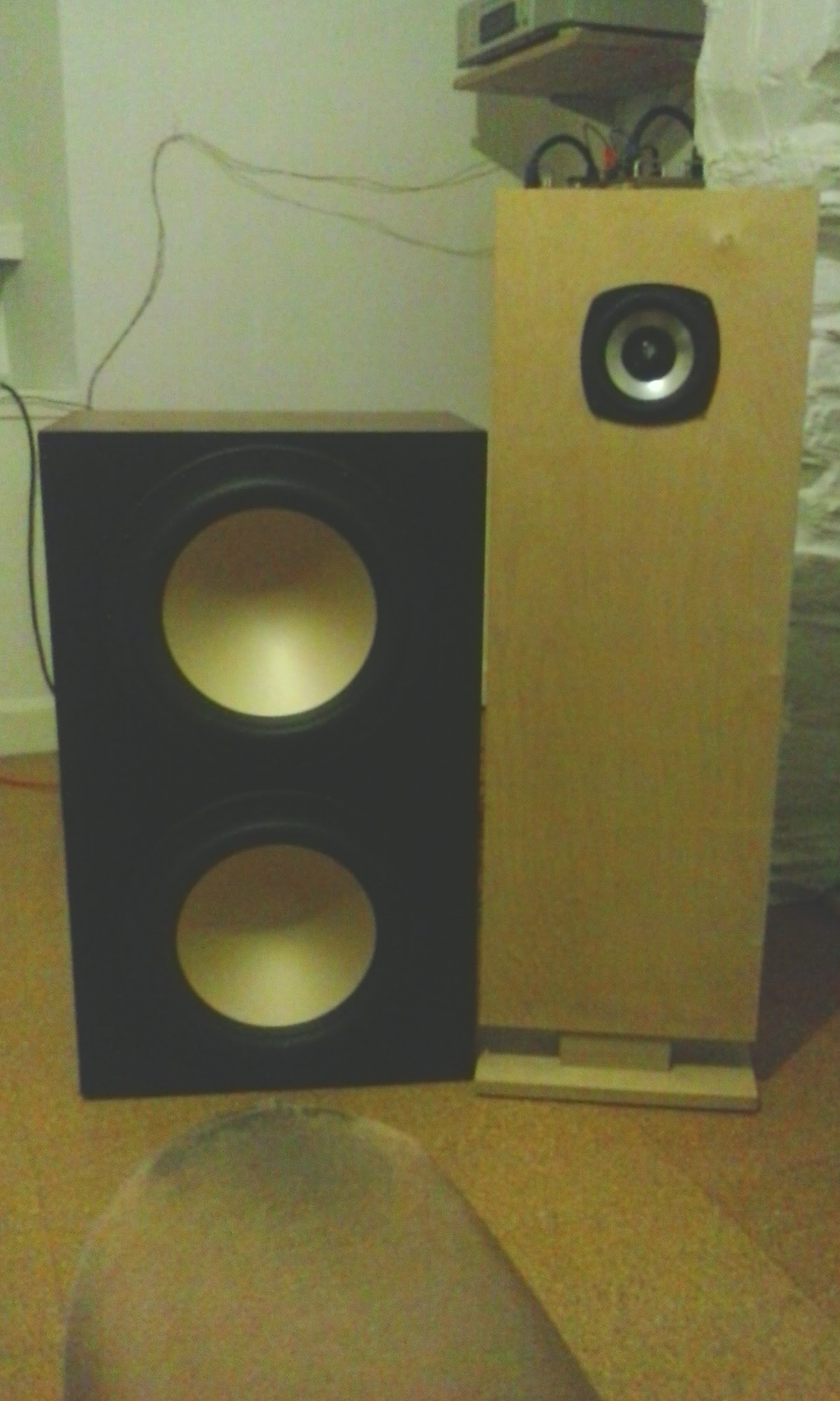

The Slim GR speaker build.
We have finally started!
I'll post more pictures once i sort through them, next will be the onkens.
Can anyone recommend the speaker wadding to go inside please and how much they use, i should be cutting and fitting the wadding to cover all surfaces (except the baffle)?
Also would i be keeping the magnet cover on and to take that into consideration when it goes against the baffle board? Also no bezel cover as it will be flush mounted.

I built my Eikona VTL's from Baltic Birch ply, I finished them with grain filler and wax polish, simple as that, I found even the edges with their thirteen plys attractive this way
We like a product called Ultratouch 1/2" felted recycled denim with a bonded fabric backer - designed as a liner for HVAC ducts - but any natural fibre upholstery padding would be fine. Line all internal walls, being careful to not block in the internal opening of slot port.
Not a fan of thin foams, but other folks no doubt would opine differently
Very tidy work - including the mitres - I frankly don't bother with those much any more.
As for the fit of brace to magnet assembly, I'd err on the side of caution - a gap thin enough for a slip of paper is better than too tight.
I've used a bit of 4mm cork floor tile in a similar situation, worked well, a bit squiggy but not too squidgy haha

Hi guys! So after some time we have finished the boxes, well a few more things to do but it will be completed.
I know i have asked this before, but i need to get it right before we glue all the panels together.
It's the speaker wadding dilemma i am having.
27? wide (68cm) 5 metre black layered wool felt. 1200grm heavy weight option | eBay
is this too thick?
Black Needled Wool Felt with backing FELTEX 1 metre Firm upholstery felt wadding | eBay
would this be better?
Once i get this right i can finish the speakers. Any pics of inside your own speaker builds to show the wadding would be a great help!

Neither of these says how thick it is. You want about ½”. Each of the two linked looks to be about the right consistency.
dave
dave
Thanks Dave! Please see the pictures, would i need to add a cover on it? Like a Cotten sheet? I worry about dust,bits of wool an fibres coming off and damaging the speaker.
I also read that i have to line the internal brace with some poly? So am i covering the sides, front speaker panel, bottom, top and rear panel with the wadding?
These trapezoid builds have been quite a challenge! Last bit is getting the chamfered edge cut and right.
yup, that second chamfer cut is a challenge - particularly on tall floorstanders
Jst be sure to keep the damping materials from occluding the internal openings of port slots. If you're concerned about loose fibres, a "sock" of cheese cloth fitted around the driver should keep any out.
Damping looks good. I wouldn’t worry much about bits coming off and harming the driver. You probably need to worry more about moths.
Low desity polyfluff batting (BAF) or a low density felt over the centre side of the holey brace is optional but by covering the holes you are providing dampening at the most effective point in any side to side resonances.

Got it, ill line it anyway

I can only imagine what a challenge that is! next time we build this box i think we will do it differently, although its been a great learning experience
Just be sure to keep the damping materials from occluding the internal openings of port slots. If you're concerned about loose fibres, a "sock" of cheese cloth fitted around the driver should keep any out.
I will make sure i give clearance for the ports!
I like the idea of a filter sock from cheese cloth, i may just use that.
