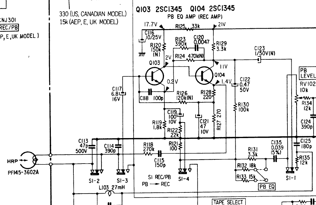

I'm going to post the circuit of such a layout here. Although yours will differ greatly in details I think the basic setup will still be similar. The emitter volts of that 2SC device is extremely low. It might be worth a swap just to eliminate it.
This is a typical two stage amp for a head. The R/P switch interacts with everything...

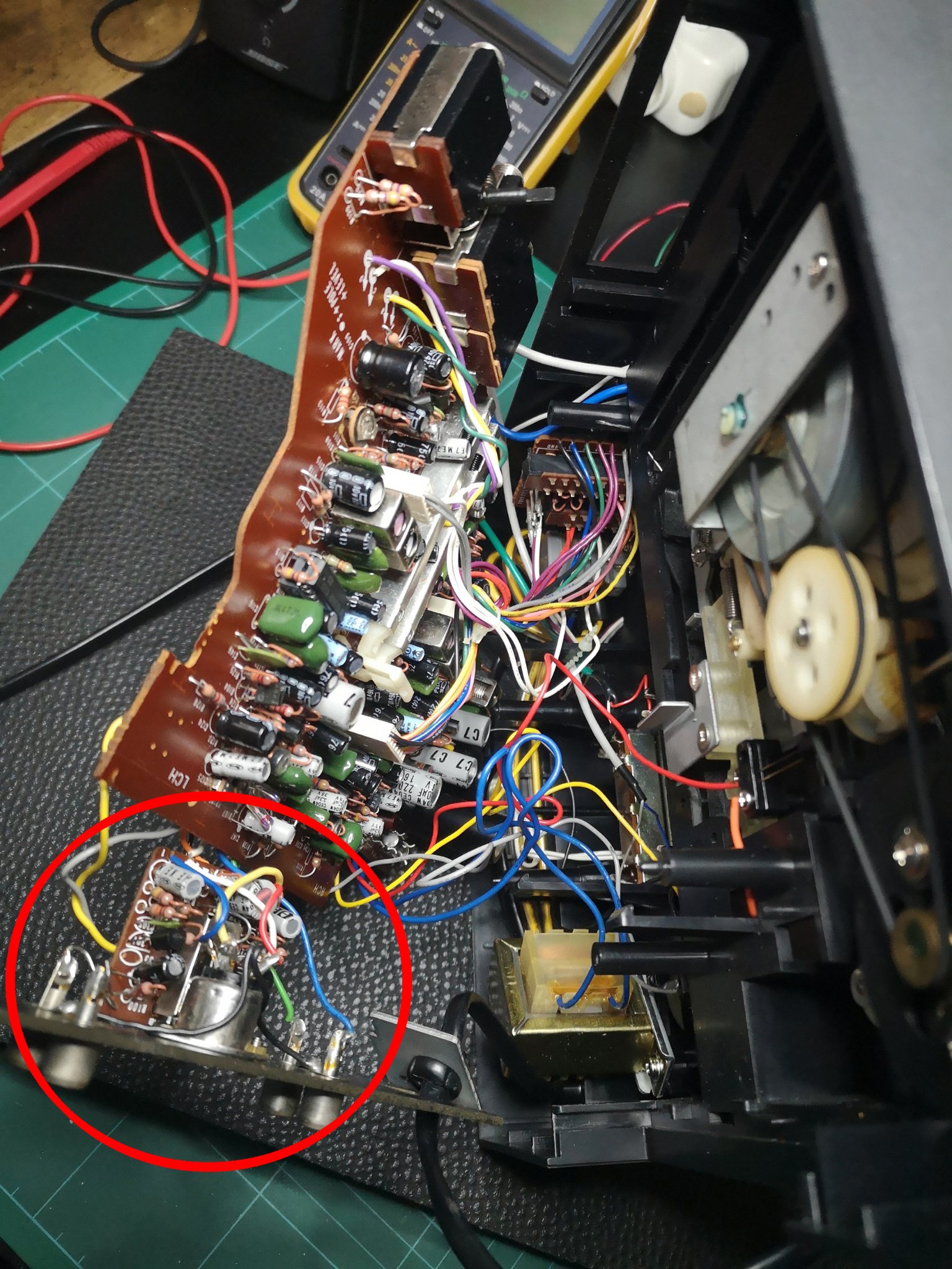

5. The only thing I didn’t check is the small board connected to the back panel (pic attached). Since it holds a kind of DIN socket for remote Rec/Play, I think maybe somebody in the past could have plugged a wrong device in, or the remote itself was shorted or damaged in any way. I will check it and maybe I will try hard to reverse engineer the little PCB, it’s something I never did before, but let’s see.
PS I don’t have the hypothetical remote control.

If you have a 5-pin din plug between the input and output RCA´s, it is NOT a remote connection.
It´s a DIN-connection for rec./play to use INSTEAD of the RCA´s. A signal connector..... not a connector for remote control.
A lot of radio´s/amp`s (european) like Grundig/ITT/B&O etc. used only DIN.
It´s coupled reversed from normal DIN, so your deck will have Audio In on pin1 & 4, Audio out on pin 3 & 5 and ground on the middle pin (2).

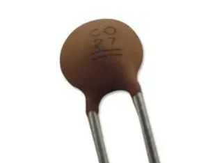

If we eliminate the transistors then the next suspects could be something like a small compressed disc ceramic cap (these often go leaky). Like these. Isolating one end of them would restore DC conditions if it were leaky:

@Boydk - Yeah, you’re definitely right. I’m old enough to remember that kind of European connections, my uncle used to have a Grundig like that in the 70s. I don’t know why I thought about a remote, maybe cause I have the same kind of DIN socket on a slides projector’s remote control.

For the caps just non invasively desolder one lead and measure the resistance on high ohms range. They should be totally open circuit. You can also then power up and check the voltages on those transistors with the cap isolated.
Just tried the all above, no luck. The multi-switch seems to be ok, I left out the first pin and checked the others in series of three (1 and 2 beep, 2 and 3 open; 4 and 5 beep, 5 and 6 open and so on). The same result I got testing the working side. Note that the "Play" position is the rest position of the switch, so I did the testing in that position.
There's only one small disc capacitor per channel, and the suspect one is ok, tested with one leg out and max resistance range, it reads as totally open.
