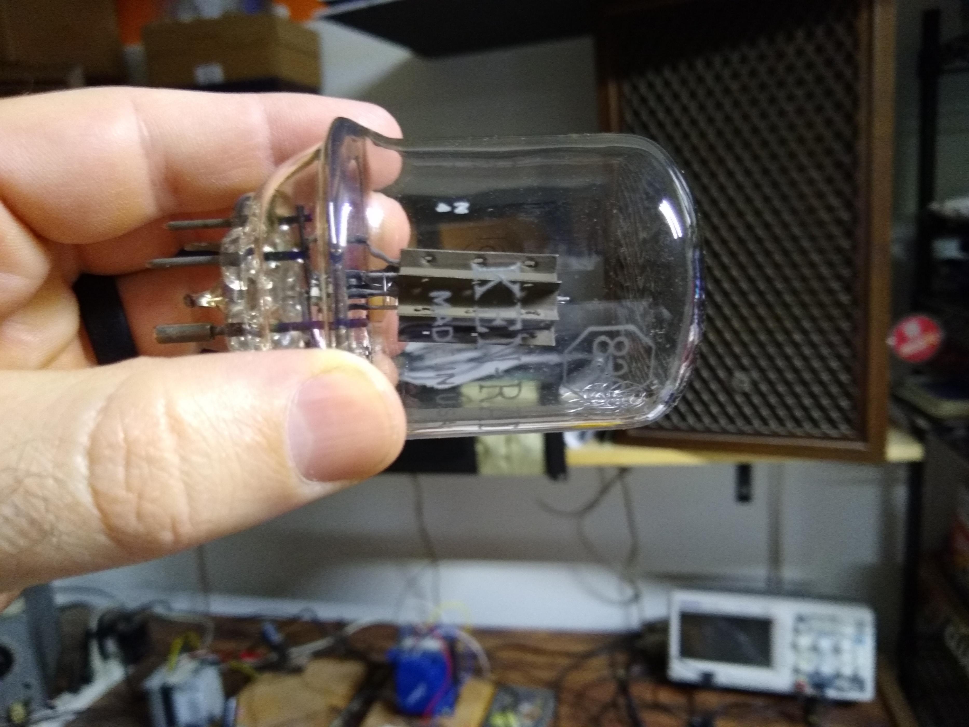

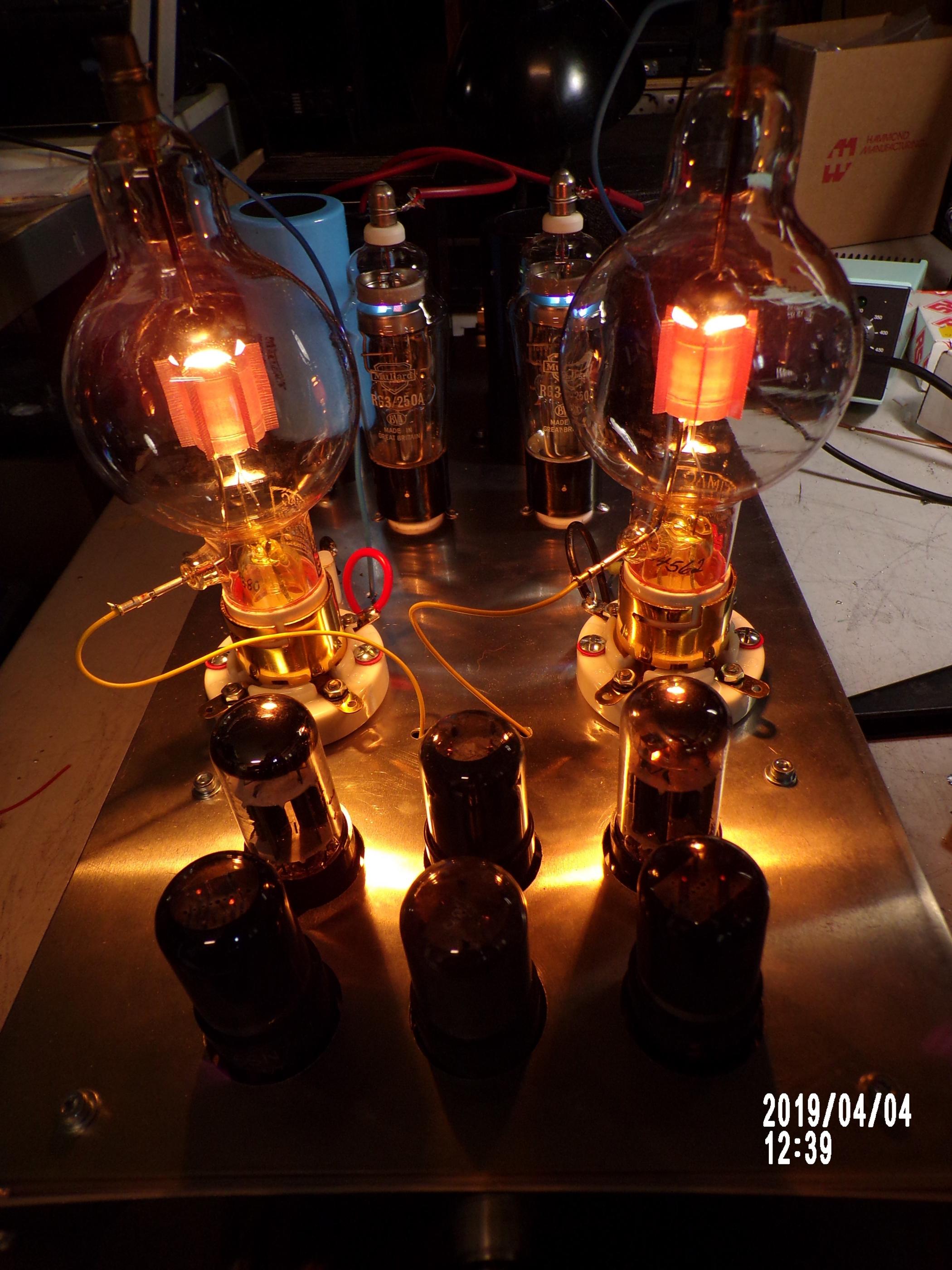

I got to testing these 826s a bit this weekend and I got very consistent results between the two samples I successfully tested. I didn't see any gas clouds. However, I would say that I was getting a little less current than I would expect from the datasheet. I'm guessing since I was running the grid at +15 and there is no datasheet curve for +15, but I think my combined plate and grid current should have been maybe 25% more. I got 72-73mA combined current @ 580V with +15 on the grid. Seems like I should have gotten more like 90.

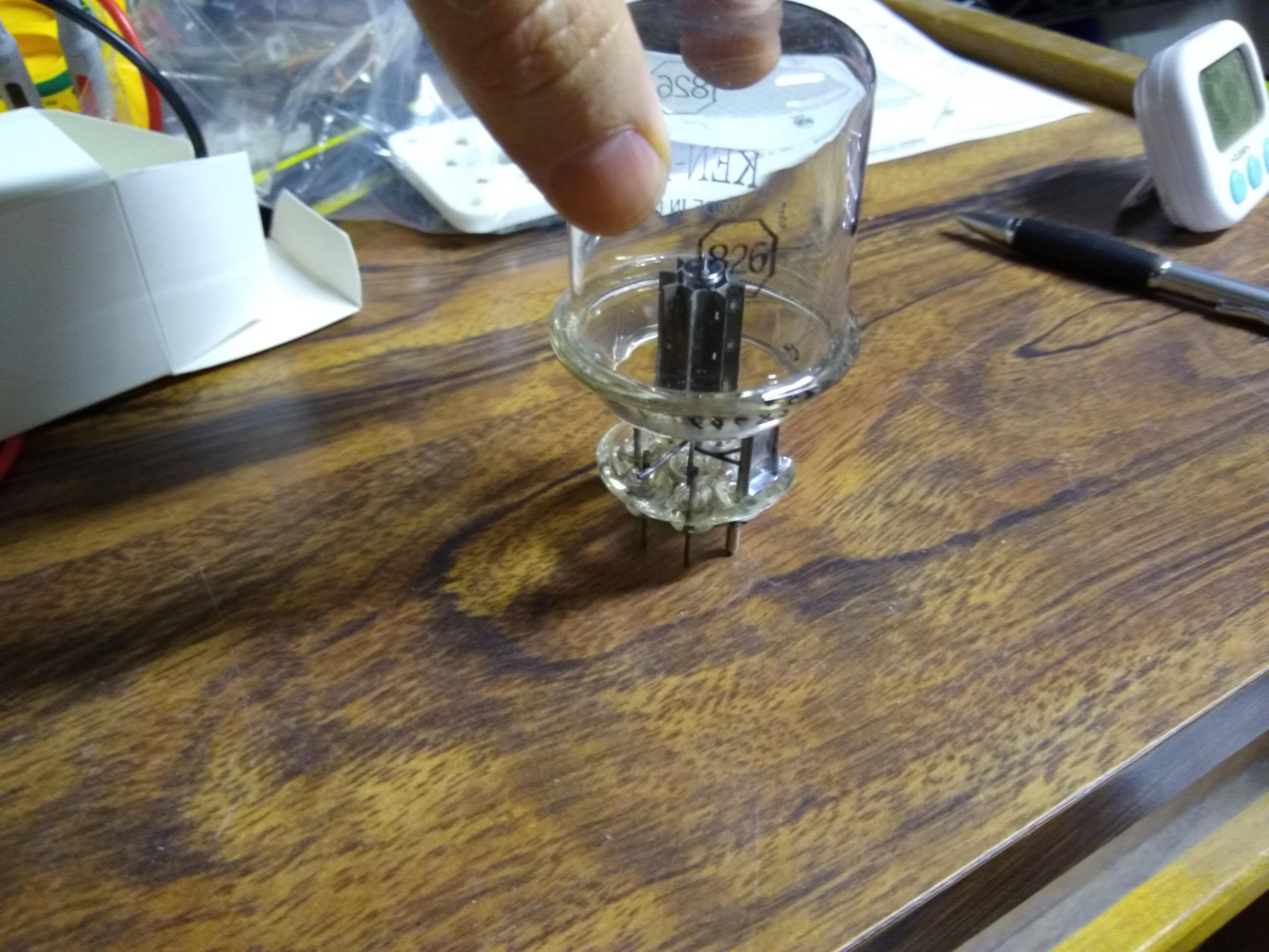

Unfortunately, a third sample did not make it to the plate current phase of the test. I inserted it into the socket and heard some very quiet stress sounds from the glass (and thought, "that can't be good"). I fired it up anyway and got a puff of smoke from the filament and I knew I was done. I went to pull the tube from the socket and the whole top of the glass just came off from the bottom part with the pins.
Seller is replacing that one and another one that ejected pieces of the grid and filament all over the inside on its way to me.

It means the tube has air in it because of faulty seals. Remember I told you that many of these are like this. That's why I never bother with them.The filament let off a cloud of smoke when I lit it up. I assume this means that the tube is so gassy there is no bringing it back. Is that a correct assumption?
Yeah, I ordered from a vendor that stands behind their product, so they are sending replacements for bad tubes. But out of the 4 I ordered, 2 were bad (1 damaged in shipment). Out of the 2 replacements, 1 is bad. I'm not having great luck with the tubes from the vendor, but they are replacing them.

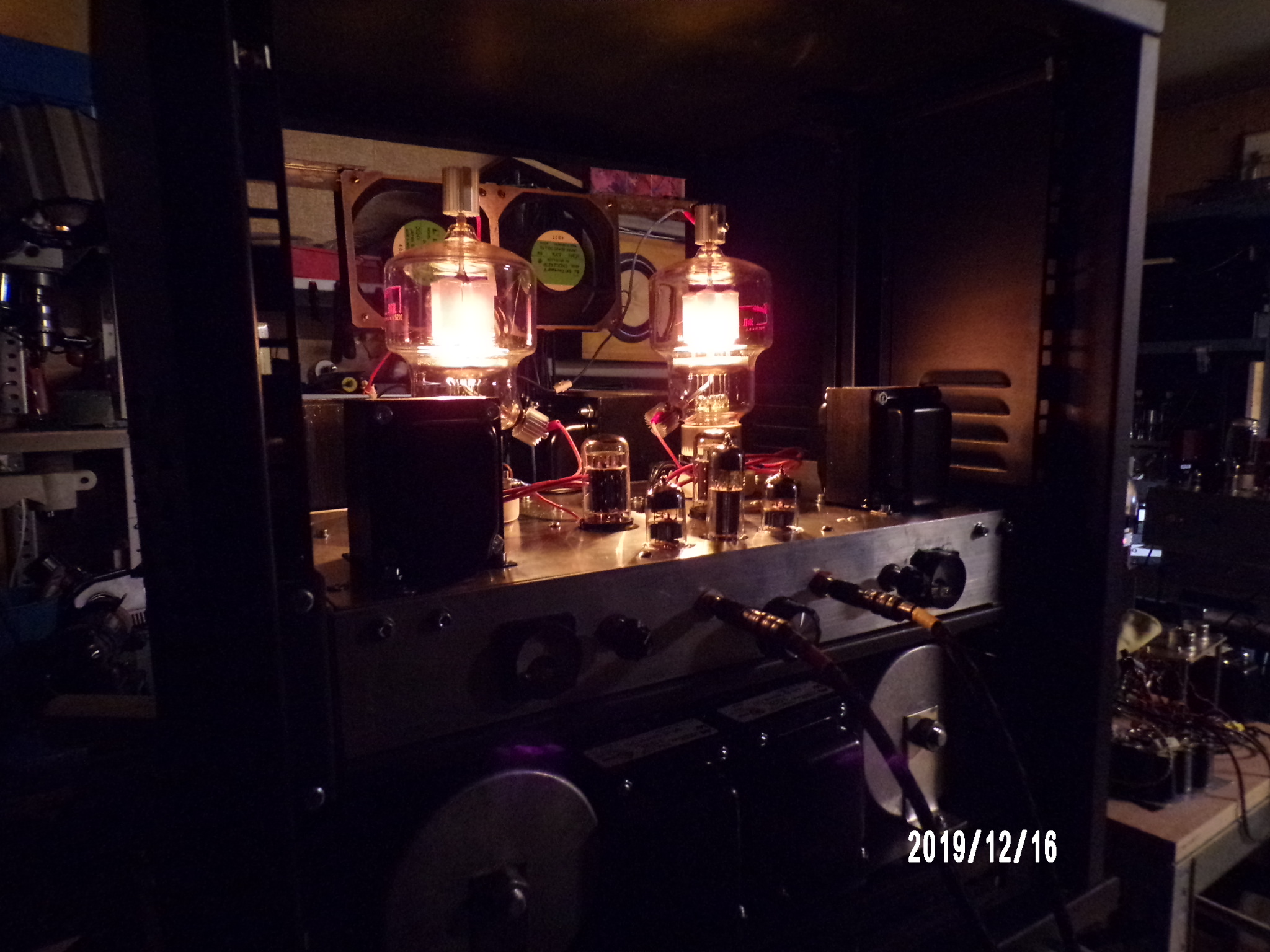

The 826 datasheet clearly says "forced air cooling" - normally this would be from below to keep the pin seal area coolest (differential expansion of pins w.r.t. glass is bad news, 200C is commonly quoted max temperature for pin/glass seals to prevent cracking/air ingress).
The 826 is rather inefficient for a transmitting tube needing 30W heater input for 60W max plate dissipation - this means its really hot even when doing nothing, so I'd take that forced-air cooling requirement seriously.
Other transmitter tubes use anode fins, allowing smaller internal dimensions for the same anode dissipation, and thus less heater power compared to plate power. For instance the QQV06-40 dual tetrode needs 2 x 5.5W heater for 2 x 20W plate dissipation - this tube can be operated without forced air cooling at lower power levels for instance.
Modern transmitting tubes use water-cooled anodes, which is a quiet(*) and reliable method of cooling - you ocassionally see some second hand that aren't in the stupidly high power range. The anode for these is more 'block' than 'plate'. There are examples of the 4CX250B that are water cooled for instance.

I've been giving this a lot of thought. It looks like there are sockets out there to make this easy. Unfortunately, I don't have those. I have the square ceramic kind. I'm looking at it, though, and it looks like I could just make the hole big enough for air to pass around the bottom of the tube and space the socked downward below the chassis to make a path for air to flow.
I'm thinking I can strike a good balance between airflow and fan noise with some extra-quiet PC fans run at less than full speed.

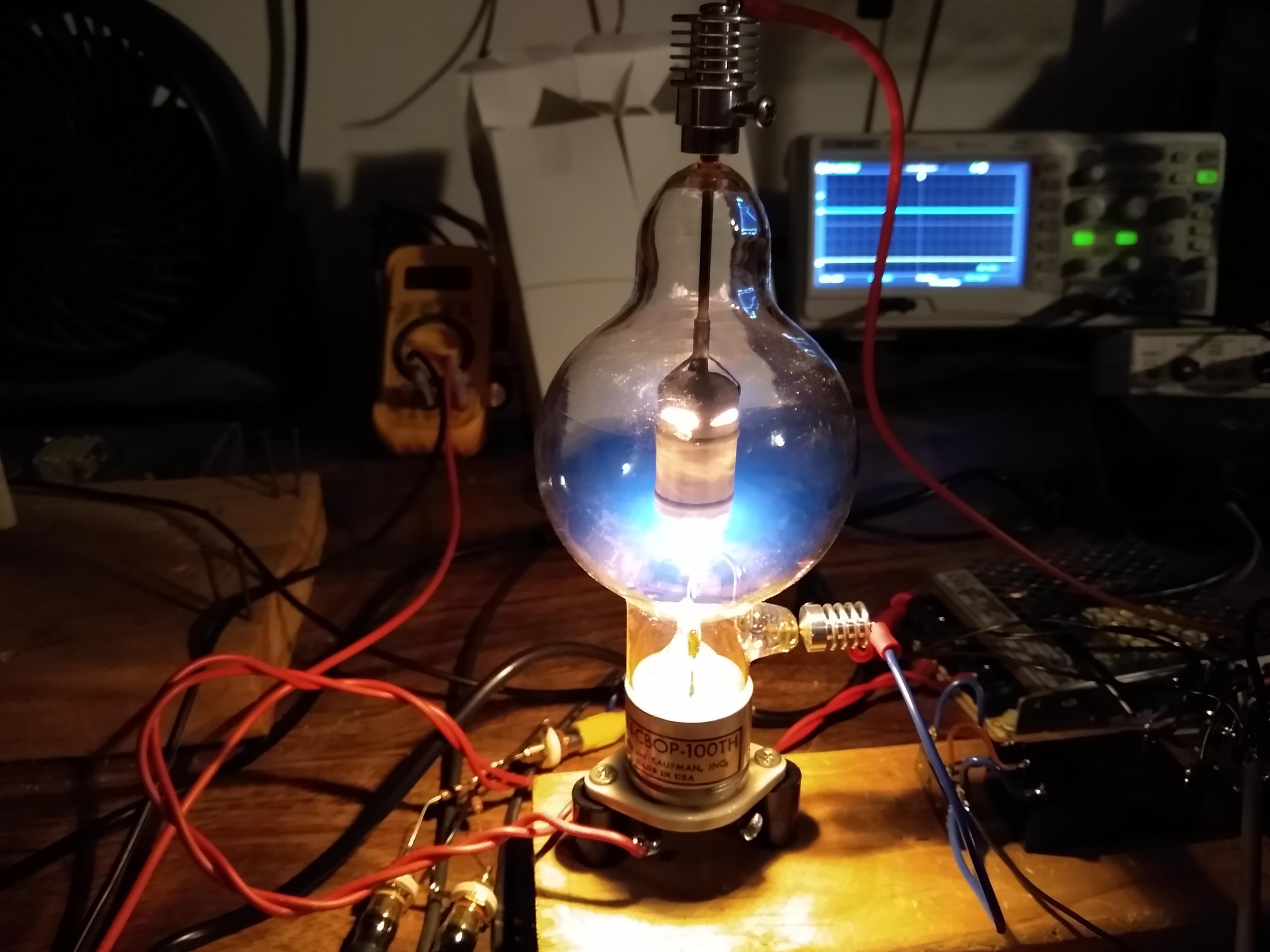

Well, I could use some advice on this guy (100TH). I'm getting a nice gas cloud when I start to apply any plate voltage. This is less than 100V on the plate with grid grounded. Current rises very quickly.
The other one I got has no gas cloud and I only get 6-7mA with over 500V on the plate.
Tube seller guarantees their tubes to meet manufacturer's specs. Should I try to heal it or should I exchange for another?

I don't have a recommendation but thought you might be interested in the following.
The first linked page is from a HAM and mentions that an arc can clear the gas.
The section on Gettering and Arcing.
Then in the Eimac bulletin they refer to another procedure for high voltage conditioning.

What are you doing with the grid for this 6-7 mA?The other one I got has no gas cloud and I only get 6-7mA with over 500V on the plate.
If you connect grid to plate (making a diode) and put 100 volts across the tube you should pull around 450 mA. If it's much less then this, it's probably weak. Then drop the filament by 10% and see if plate current sags much. (This figure is from my list of several dozen transmitting tube 100V simple emission tests)
