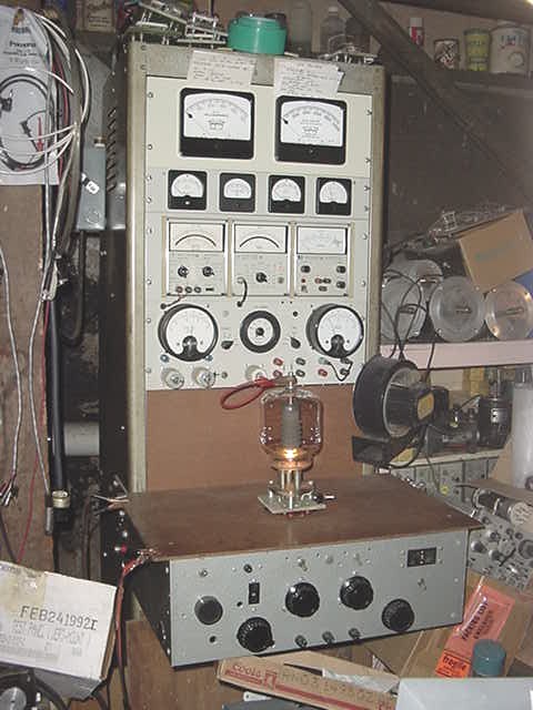

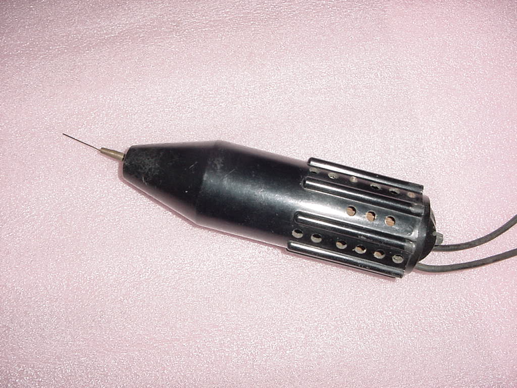

Geesh, 826s are one of my least favorite tubes because I have found a large portion of them are air bottles and the rest are 50% too gassy to save. I check for gas with a high voltage "odin" type coil (below) which connects to a 10KV neon or oil burner transformer by just holding the spark against the glass in dim light.
If the filament lights up normally (without smoking) there is a simple DC emission test you can do. Light the filament and ground it. Connect the grid and plate together as a diode and put 100VDC across the tube right from the DC supply. A good tube should pull 500ma. Do this only long enough to get a reading. Also, quickly dropping the filament by 10% will indicate the overall condition. A strong tube not drop much, but a weak one will be very spongy in it's reaction. I normally test most all big tubes on my purpose built tester that's good to over 1KW dissipation. I think you will do OK to power up a tube with a bench supply as you mention above. You may need a little negative on the grid to control the current if it's a little gassy. Grid current will confirm this. And you are correct in that some tubes you can reduce the gas by baking with plate current and some will be beyond saving.

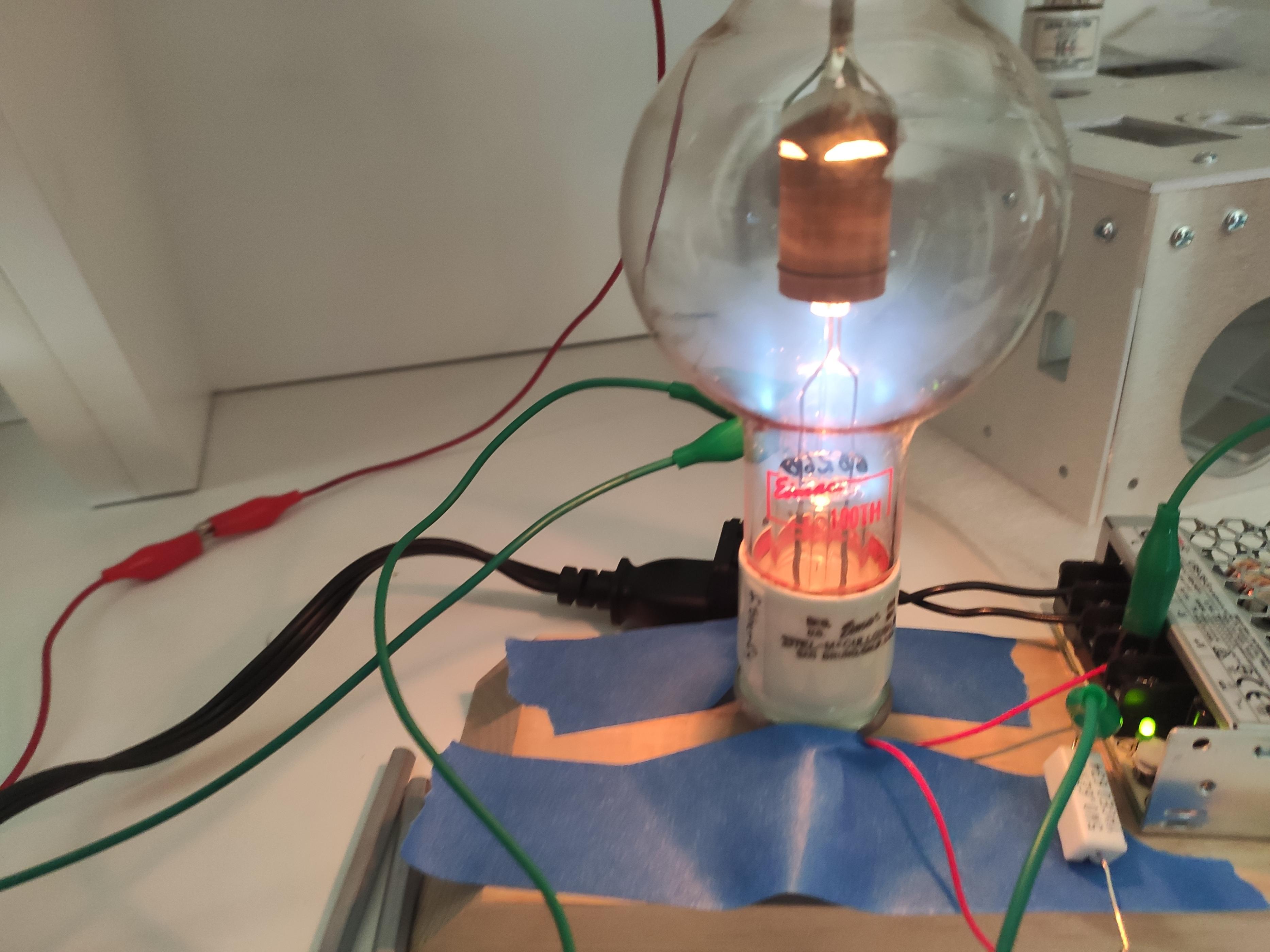

Here are some results running a 100TH today. The first photo shows the tube heated with the grid grounded and 550V on the plate. I let the tube sit like this for an hour and the big *** gas cloud that appears at the bottom cleared up.

Next I noted that the tube was just not drawing much current. 550V and 0V of bias should be ~25mA or so of plate current.
To motivate the tube a bit, I hooked up my small 30V DC bench supply to bring the grid up above ground. With the grid at +30V, I would expect about 100mA of plate current to be drawn. The DC current has crept up slowly from about 5mA to now roughly 90mA over the last hour or so.
I will leave this going for quite a while (4-5 hours), then I will shut it down, let the tube cool off, then fire it back up to be sure the gas is still gone.
