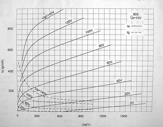

I have found this http://www.tube-fullmusic.com/produ...roduct0-805.htm It seems the curve of a pentode
do these tubes normally work in class A2 or AB2 (with grid current) ?
These are the grid current curves, not plate current is why they have thier shape. Yes, the 805 tube is normally used with grid current. Class B(2) amplifier/modulator or class C amplifier/oscillator use would be the norm in thier original typical usage.

Tweeker said:These are the grid current curves, not plate current is why they have thier shape. Yes, the 805 tube is normally used with grid current. Class B(2) amplifier/modulator or class C amplifier/oscillator use would be the norm in thier original typical usage.
hi Tweeker 😀
This graph seems me different from the original datasheet...
http://frank.pocnet.net/sheets/111/8/805.pdf
( from the http://www.tube-fullmusic.com/products/en-product0-805.htm )
Y axis = Ia anode current ?
X axis = Ua anode voltage
Curves = Ug grid voltage
update..
perhaps is the axis x more expanded...
bye
