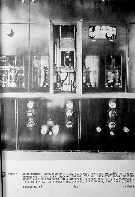

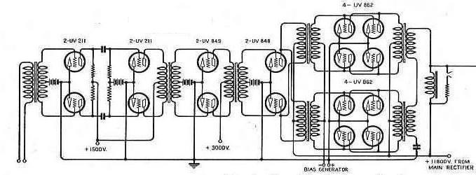

Cutting-edge 30s technology: Westinghouse high power audio amplifier, the large tubes are 849s, smaller 211s. I just love the look of this sort of gear. 3 phase 6 pulse "low power rectifier" at left, note the 6 diode tubes.
