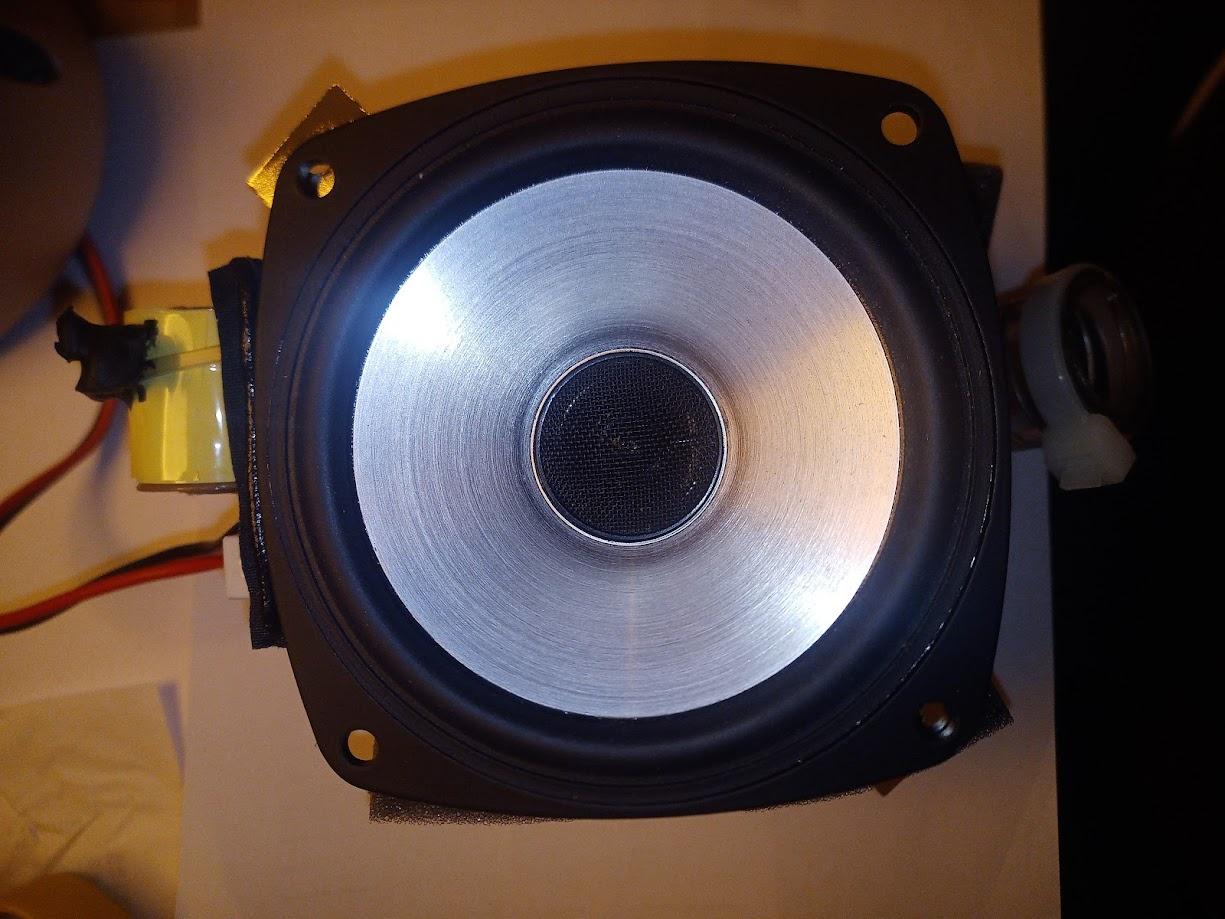

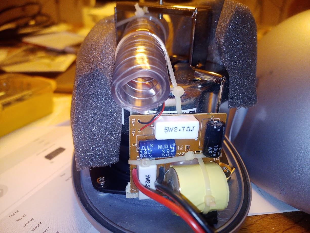

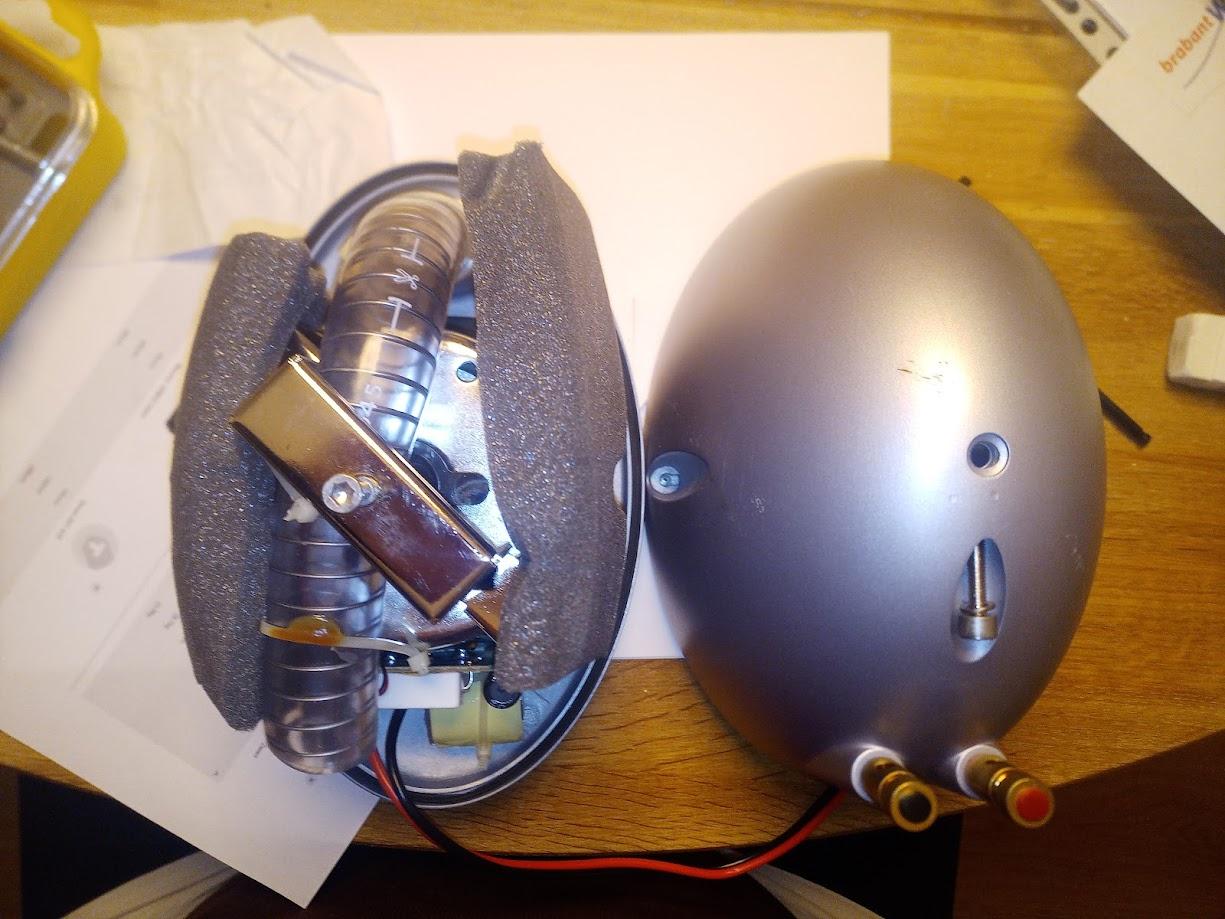

So if I understand you correctly: If I do not want to buy gear to measure T/S data of a coaxial speaker, then I am better off going for a sealed box? Or could I still go for a ported cabinet? The difference between sealed and ported F3 is quite large (+/- 75 Hz to 150 Hz) according to parts-express data of 4" full range speakers).
The original exclosure was 1,5 Liter with coaxial driver in it (so it was less), port had a surface of 240,5 mm2 and 170 mm long.
