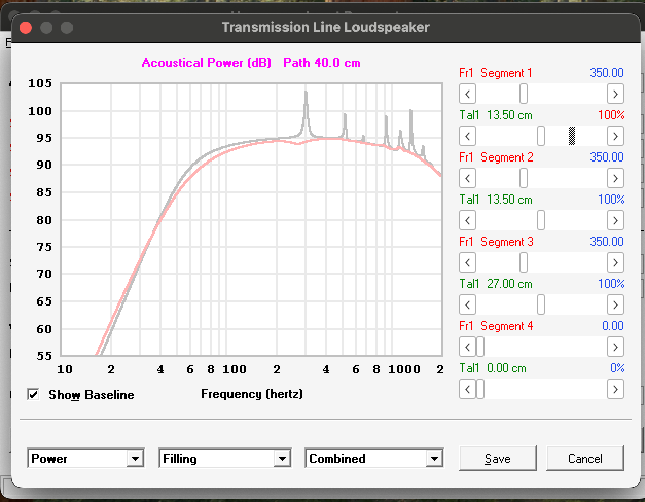

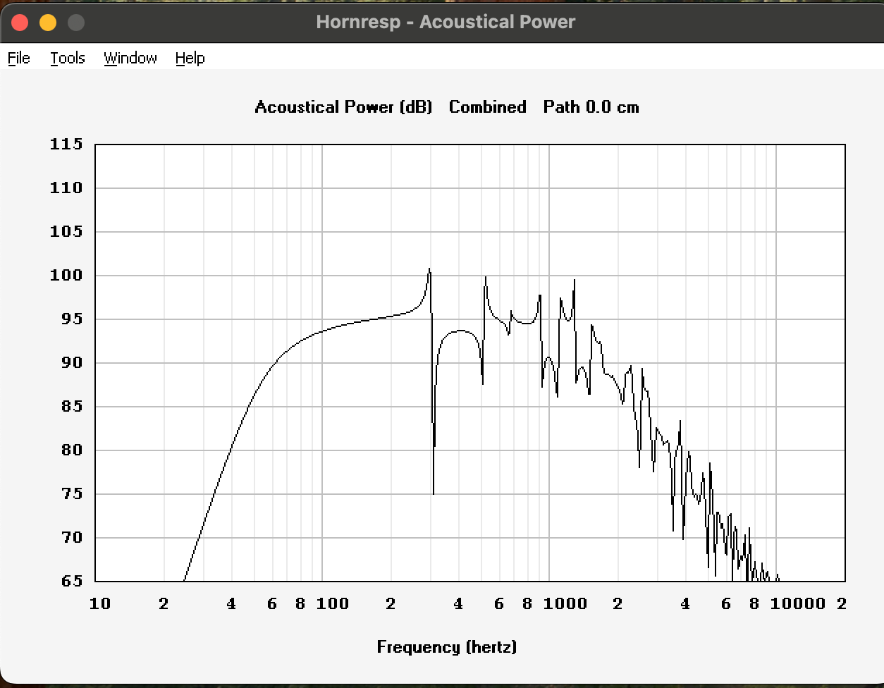

Yes, in the modelled unstuffed unit of mine has a lot of ripple. With the Path variable set and 8g/l of stuffing in the first 2 chambers the modelled ripple is somewhat reduced. IIRC I removed about half of the polyfill in the second chamber after some subjective experimentation.
Screenshot 2025-01-01 at 8.05.26 pm.pngScreenshot 2025-01-01 at 8.10.25 pm.png
