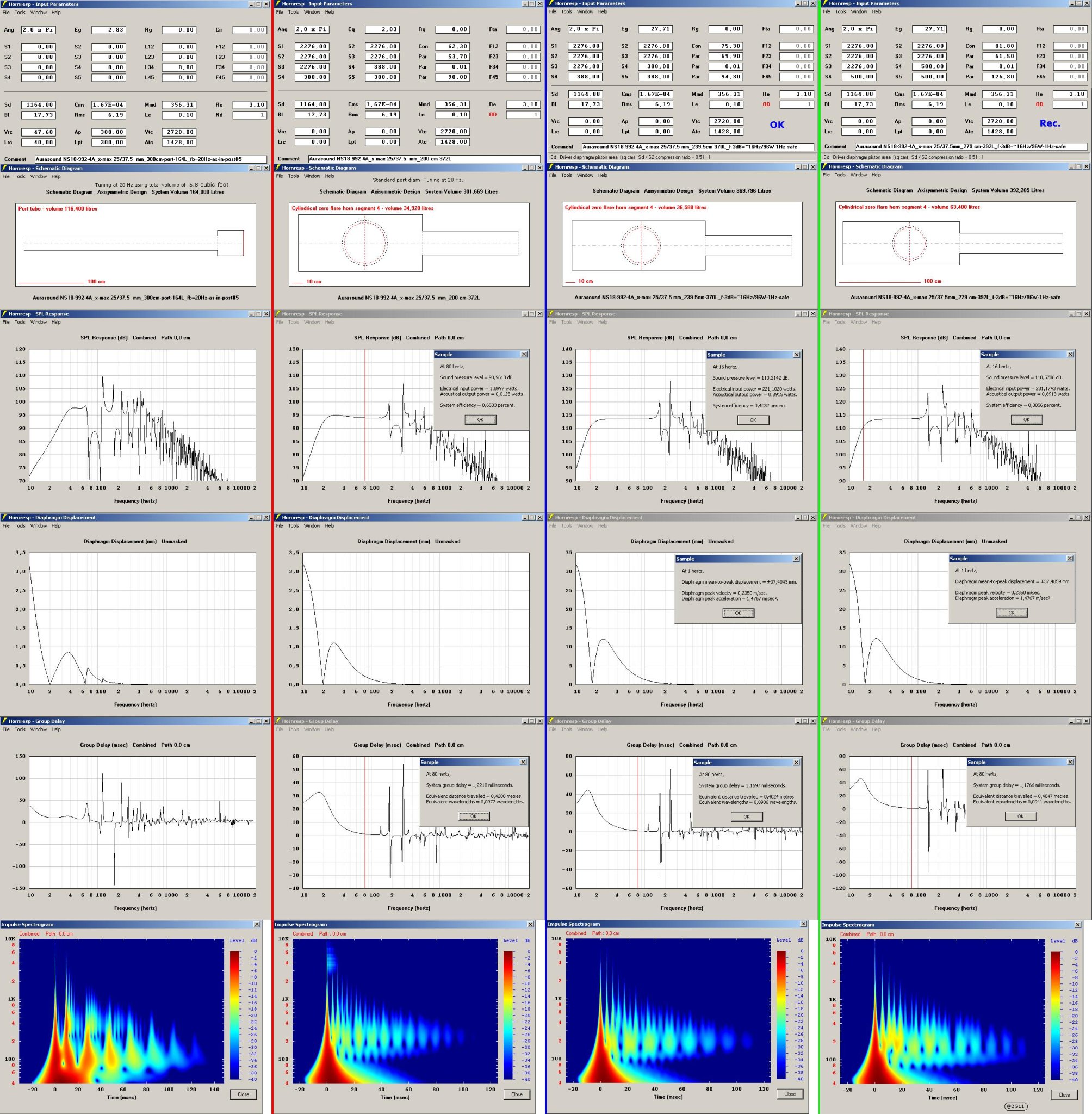

Some generic ‘shapes’ for reference(thx to Bjorno)now i get it, thanks 😉 so, even if you feed the sub with low frequency's between 20 - 40 Hz, you will get these resonances? I will off set them, how far do i need to stay from the right? I will make the TL around 3.2 meters and have space to adjust. Could this work? (drawing) View attachment 1168190
I will receive my wood soon and will make saw dust ;-) I will screw all together and can adjust / tweak / change after trial and error.. and measuring in my room. Always fun to find out if it works, did some TL's in the past with Dynaudio 21 cm, 30 cm bass, worked great. I had these 16 cm sonic's lying around and thought, lets go for it.. I read that they did well in large sealed enclosure and large TL's only.. what does that say about QTS ?As every case is different, because of the drivers and cabinet dimensions, horn resp is your friend, you must tweak your ofsets inside of horn resp and watch the power output graph as you tweak .the less crap you have above 100 the better. At least not those horrible peaks.
See designs and responses from cabinets already designed. And the most important...
Actually builder and measured for freq response...
You can simulate all day ...all week...all month but until you make sawdust and measure what you made ,that is where the real fun begin.

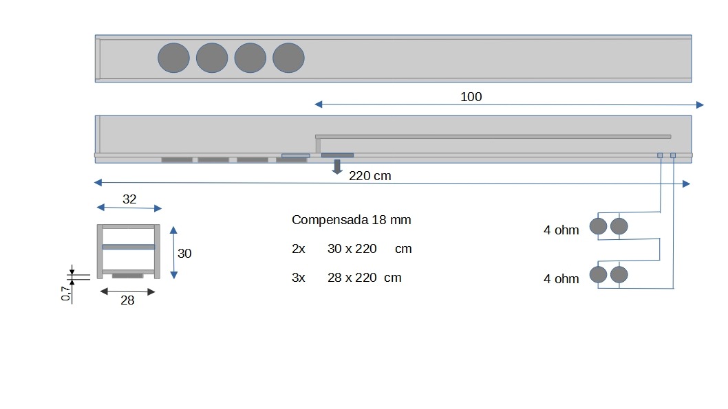

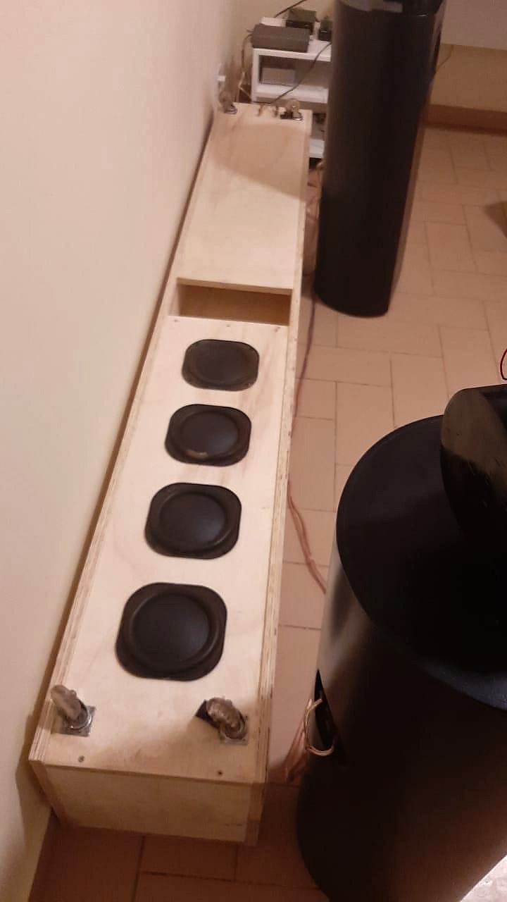

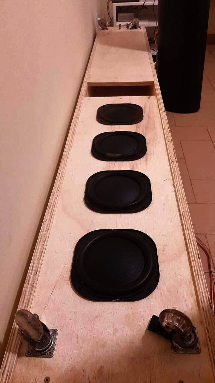

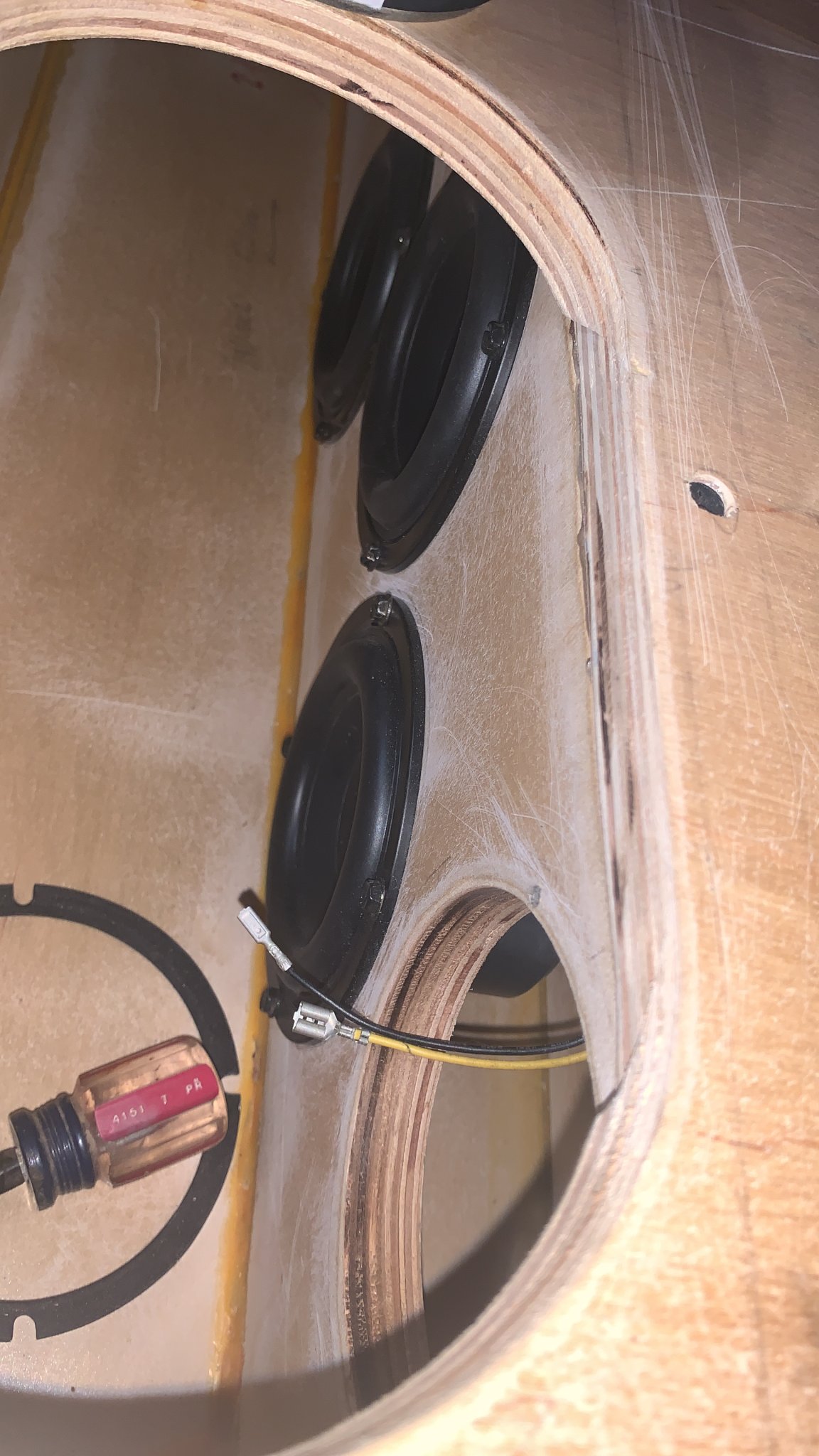

This is the RAW result without finisment, will be white satin painted. Goes down to 28 Hz with ease.. first test today with all kind of music. Best result was 35 cm from the ground, speaker units facing up, but was ugly in my room. Second best was with bass speakers down, 6 cm from the ground (on wheels). No resonces that i can hear, no booming bass, just deep room filling bass. cross over 40 Hz 12 dB.
Some pictures of my unfinished and finished subwoofer. Did some testing first on the unfinished to be sure it worked out. The TL is about 3.2 meters long, volume about 160 liters and they go down to 28 Hz and start dropping there slowly. With some EQ i can get to about 20 Hz but prefer to run them without. Sound is smooth, no booms, resonance or peaks.. and it changed the whole sound image, mid range and even high's. It's ne mold now, love it.

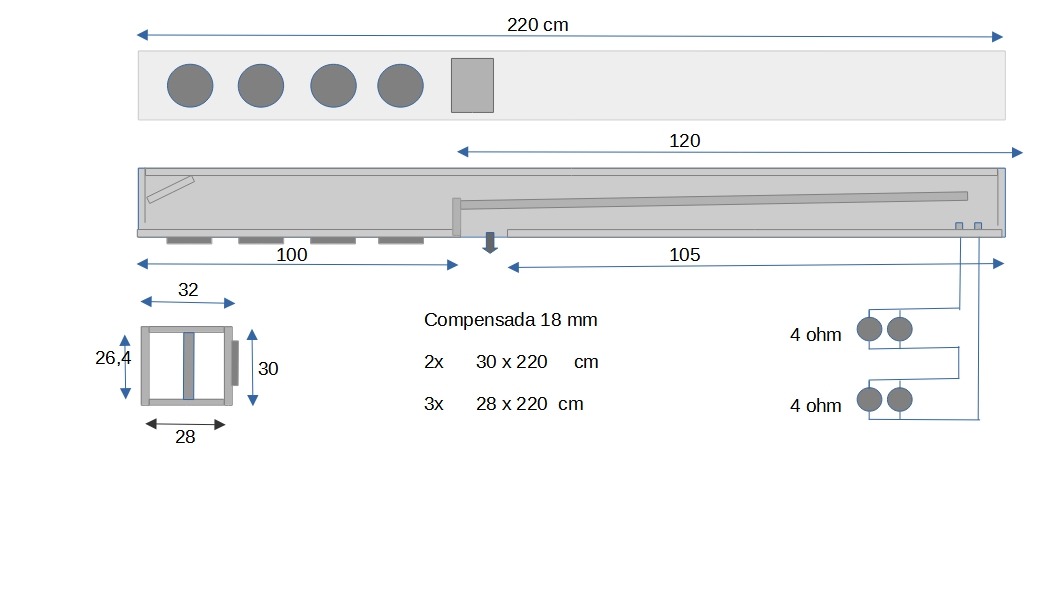

How did you wire the woofers? Two pairs in series and then the pairs in parallel?
So the box is just over 7 feet long? 220cm... Did you try it standing up? It might make an awesome pair of subwoofers standing up against the corners.

Did you provide the full BOM? It looks like it's simple enough that I could get the parts pre cut for me ( I'd do the holes for the woofers ).
it'd be awesome if you provided the final dimensions. Specially the location of the woofers and slot.

Thanks, the bass drivers are 8 ohm, they are parallel in two pairs of 4 ohm a channel. I drive them (for the time being) with a two channel 50 watt board amp in 4 ohm. The box is indeed 220 cm and a TL of 320 cm. I did not use it stading up, but thought about it like a collum in the room. I made it like a furniture, on the outside you do'n see anything related with a subwoofer and can use it as a support for TV, stereo ect, even a bank to sit on. The box construction is strong enough to hold a lot of weight. Their is no movement or vibration what so ever because it is a open construction their is no build up of energy in the box. I use it under 40 Hz so it has no "boom" or ratels. It is a easy construction and i made it in four day's included paining and sanding. Wood was pre cut and cut out of one plate 220 x 160 cm The volume behind the bass drivers has some loose stuffing.. The port of the TL has a nylon net to keep the bugs out.
(1) What are the maximum and minimum distances of the internal dividing wall that creates the slot?
(2) Why did you place the speaker terminals in that spot so far away from the drivers?

1. about 6 inch and mnimum 5 inch..
2. because my amp is on that side of the room.
metric: just devide with 2,54 15 cm : 2,54 = 5,9 inch

Thanks, but still not quite....
Looking at the side where the connectors are. Where the connectors are on the "front" and the back is the "rear" wall.
What is the distance from the slot wall to the rear wall near the connectors?
What is the distance from the slot wall to the rear wall by the port opening?
