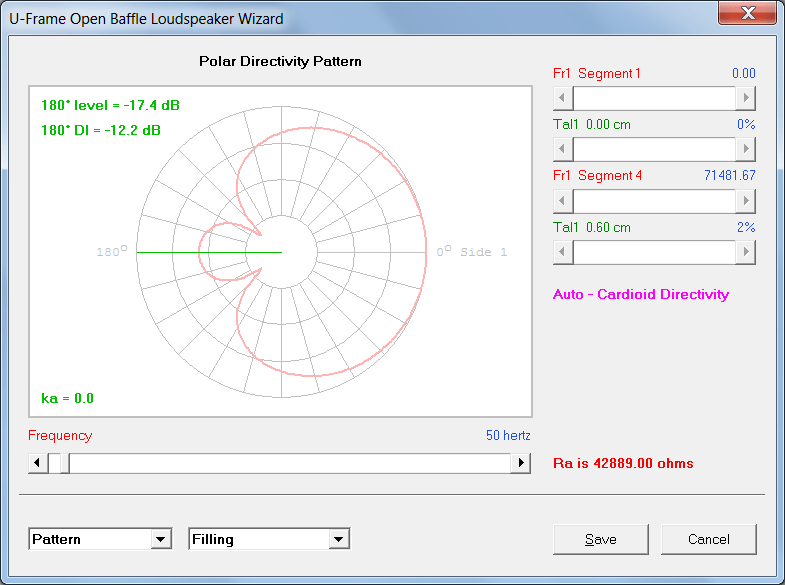

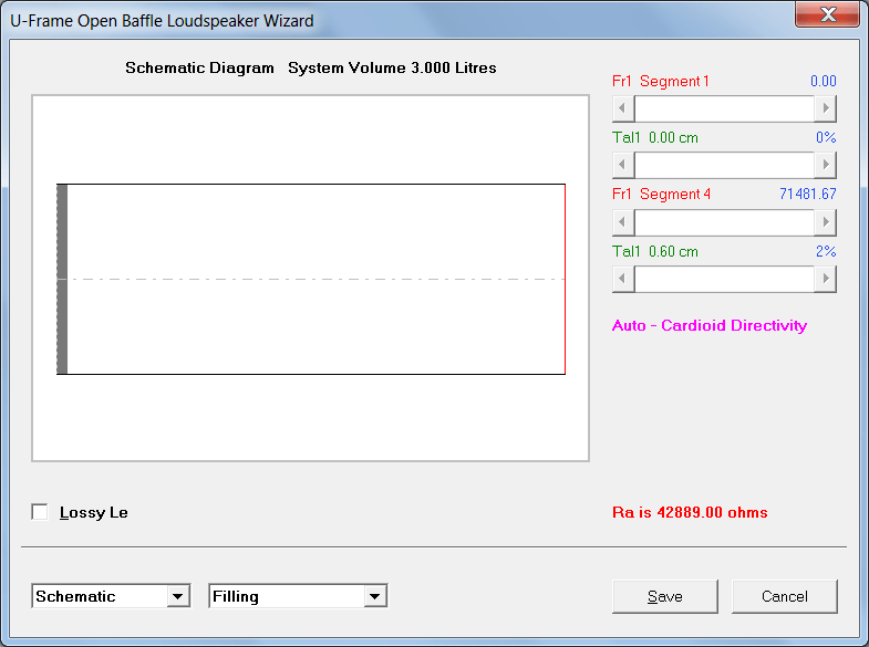

Hi GM,
There seems to be a generally-accepted theory that the multiple rectangular port slots in the Onken bass reflex design are resistive. From the examples I have seen the dimensions are such that I am not so sure that is the case.
A rectangular slot port tube and a cylindrical port tube both act primarily as acoustical inductances. The radiation impedances at the outputs will be a little different, but unless the slot has an unrealistically high aspect ratio, the two port tubes should perform in much the same way if they have the same lengths and overall cross-sectional areas.
Acoustical resistance to attenuate port output can be introduced by placing a fine-mesh screen across the outlet. In Hornresp, the mesh screen can be modelled by specifying a thin sheet of absorbent filling material having a relatively high airflow resistivity value, as demonstrated in the attached example.
Kind regards,
David

For the purposes of the simulation I see no point in adding a resistive component to the port. The transmission line itself will of course require absorbent filling material to be specified.

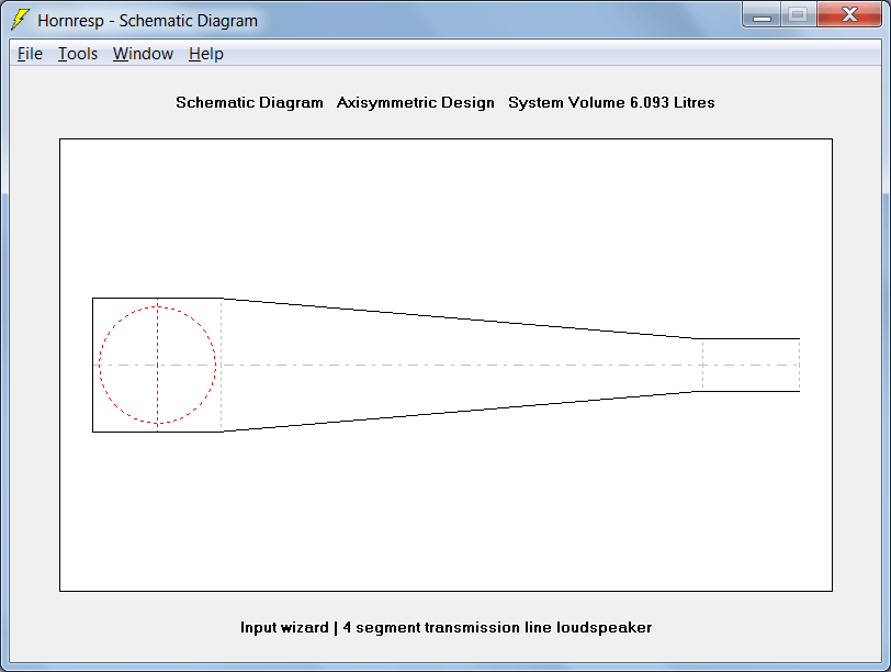

Out of interest I went looking for information on the TABAQ design and came across the audioXpress article linked below:
https://audioxpress.com/article/TABAQ-Tang-Band-Quarter-Wave
The following statement taken from the article is interesting:
"TABAQ uses the mass loading principle, in which the last part of the pipe has a smaller area than the rest of the pipe. The air in this part of the pipe adds resistance to the driver (more mass-mass loading)."
The second sentence is not strictly correct. The air in the pipe acts as an acoustic mass which adds inductive reactance to the system, not resistance. Perhaps the use of the word resistance is what is confusing some people about the nature and purpose of the port.
Reactions: wchang
