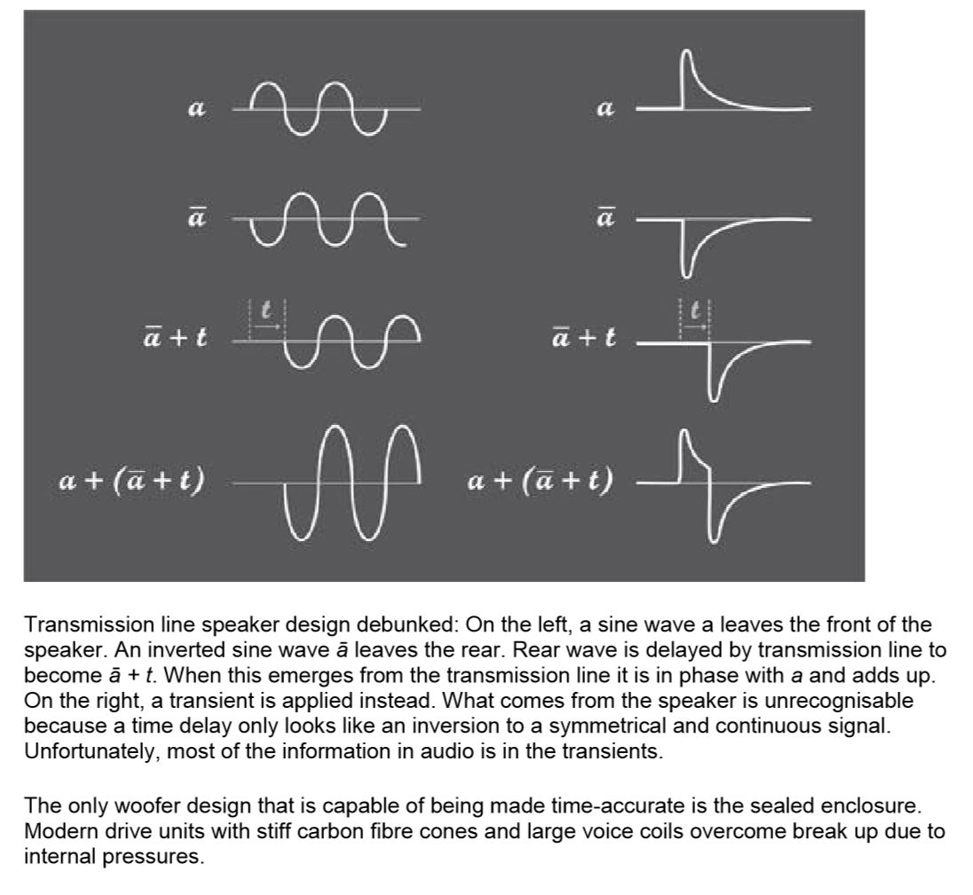

I would avoid a transmission line for close-up listening. The bass port from a T-line is delayed from the driver launch and requires at least a half wavelength(several feet) to combine.
A sealed enclosure is the only woofer design that can be made time-accurate.

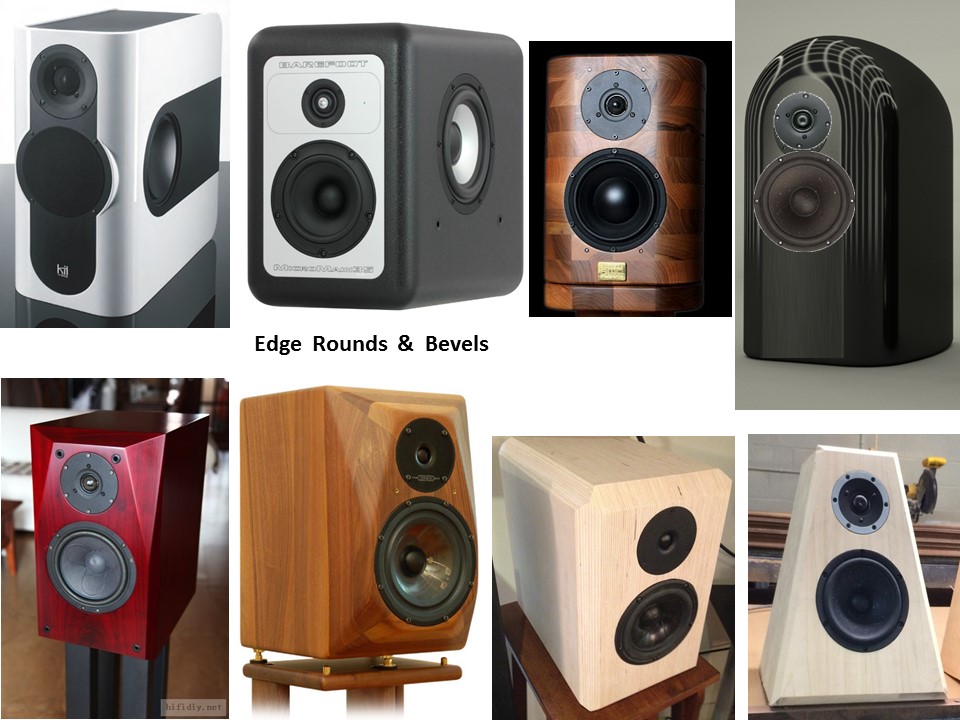

For a 2-way desktop computer speaker, you will get the best sound from a sealed midbass with bass equalization from the computer, and a small face-plate 1" dome tweeter butted against the midbass, and crossed around 1700-1800Hz. Your cabinet design should reduce edge diffraction by either cutting deep edge baffles, or machining large radius quarter round edges.

If it comes to that, it ain't just a questionable graphic, but some questionable text from the unspecified source:
'The only woofer design that is capable of being made time-accurate is the sealed enclosure'
Since when have sealed enclosures been a woofer design? And while we're on the subject, that phrase 'capable of' is also of critical [sorry, bad pun] importance, since it's not a universal constant applicable to any and all sealed enclosures. The only ones defined (and with slightly questionable accuracy) as 'transient perfect' are critically damped types with a system Qtc = 0.5: it doesn't apply to anything else. And that then goes pear-shaped in practice when any room effects (which still have some influence even in most applications described as nearfield), unless you account for those in the alignment too. In truth, very few designs are in practice transient perfect, including the majority that people call such or believe to be, and not everybody is bothered anyway, providing it's kept within reasonable limits. There is a reason why vented box variations, QW / TLs etc. are popular. Several, in fact.
