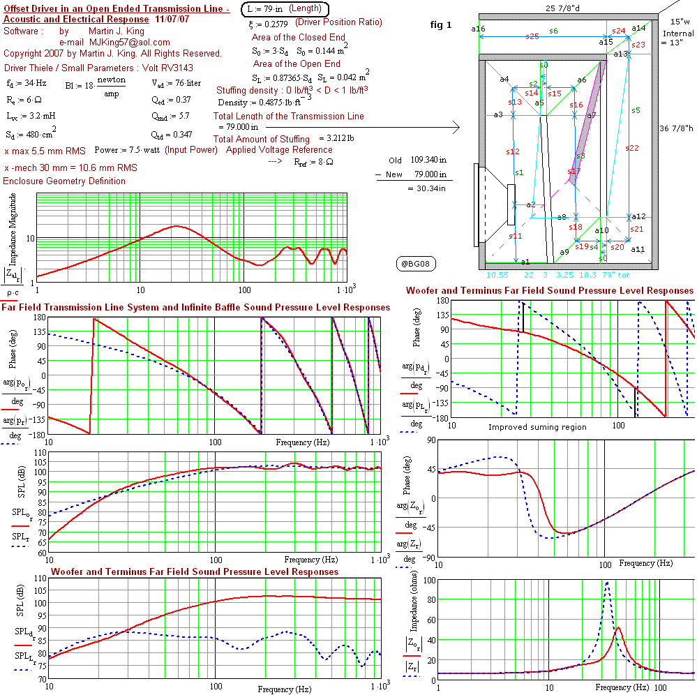

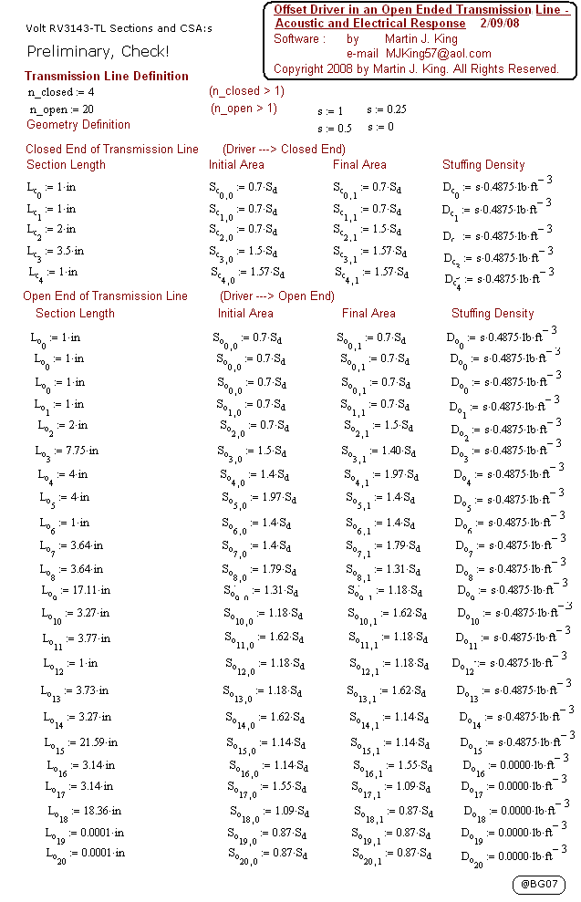

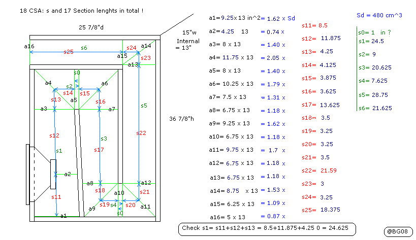

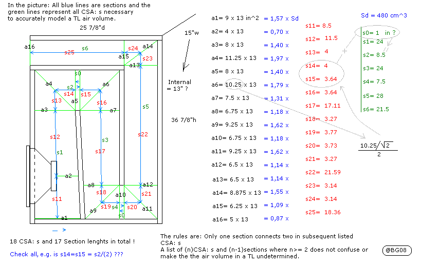

hi B,thanks for getting back,i have drew up some more accurate #'s.......the exit line slopes...here we go
a-1---9.25 s-11---8.50 s-0---1
2------4.25 12---11.875 1---24.50
3------8 13---4.25 2---9
4------11.75 14---4.125 3---20.625
5------8 15---3.875 4---7.625
6------10.25 16---3.625 5---28.75
7------7.5 17---13.625 6---21.625
8------6.75 18---3.50
9------9.25 19---3.25
10-----6.75 20---3.25
11----9.75 21---3.50
12----6.75 22---25.75
13----6.75 23---3
14----8.75 24---3.25
15----6 25---18.375
16----5
i left .5"around the exit opening for some foam cover(??),some where to glue to. these should be closer,thanks again for your help,i learn more every day
john

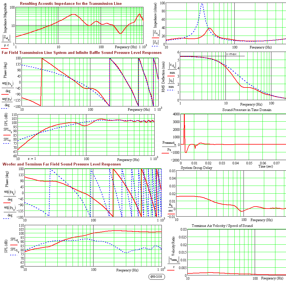

hi b ,thank you for this help. but i am not sure what all that means???????????
is there room for improvements,the graphs need a little explanation for me if you can please,
my prototype does not go as low as the PMC IB1,i do know it all takes time ...one step at a time i say. look forward to your response as always.....i may have been off by a tiny bit here and there but they are very very close.
i chose a bigger box design because i know the volt 3143 is not a modified pmc version,may be i should have stuck with the pmc dimensions????
do you think i can get this design i created to dig down low(20-25hz at 100 db) and still be accurate.????
thanks john

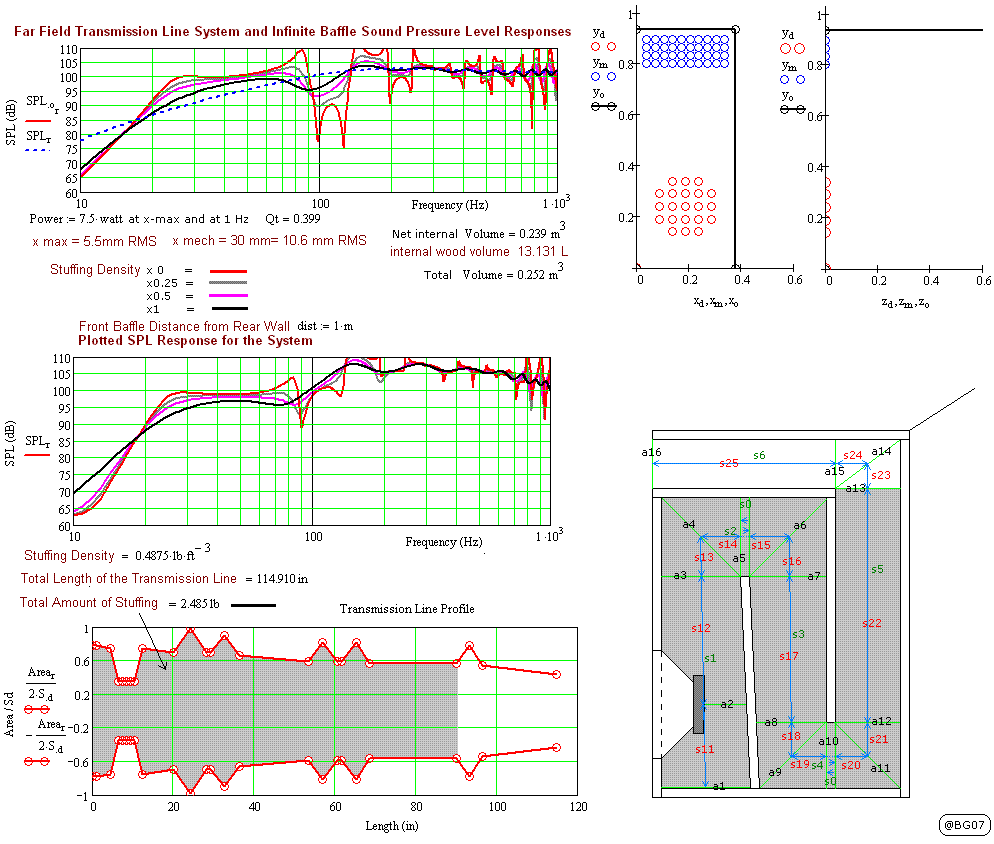

Yes you can but with an IB sloping Fr curve I find more desirable than one with a flat FR.
Hi John,

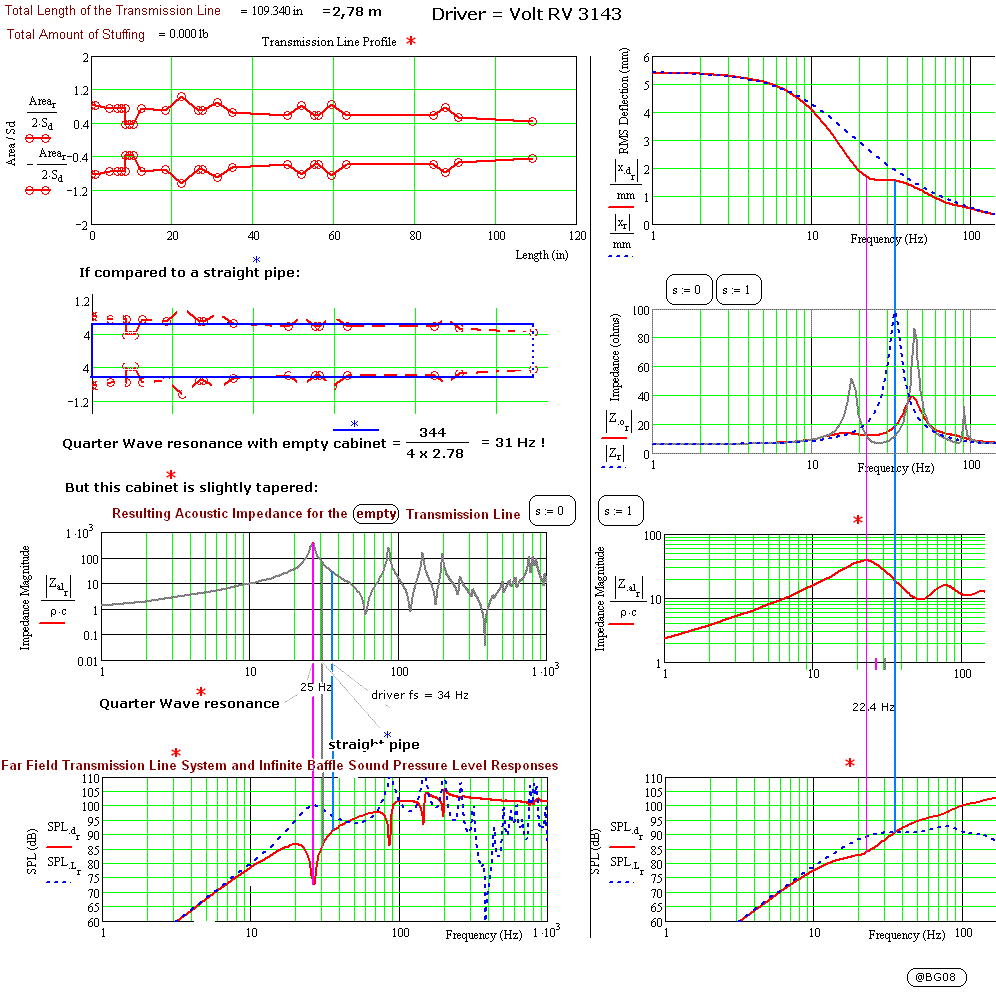

In my latest posted simulations besides the equivalent resulting very low Qt value, I especially noticed the TL length of 109.34” that I find somewhat too long.
This length is equivalent to a straight quarter-wave pipe at a resonance of 31 Hz, empty with no stuffing.
The driver fs of 34 Hz can be considered to be near quarter wave matched for this empty straight pipe.
When this pipe is tapered, the tuning of the empty cabinet results in a quarter wave frequency that is lower i.e. 25 Hz and when filled with stuffing material (typical density around 0.5 lb/sq ft), tunes the cabinet even further lower, in this case to the very low frequency of 22.4 Hz.
Using this woofer in a cabinet volume of 237 L (= 3.1 x Vas) results into an equivalent Qt = 0.4(driver equivalent f-3 dB= 82 Hz, fc at 39 Hz) and the tuning at 22.4 Hz is very low for a TL using a driver with fs= 34 Hz.
By the way, the driver maximum-ported volume is recommended to be 110 L/ tuning at about 25 Hz (Qt = 0.455/ driver f-3dB = 78 Hz and fc = 44 Hz).

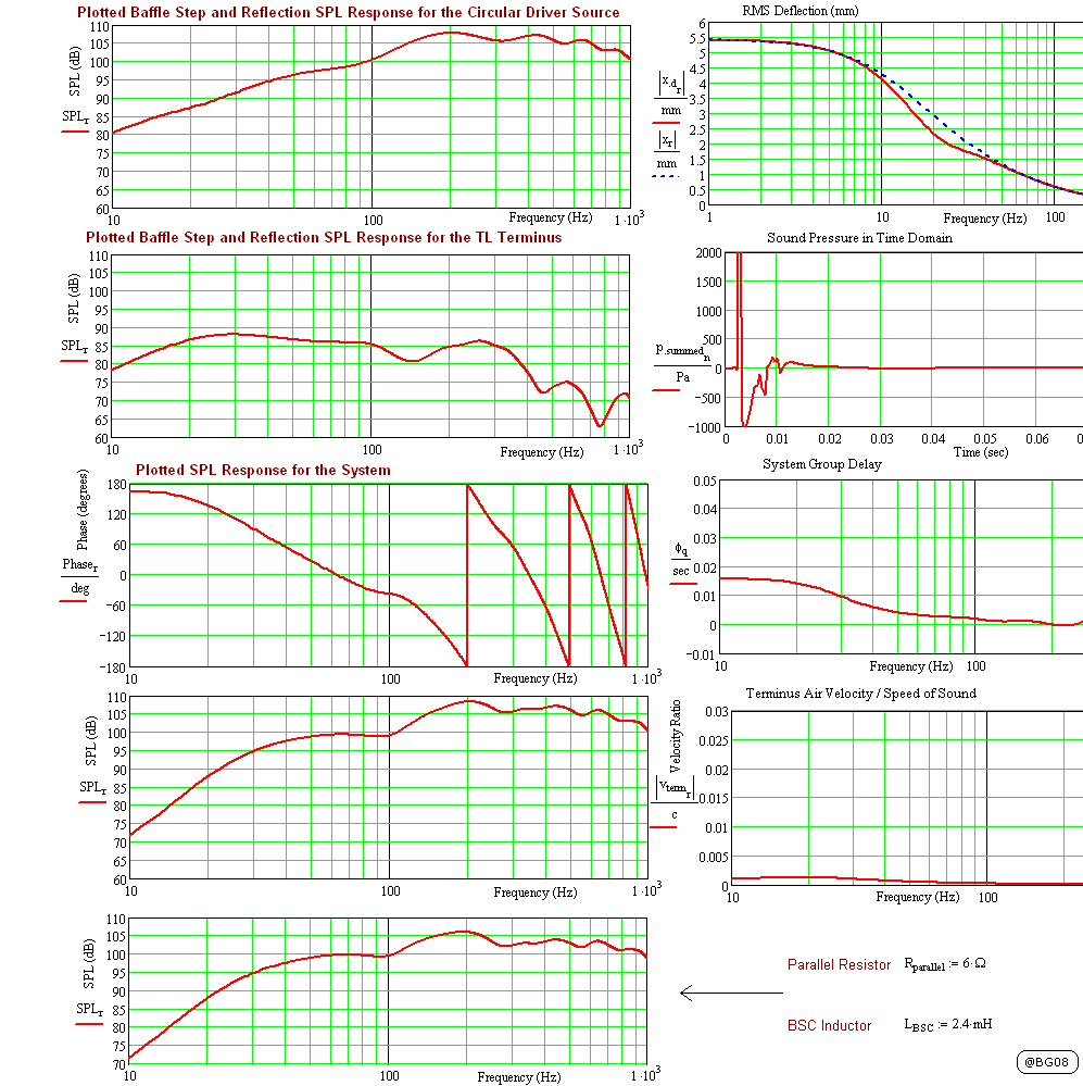

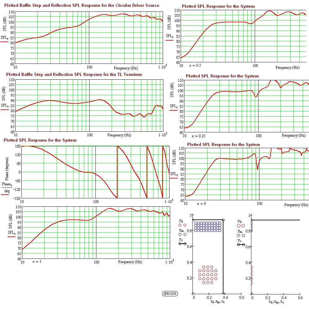

The result of this very low tuning can be seen at ‘ Woofer and Terminus Far Field Sound Pressure Level Responses’ in the previous picture: 3-Volt RV 3143-TL-cont1_rev1 where the contribution from the terminus is low due to the restricted and narrow tapering, not to forget the many bends that acts as lossy low pass filters. You can’t ask for more with this type of multi bend folded TL.
In the corresponding phase plot, above the SPL plot, you may notice how the terminus is summed to the driver SPL*.
When the phase difference is < = 90 degrees the terminus sums to the driver constructively.
For this case the in band is within about 75 Hz down to 23 Hz at a pivot frequency of about 47 Hz where the phase difference is 0 (correlated) and sum linearly i.e. 94dB(driver) + 91dB(terminus) = about 97 dB.
At the quadrature points the sum is less and can be seen to be: at 23 Hz where the terminus is at 85 dB and the driver at 90 dB gives the sum = about 91.7 dB.
The upper limit is at 75 Hz where the terminus is 92.7dB and the driver at 97.7dB which sums to about 98.5 dB. All of this gives a FR slope of about 6 dB/octave.
*//Lp =((10^(94/20) +10^(91/20) = 10^(4.7)+ 10^(4.505) =10^(4.914) which is in dB SPL =20x log (10^(4.914)) = 98.29 dB SPL as seen in the summed SPL plot.
To sum the driver and terminus at the quadrature points (90 degree phase difference) the following equation can be used:
Lp (dB SPL) = 20 x log (sqrt (10^(SPL (a)/20)+ 10^(SPL (b)/20) +2 x (10^(SPL (a)/20) x 10^(SPL (b)/20)) x (cos (the phase difference between a and b)); cos 90 degrees = 1 reduces this equation to
Lp (dB SPL) = 20 x log (sqrt (10^(SPL (a)/20)+ 10^(SPL (b)/20) +2 x (10^(SPL (a)/20) x 10^(SPL (b)/20))//
Above 75 Hz within about an octave the sum of terminus and driver SPL: s is counteracting each other and results in the dip centred at about 93 Hz.
In the practice this Sub will be placed at the floor, near a wall and when adding the baffle step, diffraction and wall-floor mirroring effects, a flat response (shelf like) up to about 90 Hz can be achieved with an f-3dB of 25 Hz at an in band level of about 98.5 dB maximum, x-max protected at 1 Hz.
If flat100 dB SPL is the goal at 25 Hz, then the input power must be restricted by using of an active HP filter protecting the driver from over excursion into the driver non linear x-max region together with a LP filter (sub amp) at about 80 Hz to suppress the ripple at higher frequencies or redesign to a shorter TL that have far less ripple and smother FR.
About 106 dB is achievable with an input power of 45 W equipped with an active12 dB/octave HP filter at 20 Hz.

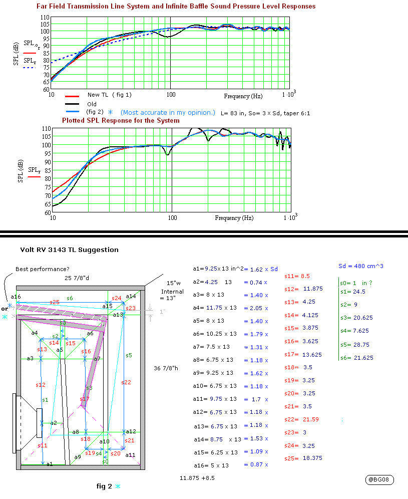

Look at the submitted pictures where the TL taper is increased and the length is shortened (fig 1), in my opinion, with performance that is more accurate that can be further improved if the layout in (fig 2) is used.
I suggest: Back to the drawing board and rework the internals of your cabinets, to a shorter folded layout where the terminus is 13” x (2.5”-2 7/8”).

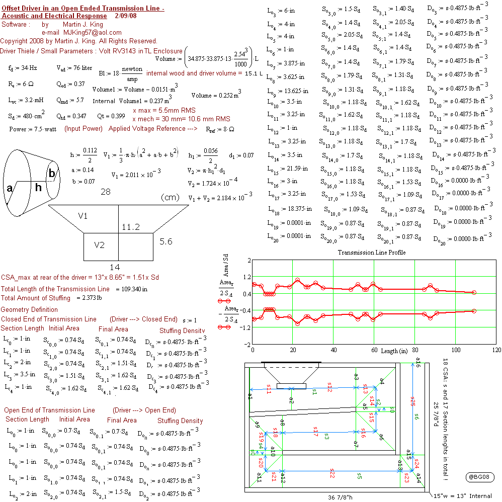

hi B,thanks for your response,i will reduce a few dimensions to around 113 liters....my pics will not go through..let me get the box built and i will return...thanks
p.s. how do you come up with the internal brace lengths and position??
thanks john
thanks john
Hi John,
113 L is a perfect volume to use with the RV3143 and I would try a MLTL design placing the T driver at ear height in a narrow (width) design.
If folding a TL I always try to avoid 180-degree bends if possible or restrict to include at most one.
The easiest method to layout a folded Tl is to layout (plot) the TL un-folded on a piece of paper, then by using a pair of scissors cut out at all the CSA: s that is connected with a straight section line, i.e. to form a puzzle of (sometimes) many pieces and then put together in the way that suits a compact cabinet.
b
