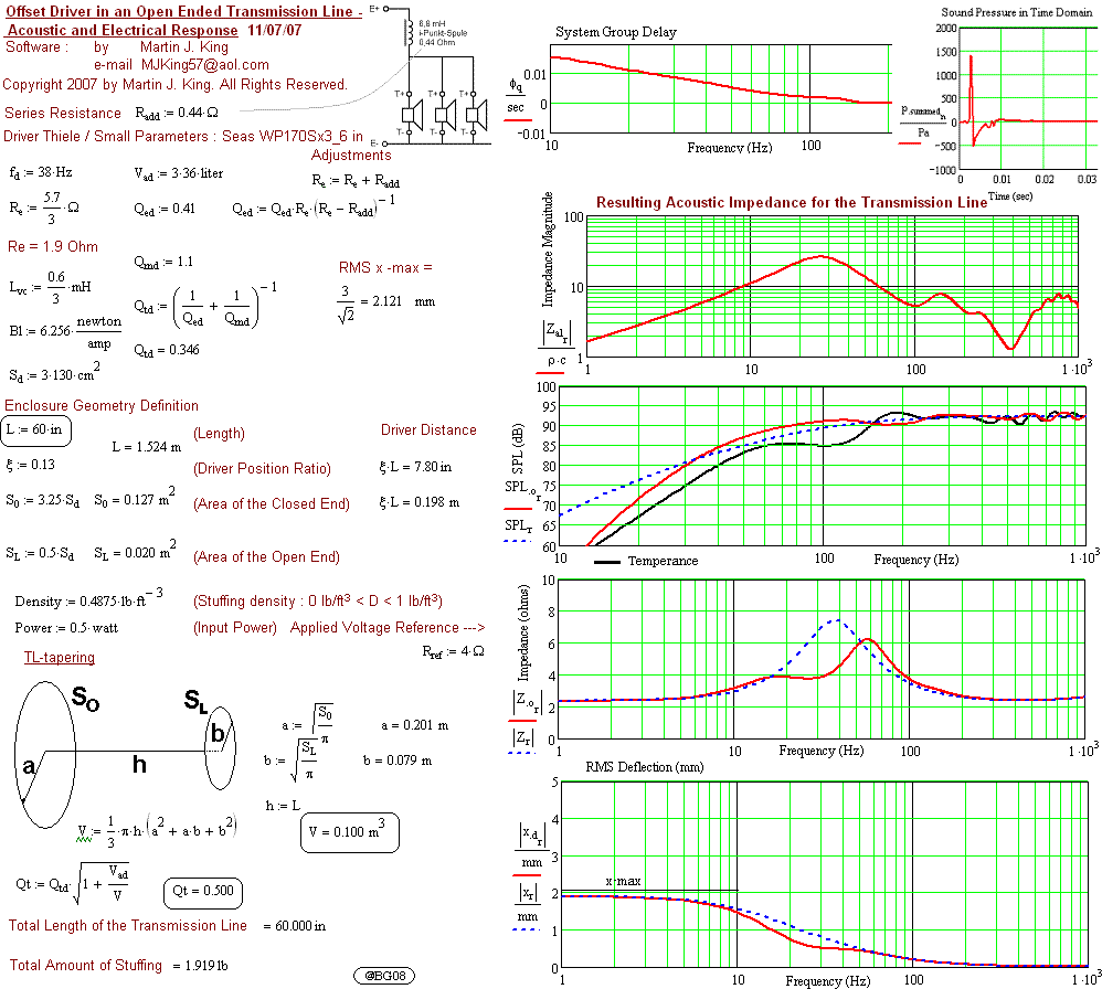

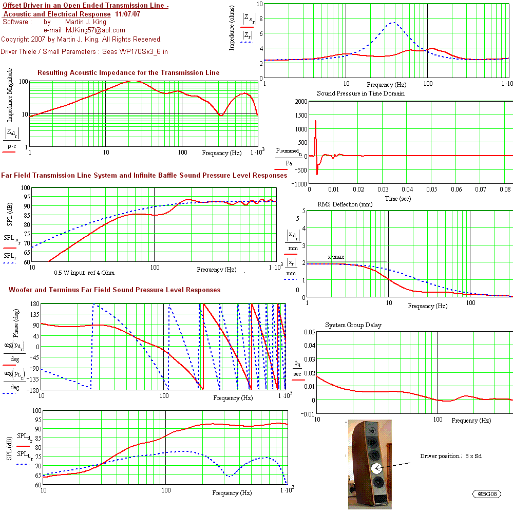

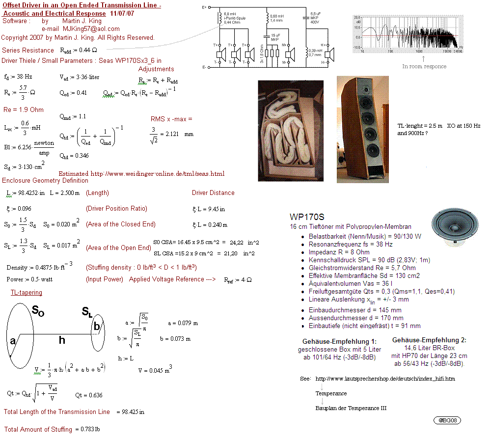

..For example. This box below uses 3 woofers in the same transmission line and that line surely isn't 3 x the normal CSA…
Agree with that but again, IMO, it’s not a good design either, look at the following simulations: picture 1(3)-3(3).

FYI:
Note: In the pictures: 1(3() = 1-temperance_seas.gif and 3(3) = 3-3x seas.gif the calculated Qt values are 0.636 respective 0.5 and are based on only one driver sensing the simulated TL volume if the box is closed.
If based on 3 drivers the corresponding Qt values will be: 0.987 respective 0.714.
