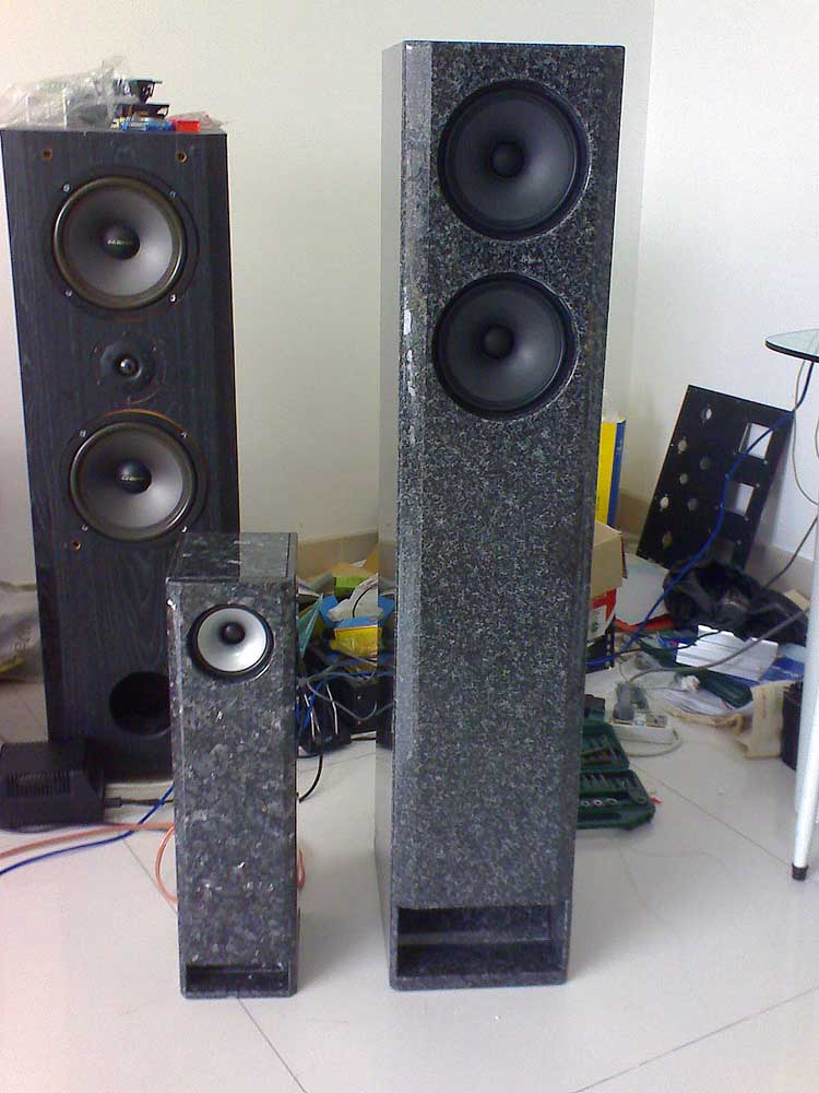

Transmissionline trouble
Dear forum members,
I am in a bit of a pickle right now, ive made a pair of massive granite transmissionline speakers that look Great but sound shitty...
i wonder why, im using 2 fullrange drivers on one housing a double folded transmissionline tuned at the driver's Resonance frequency, 42 Hz. but it still sounds very un linear ( big differences in bass response at around 50 to 300 HZ.
Im not going to contunue to use these cheapy tannoy clones as they simply do not sound good, nyther in high response as in low response.
i would like to change them for fostex drivers or somthing suitable that is not crazy expensive.
i do really like the looking of my housing, and will be making a new housing from granite. i like the concept of having 2X 6.5" drivers it makes the housing not too wide and slender.
can anyone help me with the math on this? im a total retard in mathematics, i need somone to help me learn the right way of designing, ive read the king's methode with his match calc software but i dont think i can manage this on my own and as i have just finished one beautifully useless speaker... i want to be sure THIS time
Thanks in advance
Arjen Helder

Granite TML Photo
Here is a photo of the housing, i also made a 4" one, that one sounds really good for 10 Euro per pair! ( tannoy clone drivers )
the housings are made in my friends factory where i have spend the last weekend with the workers making the panels myself.
Oh im tired right now. im glad that its not my daily job.
