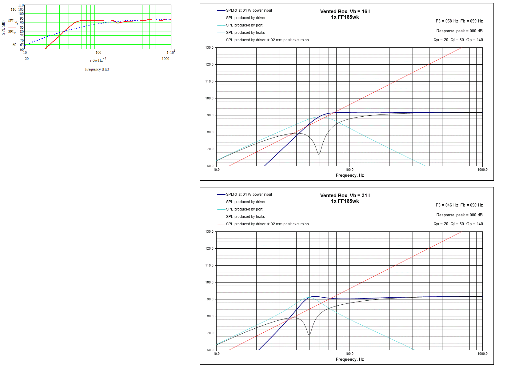

Very quick & dirty comparison attached. Driver is the Fostex FF165wk. Left hand graph from Martin King's MLTL MathCAD sheet of an MLTL -I haven't refined it, because I can't be bothered, but optimising driver location & damping will kill the minor response ripple caused by the pipe harmonics. On the right, FRs from Unibox; upper the usual nominal 4th order flat alignment, the lower assuming the same Vb and Fb as the MLTL.

Thanks, Scott. I tried, and couldn't get a BR to go down that low without a -2dB shelf. Very interesting....Very quick & dirty comparison attached. Driver is the Fostex FF165wk....
