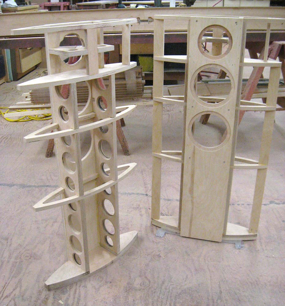

A lot of time went into these (mostly by chris):
But alot of the work was reused. The curved bit was also used to make a set of curved back Pensil7.3 (before they were veneered and finished.

Most definitely no problems related to bracing. In the areas of most concern the cabinet is very thick and sounded by sand filled voids. They are also made of moisture resistant HDF. They must weigh More than 100lbs each.
So brute force instead of finesse. With the sand filled thick walls the brace sare probably doing little.
dave

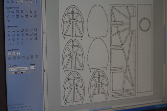

Just to be clear, neither of the designs Dave posted photos of were translams. While CNC routing was used to machine a few curved rib components, the curved panels were all vacuum bag formed rubber ply - very rigid when laminated 3 layers thick with yellow carpenters glue (Titebond 2, or Dural equivalent, IIRC). Even if we could have convinced ourselves of the merit of wasting that much material on a proof of. Inception build, the CNC time on the commercial machine at work would have cost dearly.

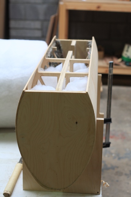

Whilst there's no denying translam builds can be expensive in terms of wasted material (although not necessarily so as Wesayso has demonstrated), they are an attractive option for anyone wanting to build a curved cabinet without access to tools or the required skills.
One of our customers has just built one which is featured on out blog. From his description, it passed all the skilled part to the CNC shop, leaving him with a set of components which resulted in a Lego-like build.

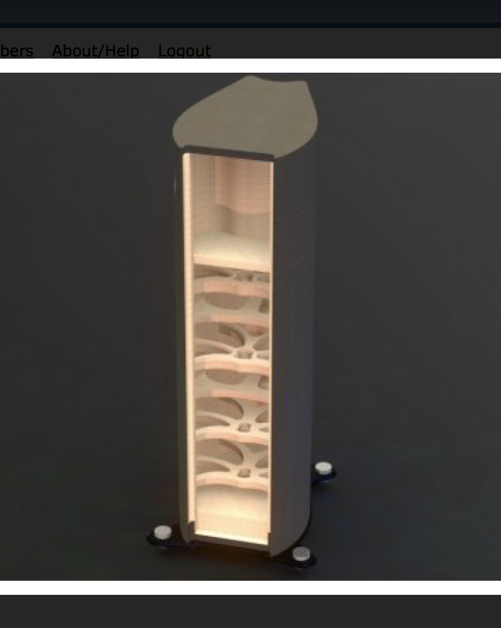

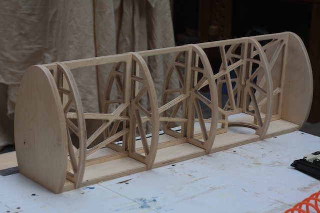

Very nice job Timbre. The insides of the curved Pensil7s Chris built may have been similar, here is the skeleton for the Ellipsa which used the same curved panels, but front & back.

A question regarding the last two posts rather than the translam approach - sorry.
I'm contemplating a curved cabinet build and plan to have an internal structure not dissimilar to that used in the pictures on the last couple of posts - do I need to increase the internal volume to compensate for the volume of the internal structure?
Of course. Any calculated box volume must have volume taken up by the drivers, port and bracing added on top.
Yes.
