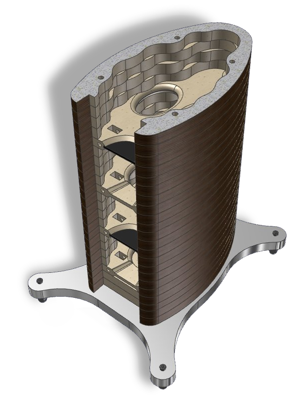

I've build two stacks of 2.25 meter high. The difference between both stacks was 1 mm. I had to exchange one of the sheets which was one mm off spec.
I'm not too worried about the environmental aspect, as these stacks were the only speaker build I did and I will stick with it 🙂. I bet Scottmoose and planet10 have used up way more sheets in total than I have used for my build.

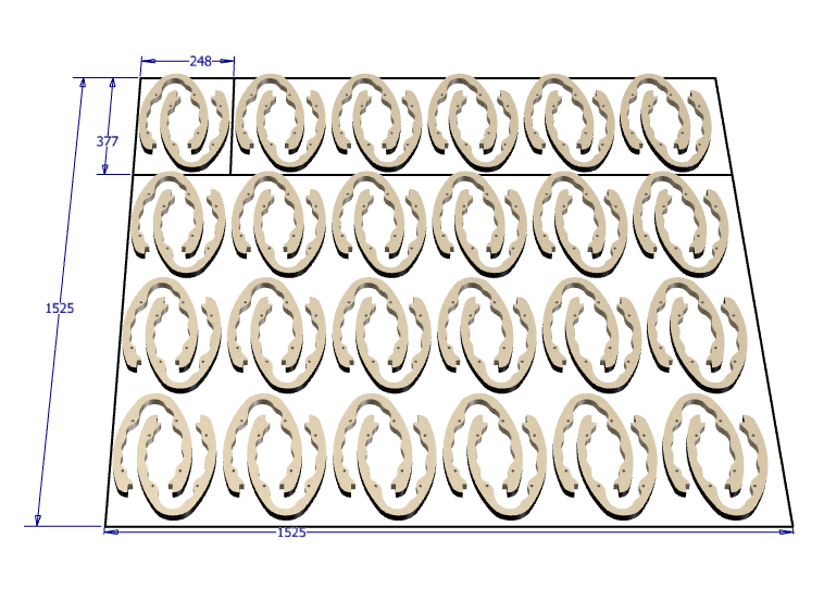

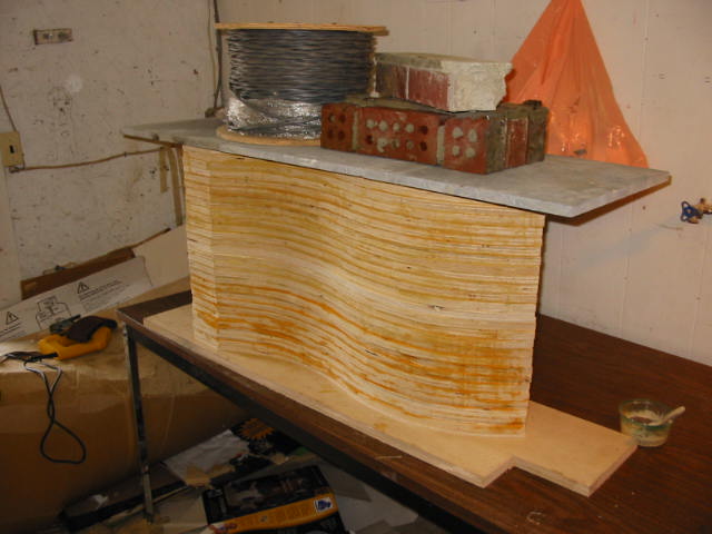

The shape I used was interlocking, meaning less wasted material.
attachment.php
The reason I chose to build it that way is it was the easiest way I envisioned to get the outer shape as I wanted it.
attachment.php

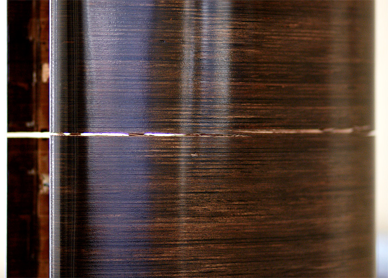

However, a stack as tall as I made it, isn't without drawbacks. Wood will continue to expand/extract and for a birch ply panel, the thickness is the one most varying under different circumstances. Meaning if you have a large changes in humidity, things will start to move. With my stacks this led to severe cracking.
attachment.php

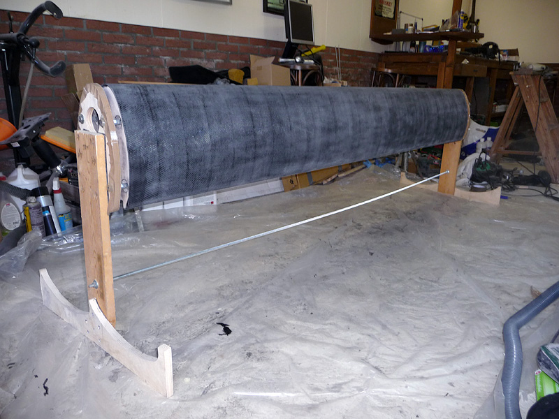

I had long threaded rods inside the stack, the idea was to use those threaded rods to put pressure on the stack to prevent this movement from ever happening, the stack was sealed inside and out with coats of polyurethane lacquer. Nothing is going to stop the wood from moving though. It will expand/contract and find a way to do it.
I don't think the rods I used were the reason for the cracks, as I've seen many samples of other stacked constructions crack, that didn't have that type of construction. It's just that wood will always move, one way or another, something has got to give.

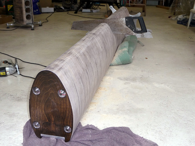

I fixed my broken stacks by dividing them into smaller segments;
attachment.php
filling the voids with a compressible material and covering the whole sequence of smaller stacks with fiberglass matt and epoxy. I chose epoxy because that doesn't shrink when curing, unlike polyester.
attachment.php
They have been in use ever since I finished them at the end of 2014, and I haven't felt the urge to build other speakers/enclosures, so even though I may have used more raw material in this build, I saved a huge pile of material as I did not need any follow up builds of different shape or sizes. For me this was a one time deal. I'd do it again, but slightly different 😉.

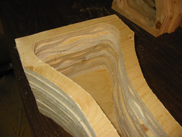

Do note that the orientation — and that they are each a translam piece — means that the bracing is largely ineffective as bracing (it should to be separate pieces running longitudinally to be effective — they could well help suppress the quarer wave resonance. The wavey insides are of such small size that they are near negligable too (small enuff that damping should deal with the same frequencies). Doesn’t hurt thou.
