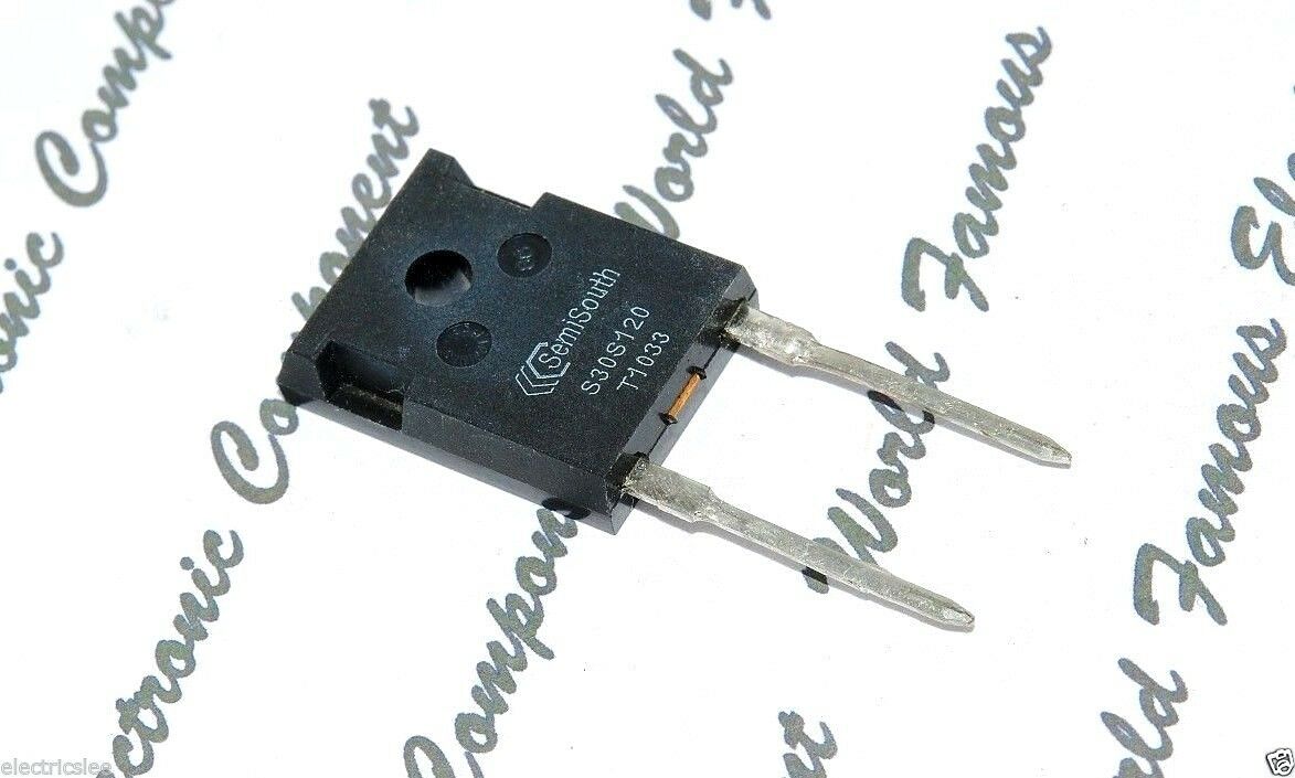

transistors with two legs?

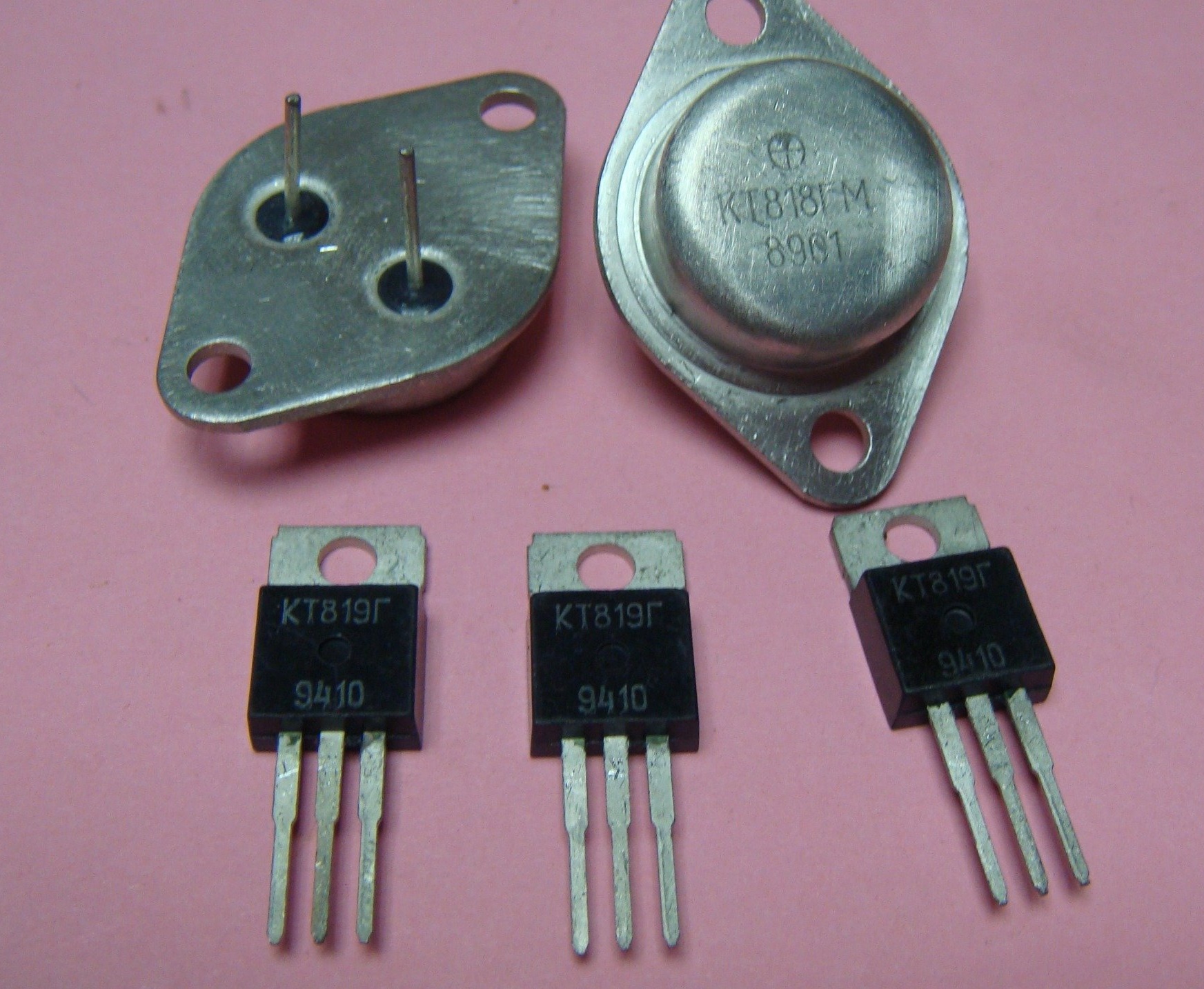

You used to be able to get TO-220’s with the leads formed to fit TO-66 sockets - with the collector lead missing. Probably the old TO-218 too, but I’ve never had any that way. I’ve actually seen the lead formed TO-220’s installed in equipment that I’ve serviced.
