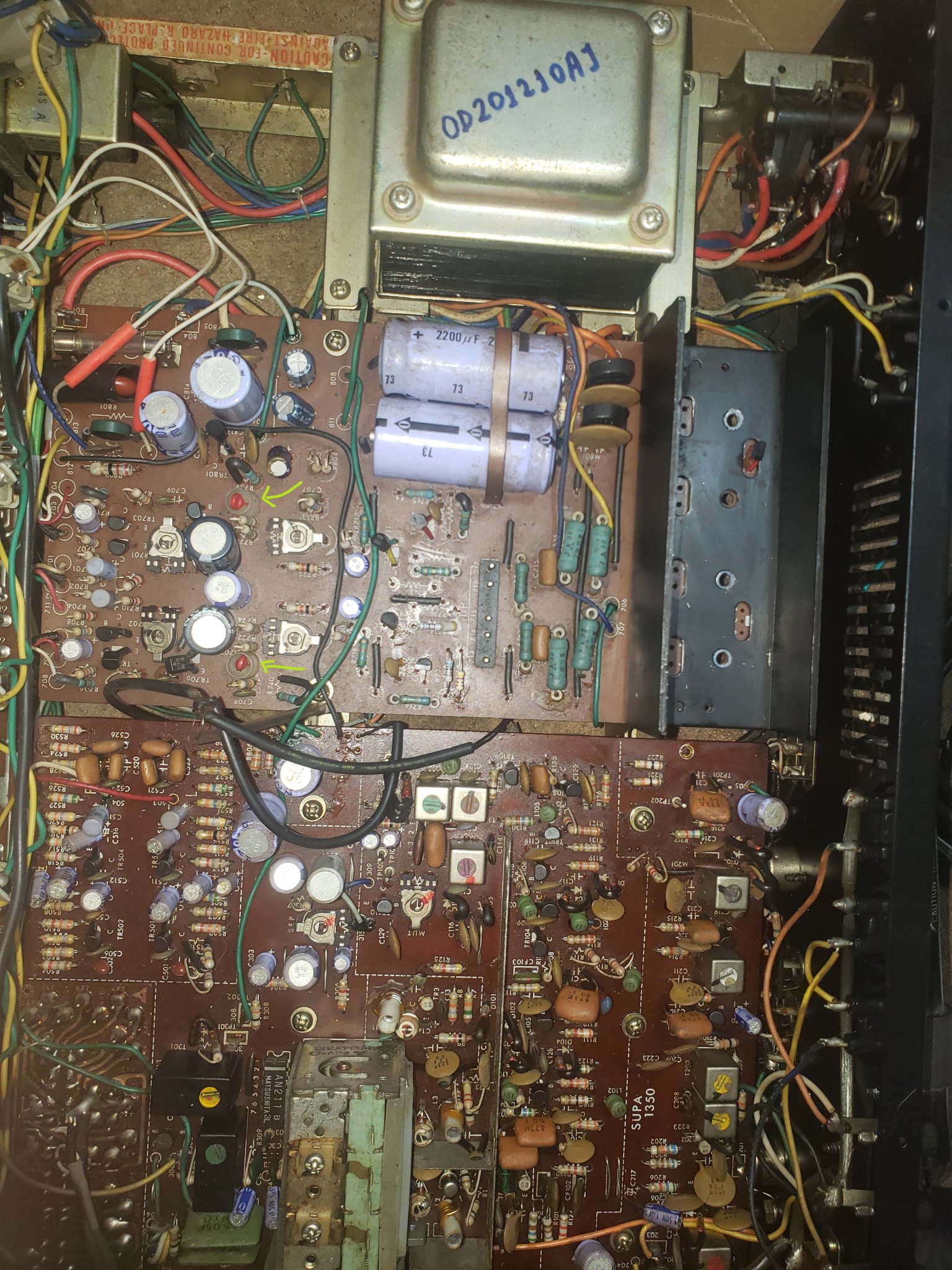

It also looks like TH701 and 702 are thermistors that control the bias devices tr707/8. They are small- black?
2 lead resistors that need to be on the heatsink with a little white compound.

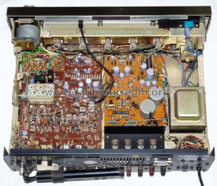

Cute little amp !
Reactions: Bobrepairs
Cute little amp !
Usually when a vbe multiplier transistor AND A thermistor are used, the transistor goes on the heat sink and the thermistor does not.

They are not on the heatsink, only the 4 power amplifiers, and the TR707,708 are. Those thermistors I think it's the ones I marked on this picture I took.
Normally, those TO-92’s are mounted to the heat sink. It’s possible that as low power as this is, it’s good enough with them near the heat sink - it just won’t generate a ton of heat to compensate for. About 6 watts per power transistor worst case average, with real world about half that. It will warm up, but not burn your hand hot.
I see that BC and E are labeled on the board. Good news if you’re subbing parts because there are actually FOUR possible pin arrangements for those little TO-92’s. ECB (normal for jap), BCE (some early Jap types, if they have the ring around the bottom), EBC (JEDEC), and CBE (EU types). TO-220’s are at least consistent -they ALL go BCE.

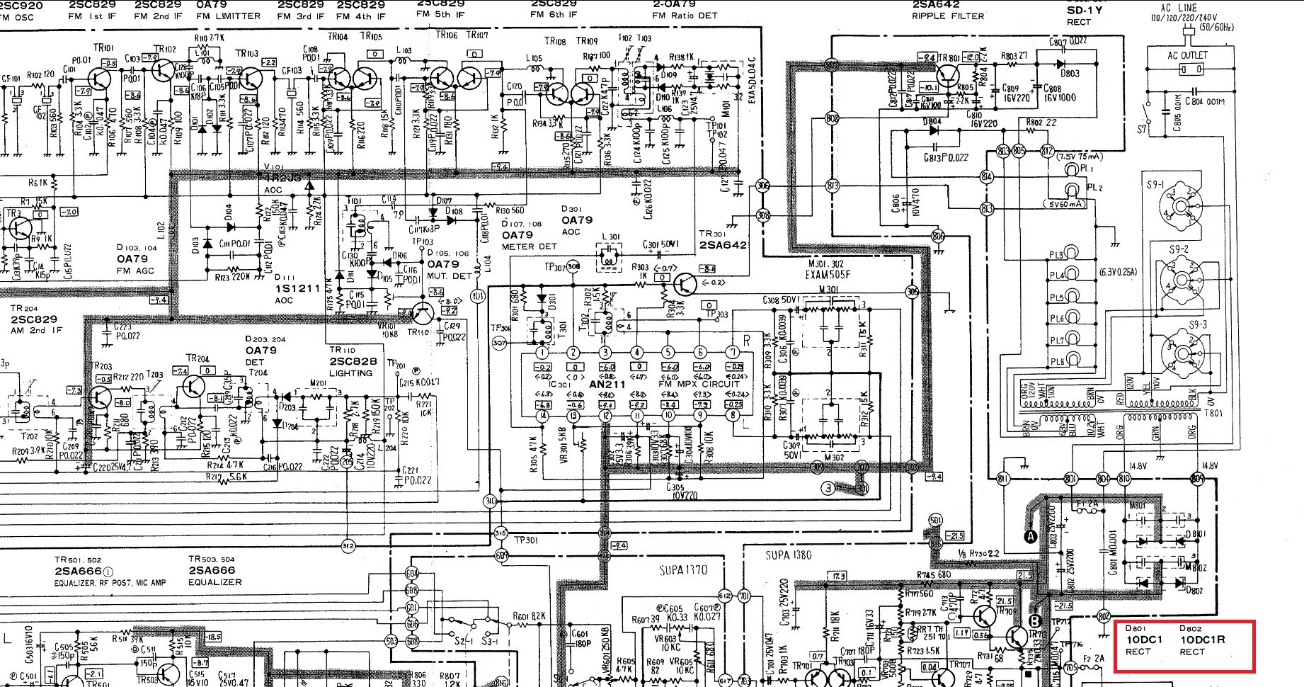

Well guys I finally had the time and replaced everything, the thing now is, I powered the thing on with a 100W bulb in series, and the bulb lit up at full brightness, no signs of life in the receiver, I could feel a burnt smell being released on the bridge rectifier, one of the dual diodes is bad(D801) with one of the legs loose and reading random values on the DMM , the other(D802)looks fine measuring (0.589~0.590V) on both directions, what could caused this guy to go bad? Should I replace both of them?
Also I couldn't find any datasheet about it, what could be a replacement for them?
The Diodes are marked with a red box on the schematics below.

The original failure (likely shorted output transistors) probably took out the bridge rectifier from too much current draw. I’d replace both of those obsolete dual diodes with a single 4-legged bridge rectifier. It only needs to be 4 or 6 amps, but a 10 amp may not be any physically larger. 100 volts is enough, 200 is common, 600 is overkill but won’t hurt anything. Four 3 amp single diodes (ie 1N540x) but they tend to have leads that are too fat to fit in many PCBs. They use the leads to conduct the heat out. Bridge rectifiers (the 4 legged variety) usually have a mounting hole to put a heat sink on if you pull enough current to warm it up. 1 amp (or 1.5 amp) diodes may be enough but I wouldn’t if I was designing it. The DC current draw will hit about 2 amps at full volume and I’d prefer to have some margin.
Not sure a 4 legged would fit there, there's 2 dual capacitors between them, 4 of the IN4007's wouldn't work here? I have a few around, also have the IN5404, but as you said they're too fat to fit.
