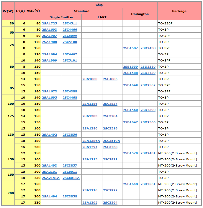

- Transistors recommended for new designs
