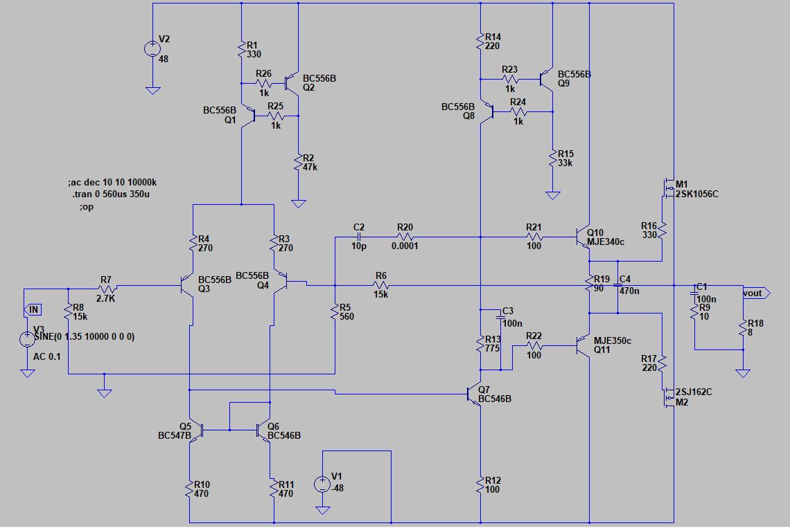

agrees with Mark, the VAS duty is quite a lot for one transistor to handle alone. It is not a valve. Far better results can be obtained by using low Vce device with high Hfe for the current gain to reduce load on IPS, driving a common base stage with high Vce for voltage gain. Current gain device sees a constant Vce, greatly linearizing Ai. Also, common base can reduce the effects of the Early voltage.🙂. Try to use low Cob device for CCS as this will be driven by the voltage gain collector.
not sure how to impliment this suggestion, i have attached the ltspice cct.
Q12 is at 0.8 caused by Q13 when vas-current is =>6mA (iq13 is a current protection circuit for q12). And there is no voltage setpoint properly defined between Q3 and Q5, driving Q12 to max current (q13 in protection). Or it could have stuck to the minusrail.
Q7 at such level that Q12 stays out of ohmic region independend of load or Q7 output voltage swing. 2.2 is a bit low.

In one design I was looking at, ASTX, uses a green LED as the bias V across the 2T VAS cascode. iirc a Yamaha design grounded the base of the cascode. Bob Cordell shows a green led & a 1N4148 in his fig 3.12
I think you are better off using ksa992 or 2n5401 in the IPS. All 3 have different pin outs 🙂 unless you cascode the bc556c 🙂 lots of options.
If you can afford it, Bob Cordell's book covers these design techniques.
