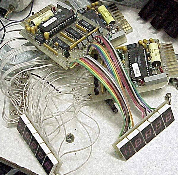

First the simple part: the meters. 2 volt 4.5 digit red LED, with ultra-hifi custom wire extension (used to be at right angles to each other)
The plan is to mount these stacked on top of each other, and if noise from one to the next proves a problem (have to check after construction) then Mu-metal shielding can go between each board.

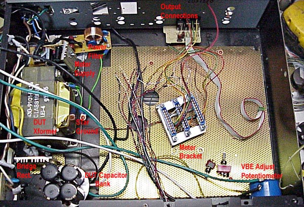

Chassis layout. Power is all on the left and can be separately shielded as required. Bridge rectifier has its own heatsink. The meter supply used to be a self-contained brick. Matching heasink came from same extrusion as the bridge's. Bracket holding the supply used to be the heasink on the output switch (! ). Capacitor bank is held together by the copper rings like I said before; it looks at a glance to be floating.
Caps came from the amp that used to be in this chassis
Transformer came from an old Nicolette oscilloscope
The display bracket needs to be mounted, it's just loose in there right now.
The Bourns 4W wirewound pot was just laying around here @ work, as was the power supply for the meters
The gold-colored mesh came from a Diebold Automatic Teller Machine IIRC
Power input filter came from a Dell server PSU

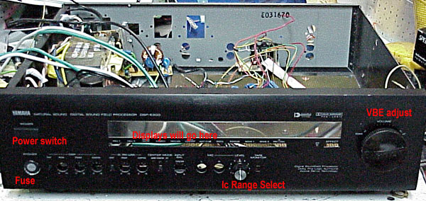

Front panel layout. Controls will mostly be along the bottom in a row. Displays should be lined up side-by-side. Power switch came with the chassis and switches only the hot side, then straight to the fuse. I'm not too worried about switching the neutral because of american wiring codes (neutral=earth at circuit breaker box) and the fact that polarity is inherently fixed in the type of power cord it'll be using (IEC standard plug, like everything else these days), which replaced the built-in 2-conductor power cable. The clear panel used to show all the cool features of the amplifier in this chassis. I sanded it down to about 600 grit, if that's not enough diffusion I'll get it to 400 or 220.
The fuse holder sits flush with the front panel, and came from an old HP DVM
The VBE adjust knob is from a Whitey pneumatic valve.
Range select switch came from a Tylan vacuum gage display, a nice Greyhill 6p2t
Displays are all working now. One was missing a digit so I un-rewired it. A different digit was out. Re-rewired it properly and all the digits were there. Meter boards bracket is mounted, partially wired in, sense resistors are mounted, partially wired in. Sanded the clear panel to 40 grit for a little bit of diffuser action, it's good enough.
Need to come up with some buffers. I didn't realize until last night that I was trying to compare a voltage with a +17VDC offset, and the meters need a max. 5VDC offset referenced to ground... no direct readings there.

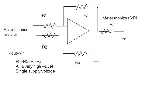

How about this: a difference amplifier (FET opamp) driving a resistor to ground, or a calibrated resistive voltage divider if necessary...

Moderate success. I rigged up a quick difference amplifier and plugged in an OP27. If the OP27 could swing up to V+ it would be a total victory. I need to dig through the opamps I have and see what can swing all the way up.
The tester circuit certainly works. I grabbed a random transistor and plugged it up and a base voltage of just over a volt caused a collector current of a couple of amperes.
Need to figure out how it will all work when I throw the reversing switch for doing PNP/P-ch. testing.
