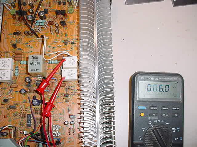

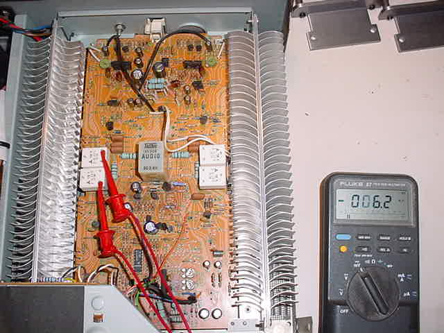

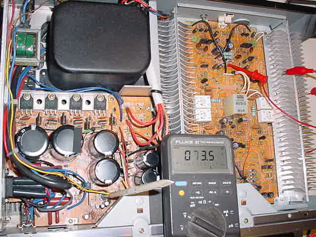

Carver M500 bias
2 photos show bias L / R measurement points (6mv). Other photo shows HV measurement point (74v), plastic trimmer is resting on SVR503 (HV adj pot). All the elec caps were replaced within the last year, they are all still available in the same case size (or smaller).

Your elastomers need cleaning in your (very good) meter. That should make the display like new. Use 99% isopropyl alcohol on a Q-tip to clean the ends and the PCB traces.
If I recall correctly, there was a modification to reduce the temperature of those TO-92M transistors near the back. Resistor values were changed. 2SC2705 and 2SA1145? Just off the top of my head.
Those pictures bring back memories for sure.
-Chris

As per your post, Thermistors are present on the heatsinks and I measured the B+ at 80.1 volts. Installed the 50K pot and checked R 506 which measured 47K so I replaced it .Now B+ is 76.9 volts and will not adjust any lower. Question, Would the 80.1 volts activate the protection circuit and not allow the relay for the speakers to engage?

The high voltage would not prevent the relays from closing. Find the emitter resistors and measure from there to ground for each channel. A high voltage there (DC offset) would do this. Sounds like you need that service done that I mentioned earlier.
