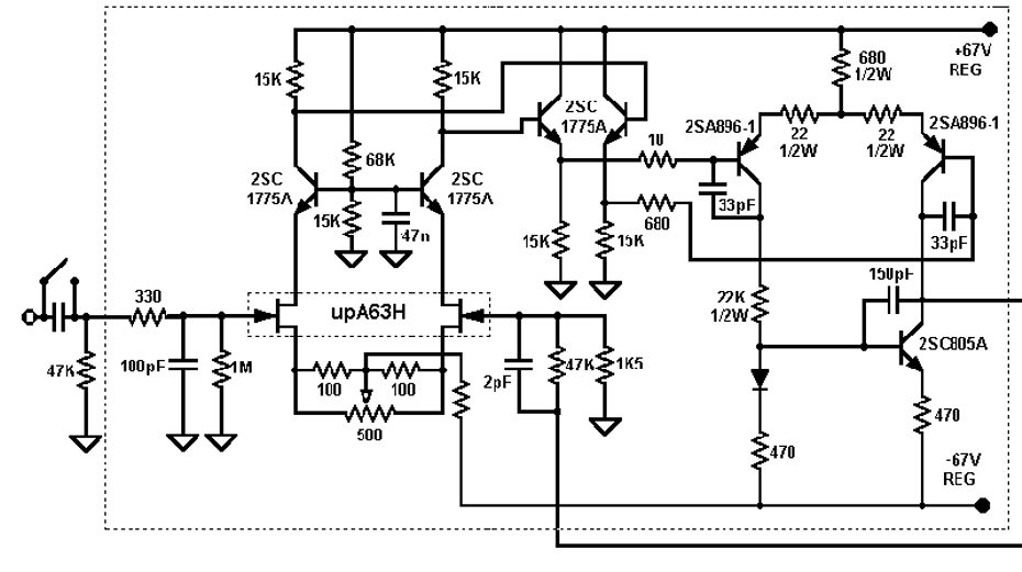

Hope you don't mind me tacking onto your old thread calmart. I'm chasing my tail on this one. I've since discovered some errors in the schematic from the 5M21 service manual. The picture attached is out of the service manual with the measurements I'm getting. First, pin 14 on the hybrid IC shows it connected to the -67V supply when in fact after removing the ic, the pin was folded over and not connected at all. Second, missing from the schematic is a 120K resistor connecting from the -67V supply to pin 5. Lastly, pin 12 is connected to no where. You can see Luxman originally had a trace leading to pin 5 but was later unconnected. The actual makeup of the IC has been posted earlier thanks to jacco. I'm since confinced my problem does not lie with the hybrid IC. Can someone help me make sense of this thing?

The different DML-01 version on the left looks to be drawn wrong, BJT symbol insted of JFET, the matched pair NEC should read uPA63H (or alternative uPA68H)
Maybe there was a bipolar version.
The 2SK60 number is wrong as well, but my head hasn't yet dropped a simular looking JFET number.

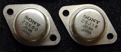

2SK60 is a power VFET, complementary of the 2SJ18, TO3 devices with a power handling of a little over 60W.
2SK50//2SK65/2SK66 are close lookalike numbers, those are JFETs, but neither of them would do.
There's one that would work, the 2SK63, but that's a really really exotic small signal VFET device and only used in very few Sony amps from the 70s.

Easy to find, but would become costly to obtain well matched duos.
Duh, why replace 250mW single JFETs by a very expensive dual 600mW ?
(a 2SK146 has 10 times higher Gm than the NEC JFET)
Much cheaper would be matched 2SK170, glued together and resin encapsulated in a DIY DML box would ensure pretty good thermal tracking.
Looks more authentic too.

After sorting out the errors in the service manual and schematic, I've finally found my problem with the pre driver stage. There were a couple of problems and unfortunately one of them is in fact the DML-01 FET hybrid IC. The odds of finding an IC are next to nil so it looks like the only other way to save this amp is to build the IC with discrete components.
If I'm not mistaken from the two different schematic versions jacco provided I could use either of the dual FETs uPA63H/uPA68H providing I can get them or I could use matched 2SK150A's. Obviously the dual FETs would save me the daunting task of matching single FETs and would be a better choice but are there any other options/suggestions?
I believe your correct and assuming the bottom two transitors are suppose to be drawn as FETs, it looks like the gates (bases) and the sources (emitters) are labelled wrong also. The left FET has the gate as pin 7 and the source pin 3. The right the gate is pin 2 and the source pin 6. Should these not be left FET gate as pin 2 and the source pin 3 while the right gate pin 7 and the source pin 6?

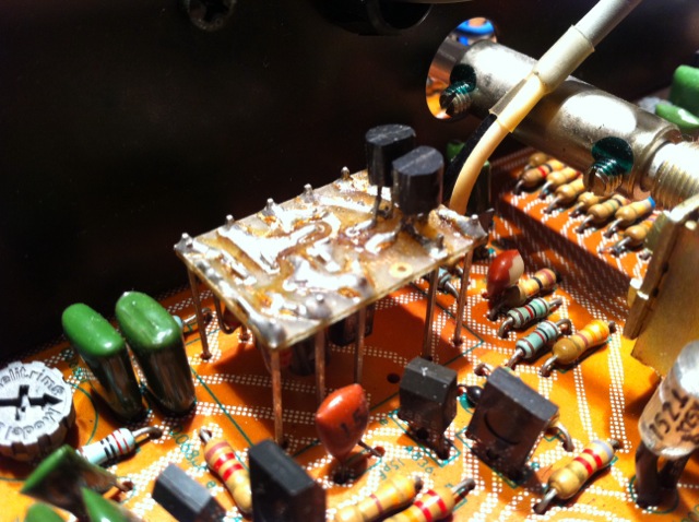

I feel your pain. I have a C-12 that needs the DML-2 IC. Interestingly, this pre-amp has already been repaired once and it has a small board labeled DML-2 built with discrete components. I have no idea who built that board but it does appear to be functional.
From a quick check with a meter, it does not appear to be the same circuit as described by the drawings referenced within this thread. I imagine I will have little choice but to desolder it and draw it. This drawing is the only DML-2 drawing I've found and it is not complete. It is missing the 5 pin which appears to be the signal out.
I probably won't get to this for a few days. If anyone has crossed this bridge since this post went dormant I'd sure appreciate hearing what you learned.
Can any of you guys post an actual picture of the hybrid with dimensions, pin spacing, etc.?
I can source most of the parts, design the PCB, match single JFETs if needed and build them.
The original part is 30mm by 20mm with 12 pins (6 to a side of course). The pin spacing is 5mm and the rows are separated by 15 mm. So the pitch is 5mm by 15mm.
The photo is of the work around someone built with discrete components. It is a slightly different circuit than the other drawings. You will note two TO-92 packaged components on top and there are four below. Only one pair are marked (C1345). It's difficult for me to say if the circuit design is any good.

You are correct about the confusion. The version I have does have six active devices. I must point out that the DML-02 "luxman circuit" that you reference has been questioned as it does not appear to use the #5 pin as the Luxman chip does. The signal-in is pin #4 and the signal-out is pin #11. I scoped the signals to get an idea of gain and I'll post that when I get back to my bench and my notes.
I looked over the work-around circuit and think it is very similar to the on-line sketch on that Luxman site, using the top six active devices and ignoring the lower two and the 3 resistors. Pin 12 is connected to pin 2 via a 22K resistor rather than the circuit as drawn. Pin 5 is connected opposite pin 9. The 64 K resistor was 47K and that agrees with the original I have desoldered. The 58K resistor measures 56.7K. I'd guess 56K as a standard value. The odd thing is that pin 1 (the 0V pin) does not appear to be in use on the work-around. I'll desolder the thing tomorrow and post a drawing and sort out the pin 1 thing.
On the original, the resistance between pin 1 and pin 12 shows 17.1K, which is a pretty close correspondence with the "luxman drawing".
My guess, and it would be just a guess, is that the work around circuit was simplified to just 6 active and 2 passive devices so that the circuit would be manageable to build on such a small card. A second guess would be that it is an inadvertent mistake that the drawing omits the 5 pin opposite the 9 pin. Both those are just intuition and we know what that is worth.
Of course you are correct about the pitch: it fits a 0.1 inch pitch predrilled card using every other hole on the length and six holes to the width.
