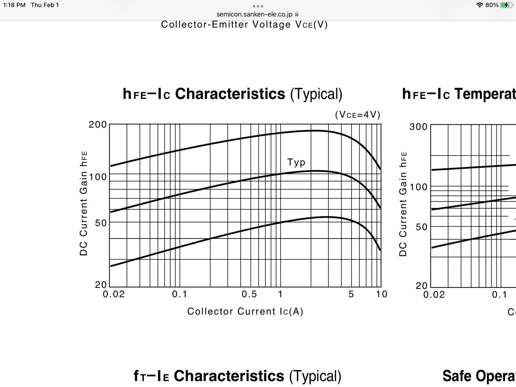

Example Sanken 2SC4468-O Per the data sheet should read from 50-100 and I'm getting Anyware between 31-38 Strange
could this be attributed not enough base collector current/Voltage.

Where would you expect it to be at 1uA of base current?
Sankens aren’t likely to get down in the single digits but 30’s seems plausible.
As a general rule these hfe-testers operate at currents in the mA range. This is fine for small signal transistors like BCxxx- but not very informative for power transistors operating in the amp range.
