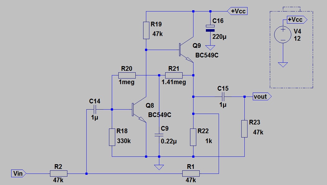

Transistor Preamplifier -part values for higher voltage rail.
Its just as bad a performer on 35 volts as on 12. All you need change is R22 to 2.2k and select a value of R 21 so that you get around 17 volts on the emitter of Q9. The value is dependent on transistor gain.
Its just an inverting buffer with poor drive ability.
I can't just think of any suitable discrete buffer tbh. The opamp is ideally suited for that circuit and a FET opamp allows direct connection of the wiper as shown. The discrete circuit has the input "floating" at whatever voltage the emitter of the second transistor is at (via those 47k's). Sonically it should be totally transparent in the centre position.
