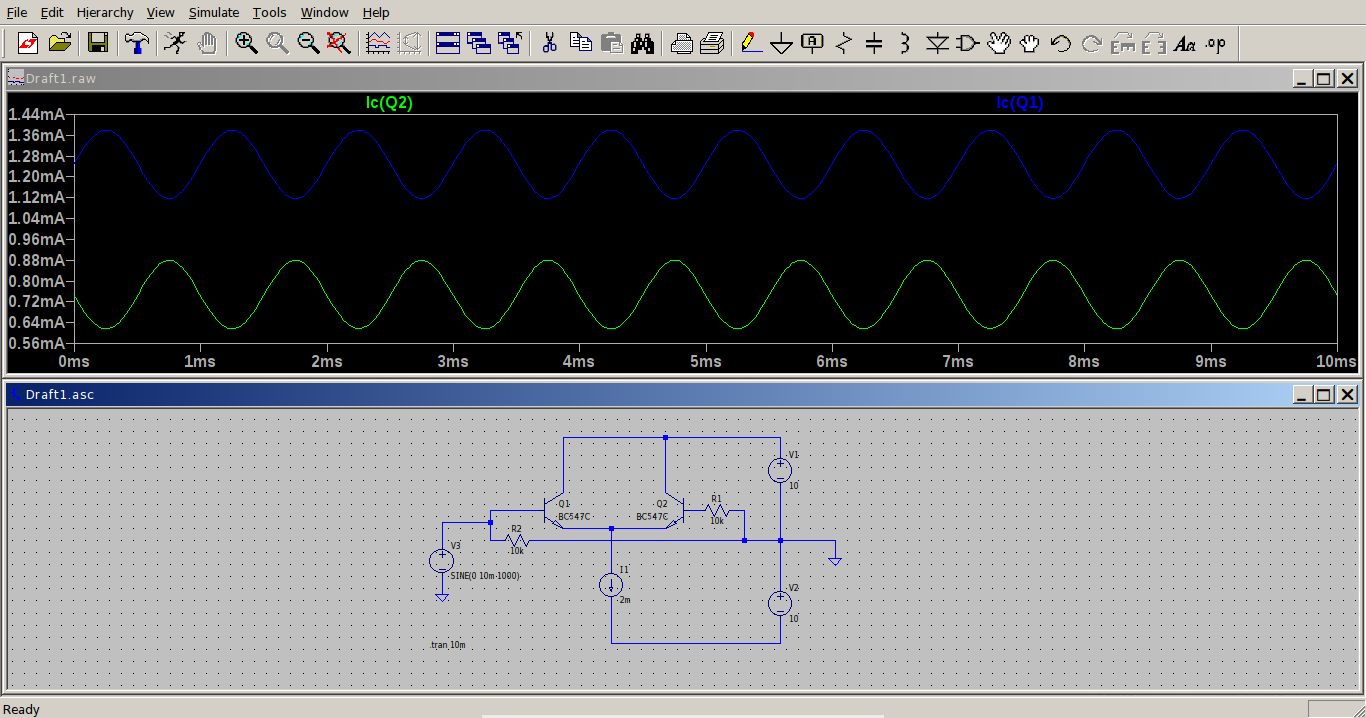

I have no (few) delusions. I know that guaranteed that it will be attacked by those who don't understand it; ~30% that real problems will be found by those who do understand it, and 5% that my efforts are of lasting value. All I did can be summarised:
1. My version of "auto-bias" is to move the crossover switching to the drivers. This makes emitter resistors unnecessary, which improves THD, and the bias does not need to be fine tuned. The bias can be fine tuned for even better THD, but then we are back to thermal problems and the need for emitter resistors. It's a great example of the reality for trade-offs.
2. Move the current limit feedback (not included in the original post) ahead of the VAS so that VAS limiting is not required. This is not new and seen in many op-amp circuits, but I did it a bit differently.
3. I did a trick with a diode in the VAS bootstrap that helps to charge the cap quicker at startup. You have to split one of the resistors to keep it from adding distortion. This is related to the:
4. Single supply split by the amp itself. Startup capacitor voltage need to be managed to avoid thumps and pumping. Simulation has to be set to NOT preset cap voltages.
5. The bootstrap divider is not 50/50. This is reduces rail sticking, but it is another trade-off since it compromises the low frequency bootstrap effectiveness.
Those of you have done some design will understand these points and we can have an intelligent discussion?
