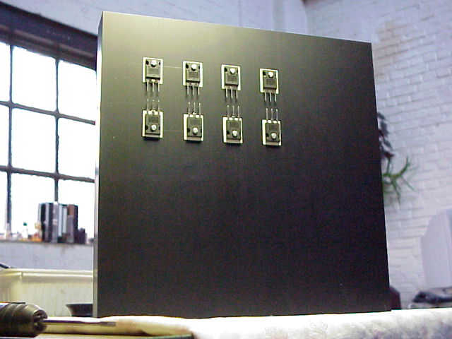

sajti said:
Top - 15% - first tr. - 70% - second tr. -15% - Bottom :scratch:
This is the way I positioned the transistors for my AlephX.
It's test running for days now, and they don't get too hot.
I used Sil-Pad2000 from Bergquist, which is fairly expensive (€ 1.85 each) but has good thermal ratings.
It will look a bit like the Peter_Daniel_prototype_setup_and_wiring.
Does the company also have a valid explanation why to put them like they explain? Could you check that? In building Aleph's the wiring would become much longer then I prefer. That’s why I made a 'group' on the top part of the sink.
/Hugo
