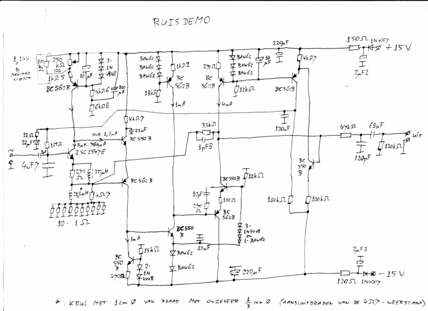

By the way, somewhere around 1994 I built a high-gain negative-feedback voltage amplifier for a noise optimization college demonstration. It had a bipolar input transistor driven from a capacitive source and you could change the collector current over a very large range. As you turned up the current, you first heard the white noise decrease and then the base shot noise filtered by the capacitive source increase. I must still have the schematic in the attic, I'll see if I can dig it up.

This is the demo circuit I wrote about in post #4. The bandwidth is limited to about 1 kHz on the lower side by the DC feedback loop and to about 40 kHz on the upper side by the output low-pass filter. The 21.5 nH inductor is a 1 cm-diameter loop made of the wires of the 4.7 ohm resistor.

Also, thanks to M. for finding and posting that interesting demo circuit. I guess it would also need modification to enable measurement of the full audio range.
caution, measuring the full audio range as a single number will be misleading. The spectral distribution won't be uniform so the LF stuff will dominate. You can use a PC spectrum/RTA to quantify the spectral distribution however. If the base/gate resistor can be switched between low (0 or 100) Ohms and high (10K and 100K Ohms) you can separate the voltage noise from the current noise. The other key elements that you would want to control/adjust are the collector/drain current and vCE or vSD since those also have a significant effect on the actual noise.
