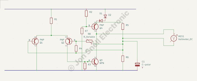

I use this basic schematic as this matches the VBe and Hfe simultaniously.
To increase the value of R8 increases the overal gain and the volt meter shows up imperfections like a dream. PNP test is shown for Q1 and Q2.
For NPN use an inverted schematic.

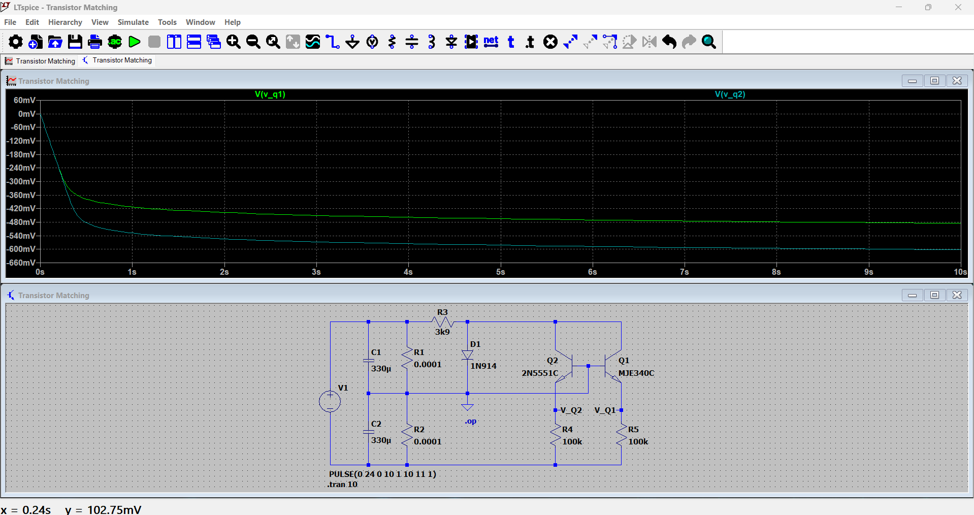

Will this work? Am I missing something?
I dunno in the real world...
Here is your simulation...
Its surprising in simulation land just how dissimilar the transistors have to be to get a mismatch. Make your simulation dynamic so you can plot the voltages.
The 24 volt supply is replaced by a 0 to 24 volt rising value. Also because it is a simulation you make your virtual ground with 1 ohm or even 0.0001 ohm resistors to get a -/+12v supply but it seems to make little difference (apart from drawing 100,000 amps).
